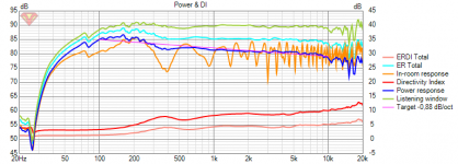

This is an MTM point source. First order XO at 250 Hz (active). The lowness of the XO also means that the 360° rotation with the 4th order passive order passive is not very noticable.

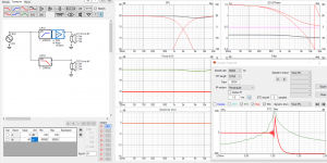

From the materials it seems that what actually counts is the distance from the acoustic centers of the midbasses and tweeters. I would like to tell shortly what design has been on my mind for some time - two fullranges and a 3/4 no flange tweeter. I am thinking about 2xPeerless 3" 830986 and e.g. Vifa OX20SC02. It is doable mechanically to place them ca. 6cm apart ( M-T centers).
What kind of problems would u see in this practical design ? Vifa would be recessed in relation to the mids so that the peak of their impulse responses is coincident. For the on-axis FR I can compensate/linearize it with custom DSP. Although I am rather sceptical as for the audibility of some FR irregularities especially in the top octave.

A subject near and dear to my heart...
I've played a lot with MTM and WMTMW arrays including the XA series at Snell (XA90, XA75, XA Reference). One thing you get with symmetrical arrays is that it forces symmetry in the polar pattern. You can achieve lobe free performance if you can get the highest crossover point to work. The ratio between element spacing and crossover point determines everything. I found the best way to reduce the "wavelengths of separation at crossover" was to use smaller mids. a typical 5" or 6 1/2" pair of mids will be too far apart. What you really need is a pair of 2 to 3" diameter drivers and then a dome tweeter with good low frequency response and very short overall dimensions. It turns out once you can get the highest transition to work (dome to smaller mids) then the lower transitions (in, say, a WMTMW form) have no spacing challenges. You can even space units out.
I did a series of simulations of systems with 3, 4 or 5 ways and you can take a "log periodic" approach (like the antenna) and achieve fully lobe free constant directivity over a wide range. This means that each section can have the same number of Octaves bandwidth and should be set to a length in proportion to the center frequency (the Log Periodic part).
I have also played with post mounted coaxes. These were made mostly as inwall or ceiling speakers (designed for Snell then PSB). The typical tweeter on a post has very crappy response, primarily from tweeter reflections off of the cone behind. I found that if the tweeter was built into a directional flare (I used a 2 slope approximation to a JBL CD profile) that the tweeter directivity increased to the point where it wasn't reflecting off the cone and had very nice response. The larger flare didn't seem to effect the woofer response so it was a win-win.
A good coax with a pair of mids around it, possibly using the same cone assemblies as the coax unit, could be made to be lobe free. As always, the trick with coaxes is getting smooth enough response (which was always the UniQ or Tannoy challenge).
