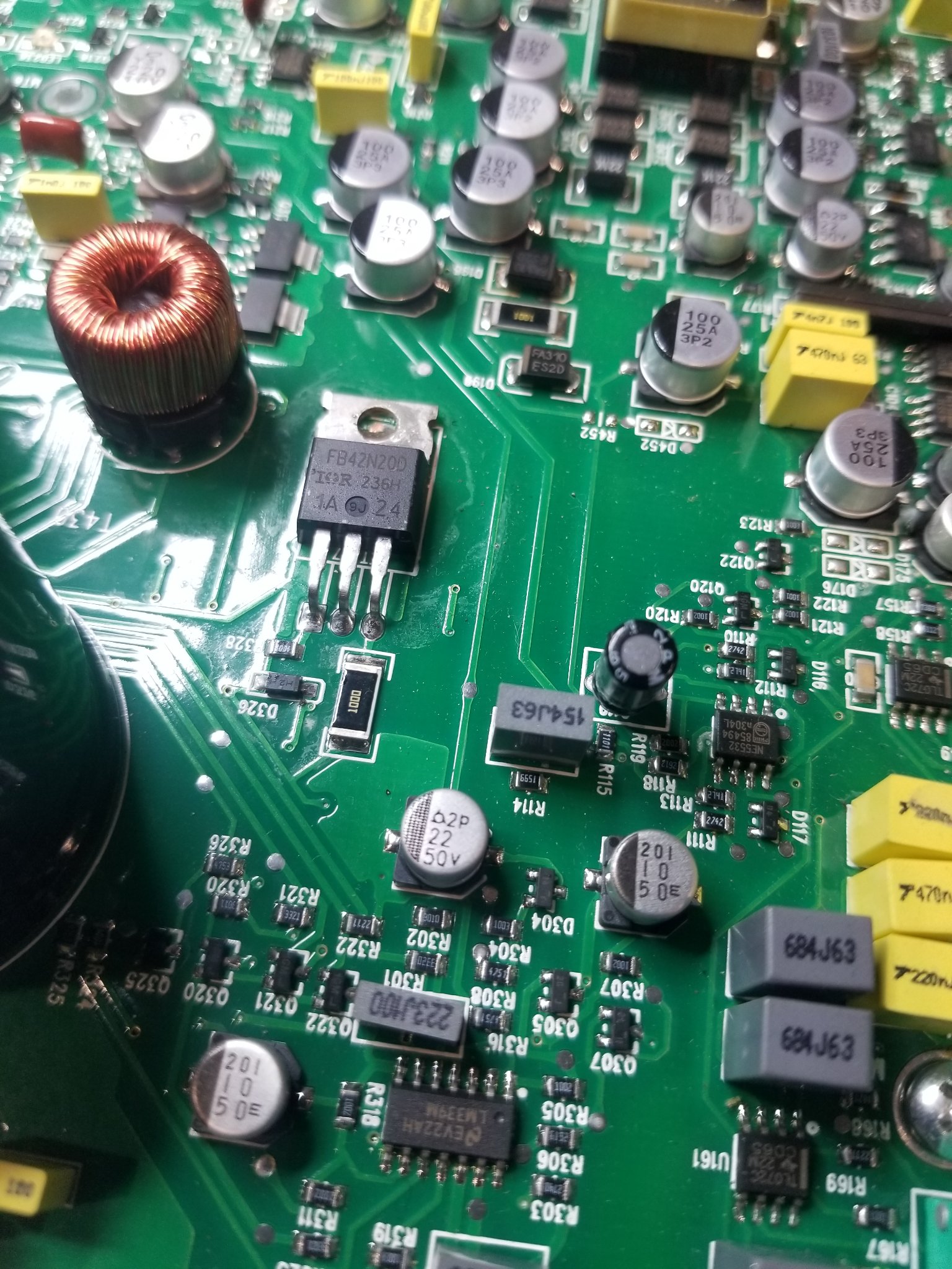

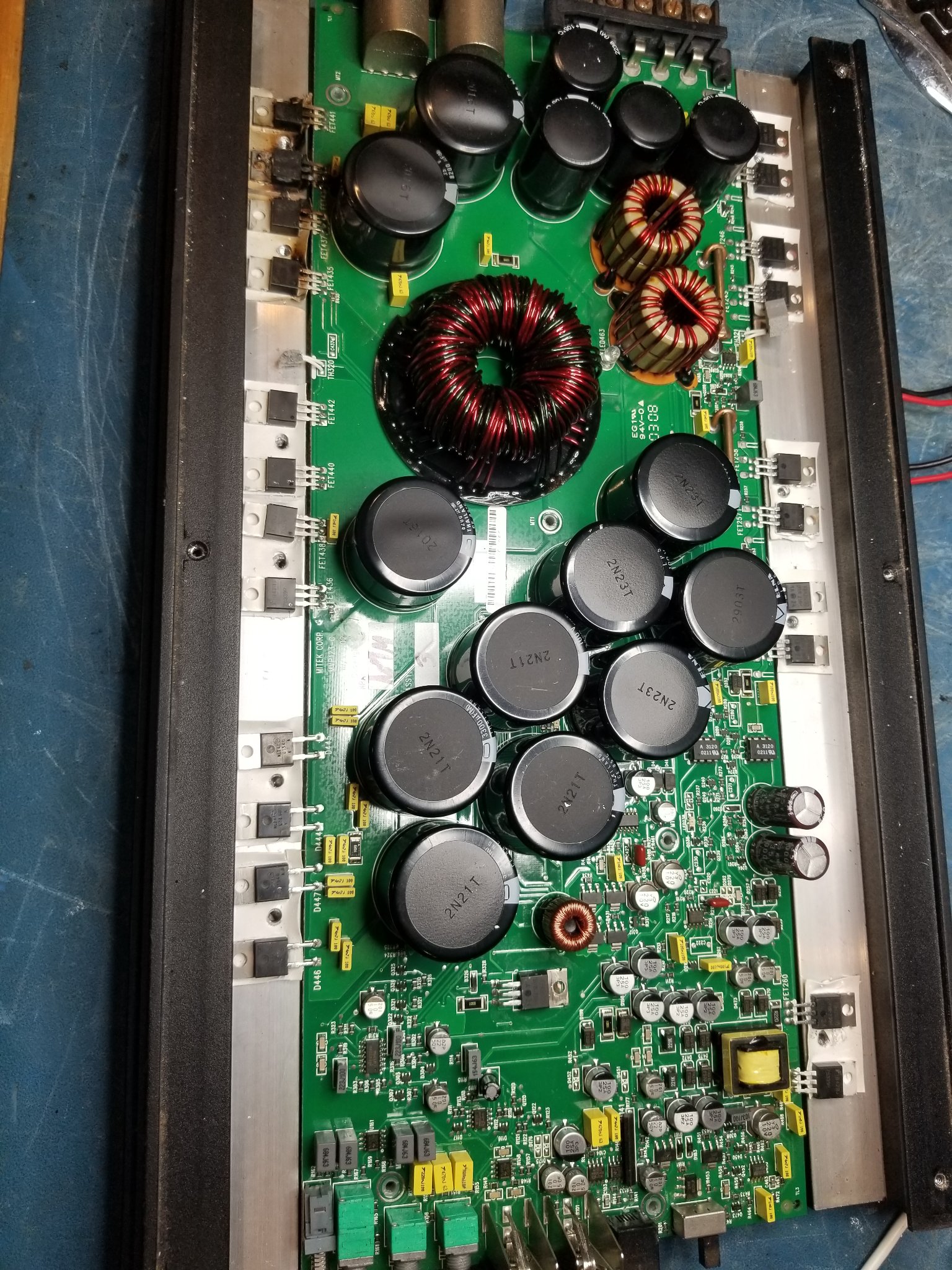

Hello everyone. I have a mtx 1501d that is in protect mode. I am a seasoned tech and work on a ton of home audio gear but am very new to auto amplifiers. I would like to get this thing up and running. I cant find a service manual for this amplifier and am hoping I can use this amp to get me more familiar with auto amplifiers. I popped the top and found four HUF75339P that have been destroyed. Looking at the speaker terminal strips it appears someone was wiring subs up to this amp while it was on and shorted one of the wires to the case ( arc marks on the case). Nothing else in the amp looks visually bad. I ohmed out all the ouput transistors and they dont appear to be shorted. Il post a couple pics. Are these fets still in production or are you guys using modern replacements? I work on a ton of vintage amplifiers and allmost allways need modern replacement. Anyhow if you guys can kind of give me some tips or help with this that would be awsome. I will post a couple pics and look forward to hearing from you guys.
After further investigation I found r435 is allmost fully open and d198 was very hot. It doesnt seem to test shorted or open but I wont know till I remove it.

There is no reason for it ever to get hot unless the amp loses the main ground and then the amp tries to ground through the RCA shields. Remove it and leave it out.

Move 2 of the survivors to the other bank (after removing all of the failed FETs) and replace the burned gate resistor and see if it will power up.

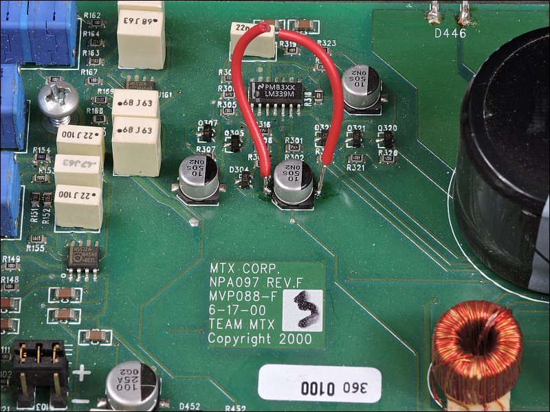

To disable the output stage, jump the capacitor in the image below. The wire is cut but that was simply to re-enable the output. You want to be very careful with the outputs, especially if they're the ones that are no longer available.

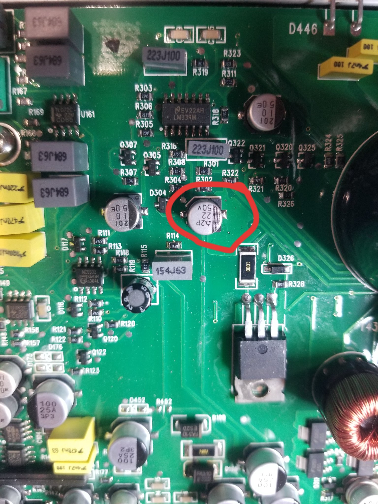

Yes I mainly work on the early transistor amps up to modern but usually the old gear. Pioneer, sansui, carver, and so on. I know these are a completely different world, that's why I'm here asking before I get ahead of myself. I moved them fets, replaced the resistor and had to replace the capacitor in front of fet 439 because it was bad I think just from the heat . Anyhow my amp looks slightly different then the one you pictured. Is the circled capacitor the right one to jump?
As far as I know, that's the same capacitor. Your amp has the FET that's used to discharge the rail caps. Connected between pin 8 of the 339 and ground?

That's what it is. If you power up and down repeatedly in a short period of time, it will get warm.
