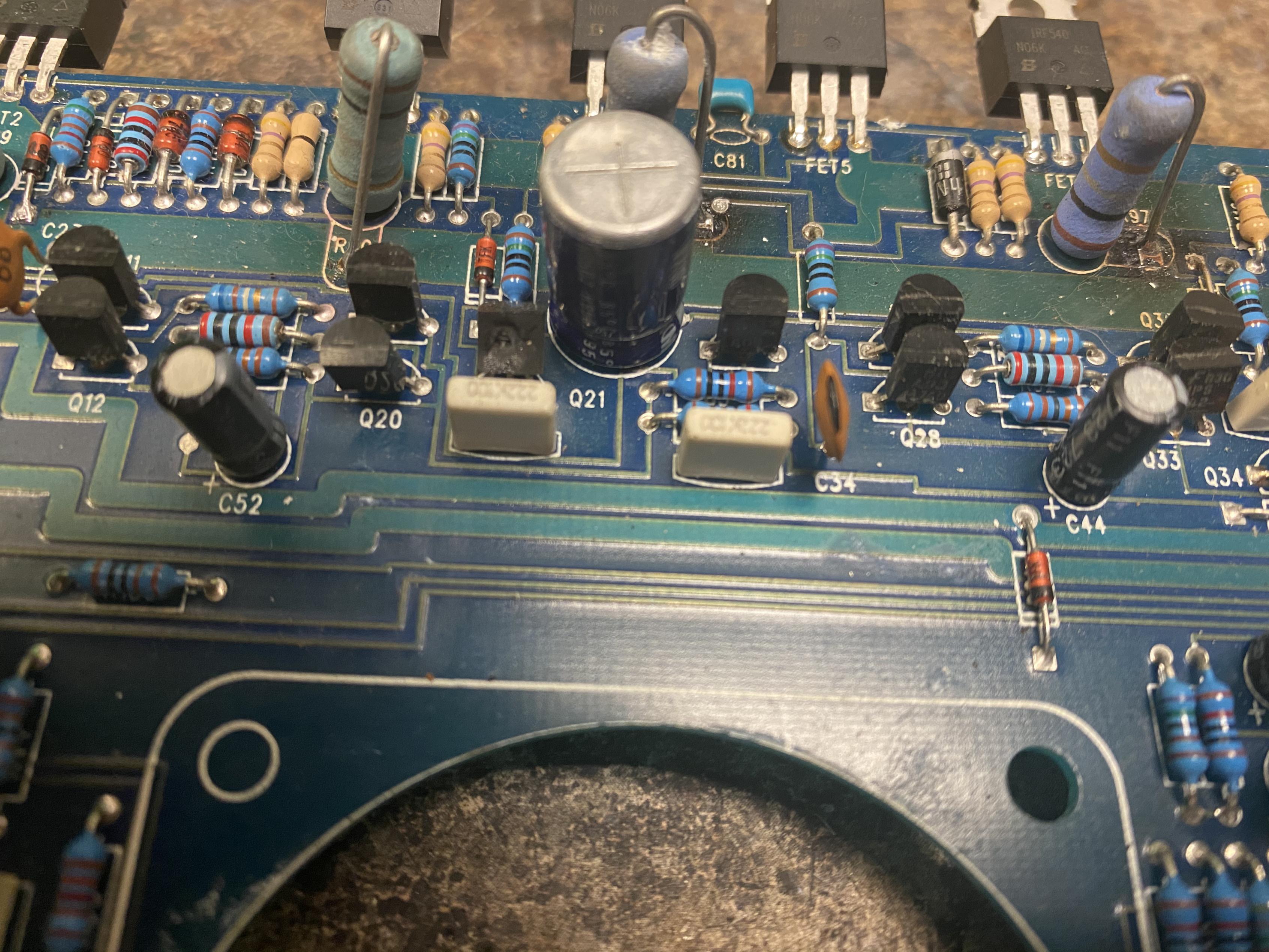

To drop something in those locations to replace the 6523 wondering what would you go with
MPSA56
A1266
MPSA56
A1266

Try both but note the pin configuration. It will allow further testing. For a closer sub, do a parametric search for a high-HFE, non-darlington transistor.
I found another shorted transistor .
The MPSW92 in the defective channel .
This transistor is also obsolete.
Do you happen to know of a good replacement for these ?
Not sure if the MPSA92 will survive

Ok some of the transistors I do not have on hand and are obsolete.
There are 2 MPS8099 transistors
I’m getting 2 totally different readings on them .
On 1 of them I get 3.88M ohms from emitter to base
On the other one I get 6.59M ohms from emitter to base .
Wondering if one is defective or why such a big difference when measuring them off the board
