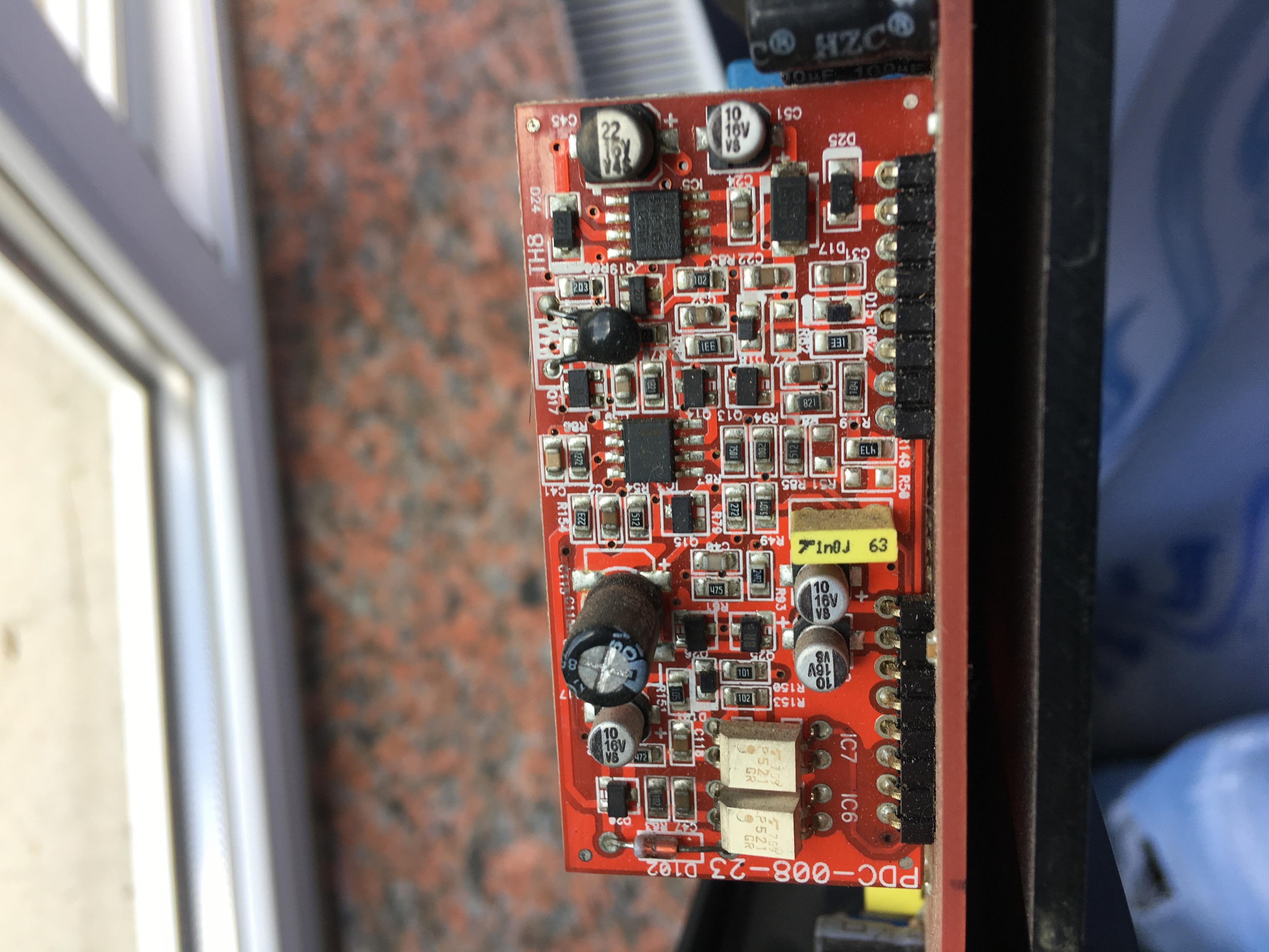

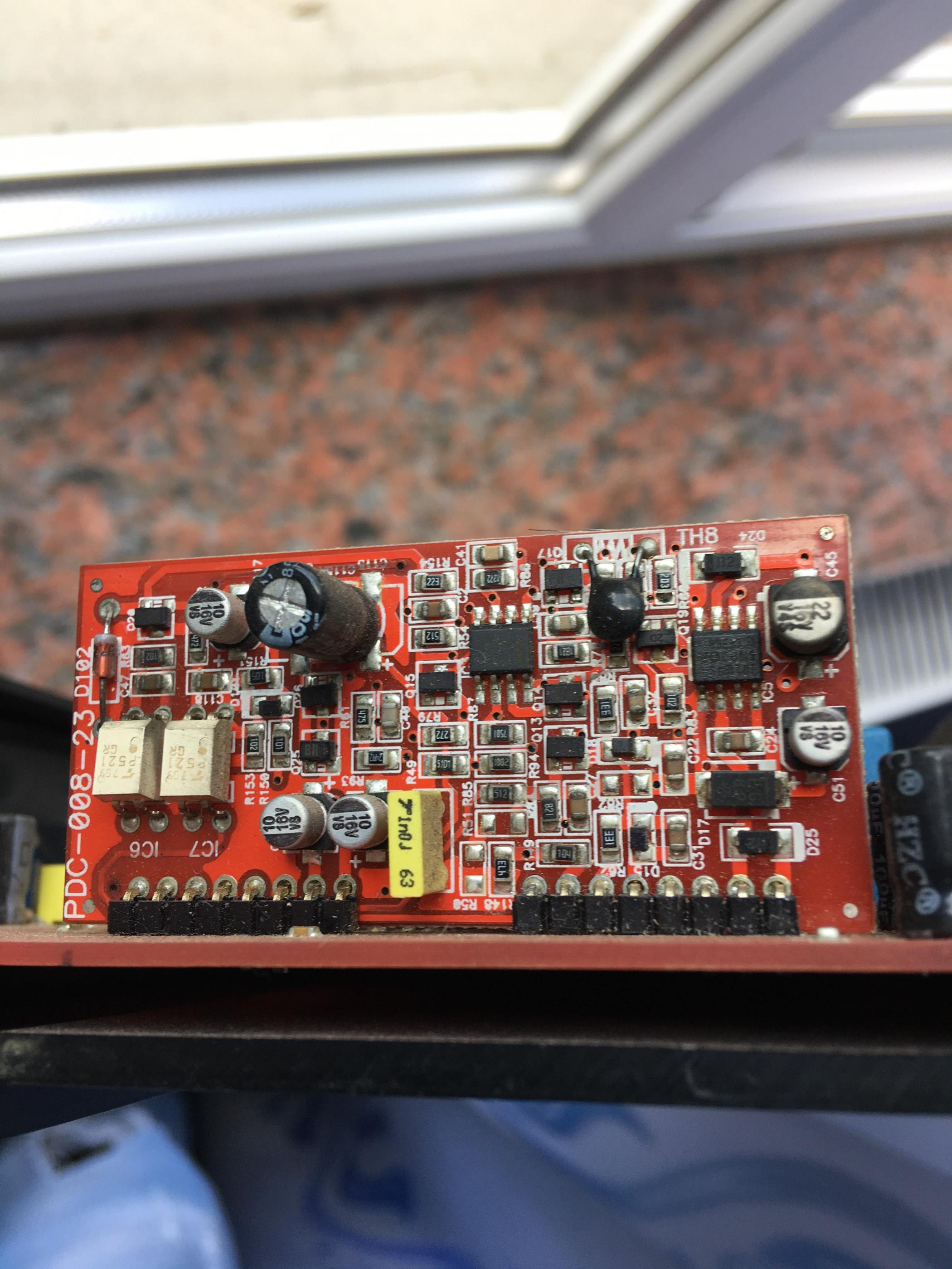

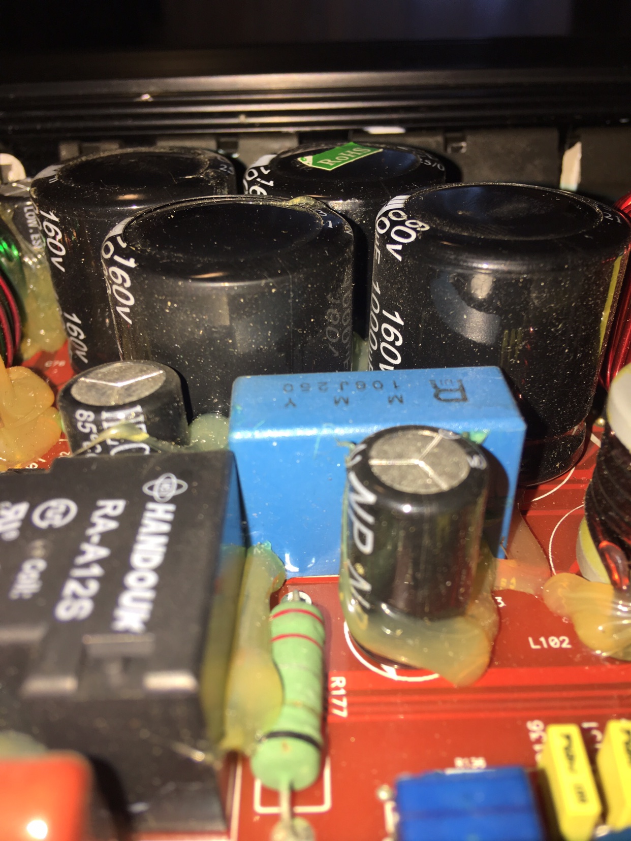

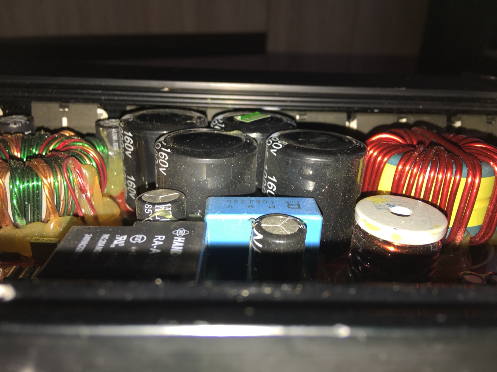

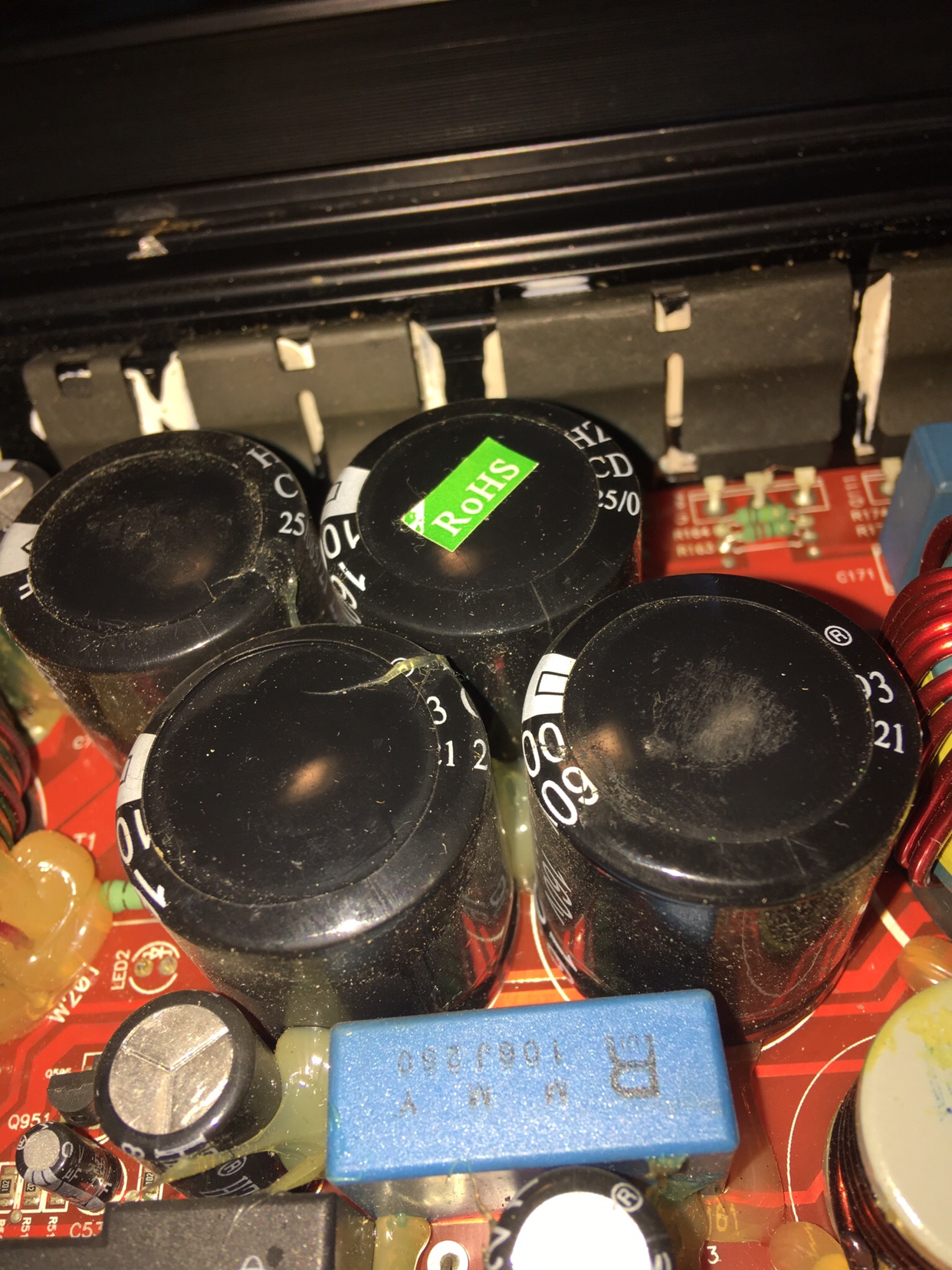

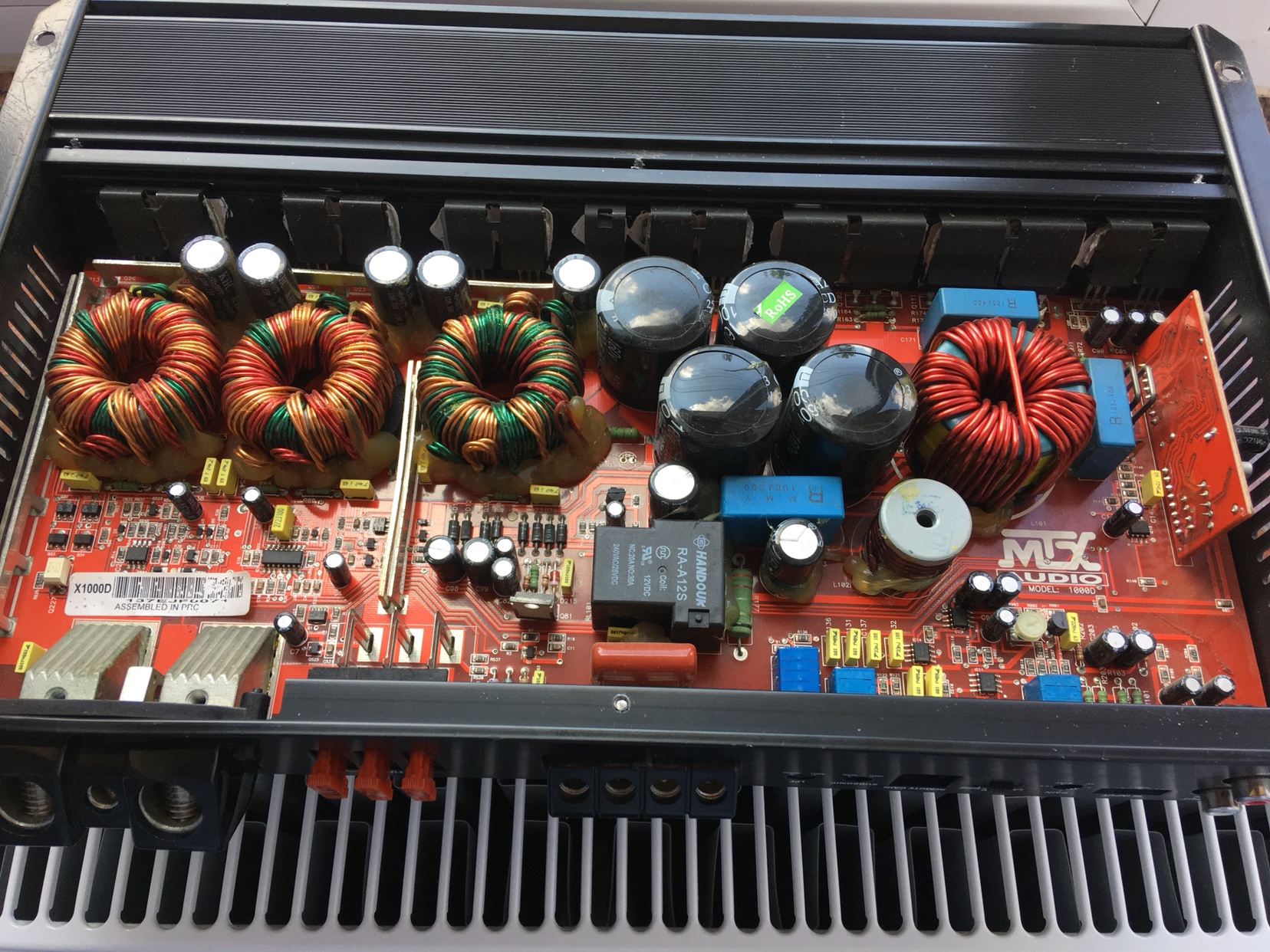

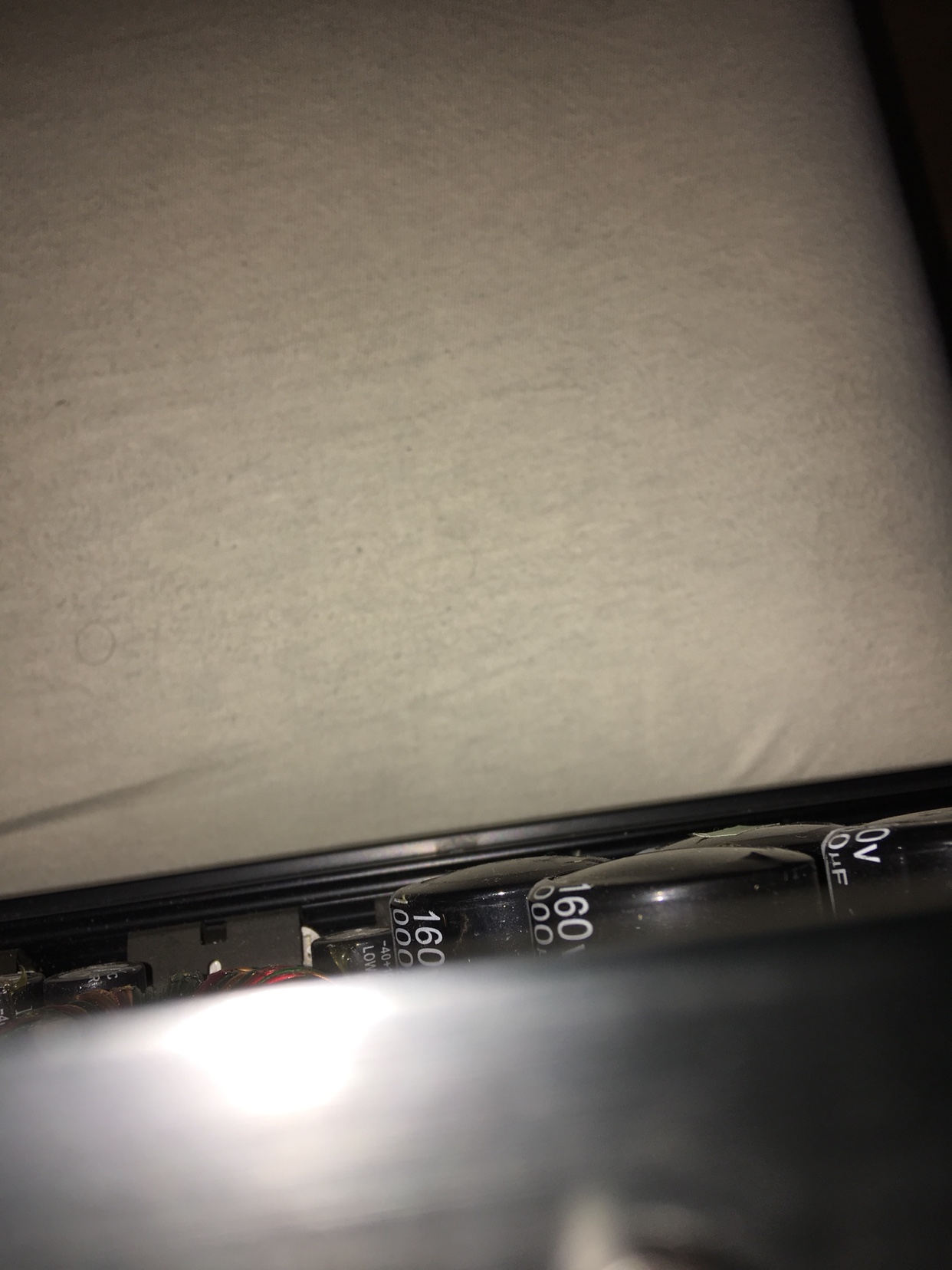

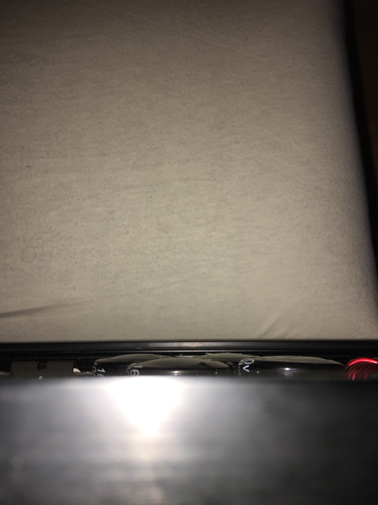

Please use the 'go advanced' and 'manage attachments' buttons to post photos. Posting as you did will cause a complete loss of any reply typed if you click on an image.
The caps are likely OK.
The amp sounds like it'a shutting down with the description of the LED operation.
The amp likely has shorted output transistors.
Pull the side cover and post a photo of the driver board.
Same thing. Type something in the message field then click your image then go back and read what you typed.
Hmm...is it ok now?
The diagnosis is the same at this point, shorted output transistors. You need to check those before doing anything else.
