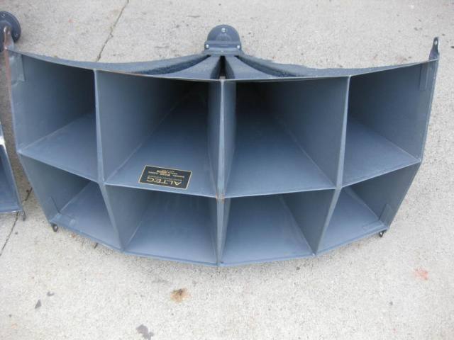

Well I love them. But some folks hate them.
To me, they are the best sounding horns. I currently use a pair of 8 cell 300Hz horns, but I think the 10 or 15 cell 500Hz horns are better for most uses.

Well.... the first thing I liked about them is that they were affordable. I got them for about 1/4 the price that a typical 15 cell pair goes for. That was the major factor.
But the 8 cell horn does have some advantages. It has a very tight pattern, which keeps the sound from splashing off the walls. Maybe too much, in my room. The pattern is stated as 35ºVx70ºH. That's pretty tight. By comparison, Cal's 1803s are given as 53ºVx105ºH. The 15 cell horns are similar.

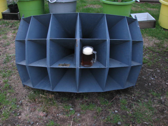

That "man cave" painting is really cool. I'm jealous!
And Cal, nobody told me multicell horns double as a place to set your beer. This just keeps getting better.
I can see what you mean about why they are not seen so much these days. 'Big, heavy, expensive to make' pretty much dooms anything it seems.
On the other hand, big-real-natural sounds fantastic to me.
MrKramer
MrKramer
For Cal, just about anyplace will do to set a beer. 😉
It does give you an idea of the size of the beast, doesn't it?

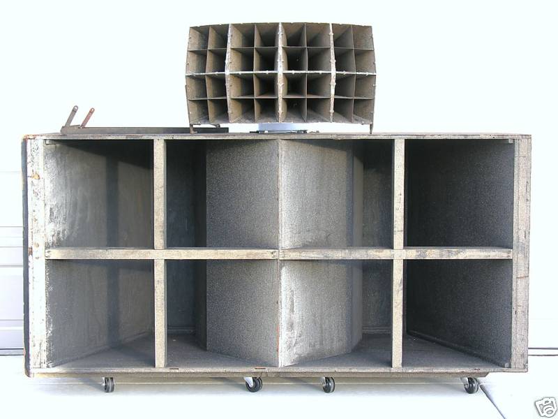

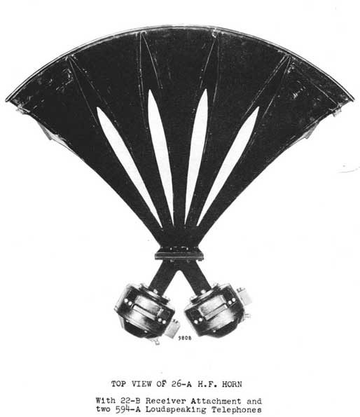

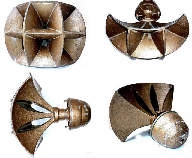

Why sure! Here's some photos I've collected.
Big Western Electric bass bin and amazing multi-cell that sold on ebay recently. The horn went for $950 Never seen one like it.
Also a little multi-cell tweeter that is now on ebay.

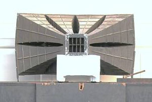

Here is the speaker that got me interested in multi-cell horns over 20 years ago. I helped rebuild the cabinets and used these briefly. The belong to Mr. Jean Hiraga.
Also shown is Mr. Hiraga's new listening room.

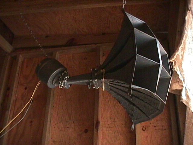

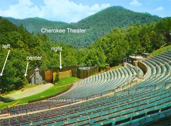

Here are the multi-cell horns I grew up listening to. There were part of the sound system at the Mountainside Theater in Cherokee, NC.
We have a 1505 and what looks like a tar filled 1005. Those tar filled horns are heavy!

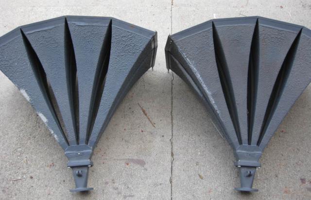

I have these 300hz Altec 1003b multicell horns. They are tar filled and f'ing heavy. Two guys can just move these, but I think you'd need more men to carry up stairs etc.
I bought these about 6 months ago but they are too heavy to move so they've stayed on the ground floor annoying the hell out of my wife.
