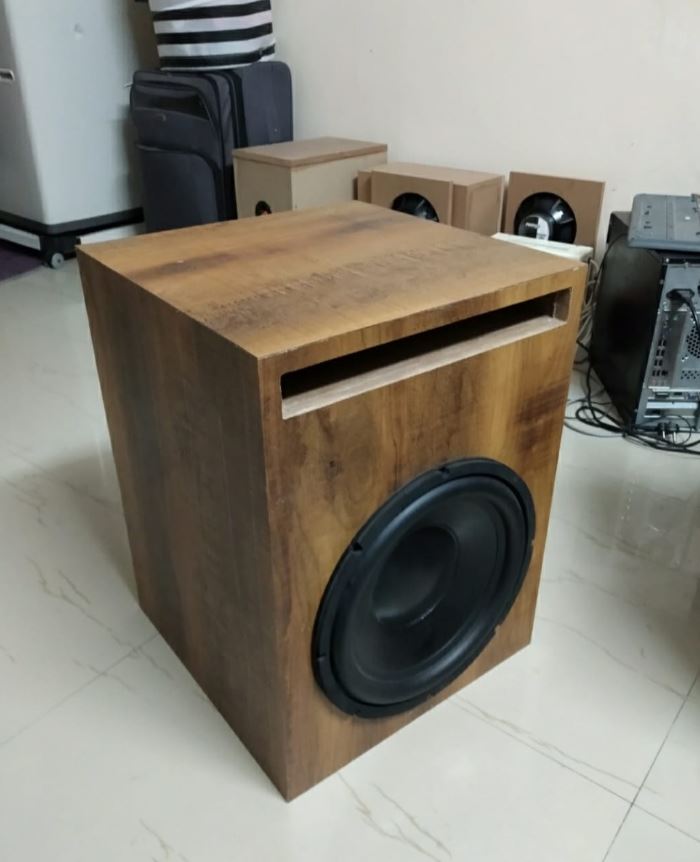

Hi all,
I built two 12" subs tuned to 30hz and another two subs tuned to 40hz.
Is there any bad effect if I use all 4 of them for home theater?
Since the subs are tuned to different frequencies, What kind of bass management is needed?
Any suggestions please ....
(see the picture of my sub in the attachments)
It will be difficult to get it right, the 40 Hz tune is quite high. The response of these will fall like a cliff below 40Hz. Chances are high that the 40Hz is below the lowest mode of the room (if the room is small) where multiple subs ideally should sum in phase (since there are no modes). This way they share the load, due to the high tune they cant.
Make the width/dia of the ports smaller to get 30Hz tune on those. High pass the mains very shallow at around 100 Hz.
I built these to experiment different drivers and different box tuning.
Finally I ended up with two subs with 30hz and two subs with 40hz 😀😀
As you said, if there is a possibility of phase mismatch, I will build two more subs with 30hz and use the existing 40hz subs in a different room.
Thanks a lot !!
