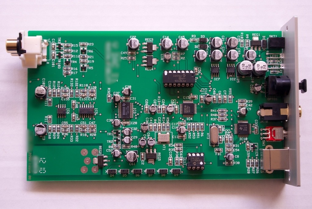

I've searched for old linear power supplies and haven't found them yet.
May I use a switching PSU with higher current or will it inject some noise?
From the photos of the board I see there's an LD1117 just after the input of the power supply (top right), so it sould be fine a switching:
Found one very similar to the old one. 12 Vdc 600 mA linear PSU with straight 1.3 mm connector, center positive.It used a 12VDC 500ma power supply with a center positive 1.3mm connector
