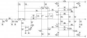

One channel has 10mV offset, the other has 60mV. Any hint for a remedy other than matching up a pair of input transistors ?
Documentation on these is scarce, so I worked with a drawn shematic someone made from the board (but missing all the helper circuits) and this russion link which was quite helpful.It's pretty close to what I have but mine is fitted with BC327/BC337 and looks "factory" to me.

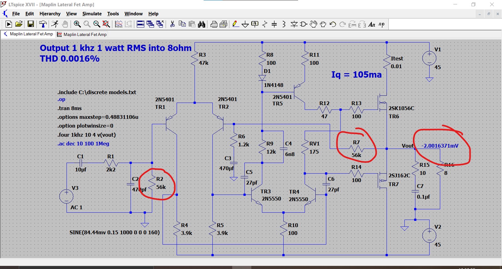

60mV is not worth worrying about but the only cure is a matched pair for TR101 & 102, or a preset on R103 ground point to move the voltage just off zero is another way.
Thanks for your quick reply, I knew it would be someone from the island being able to help me 😉
Matching TR101/TR102 is what I had in mind but not planning to do.. could you kindly elaborate on the TR103 preset to ground you are referring to ?
I am good at painting by numbers but not really an artist 😉

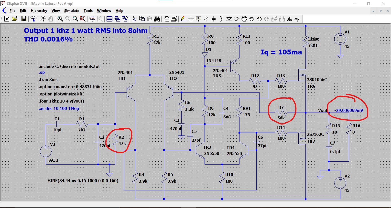

That looks very very similar to the old Maplin Latfet amp of the 70/80s. That also had non identical bias currents for the input transistors and also suffered with DC offset as I recall.
It can do, yes. The amp design itself does not major on DC precision, it has no need to as offsets of 100mv or less were considered acceptable at that time.

Thanks for that info, I misread "TR103" and could not get my head around what that would do.... Now I also understand Mooly's post about the other amp...
So altering the value of R3, maybe substituting it by a trimmer for finding the correct value before final replacement, should help me get the DC offset close to 0.
I'll look into that!
Easiest and quickest thing is to swap some of these transistors.
Changing R3 (103) will not change much.

Also I do hear the speaker relay clicking on startup (delay around 5 seconds) but the output offset is unchanged before/after relay trigger... The protection circuit is not shown in the schematic, I'll try to sketch that up from the board to maybe get more input from you guys.
