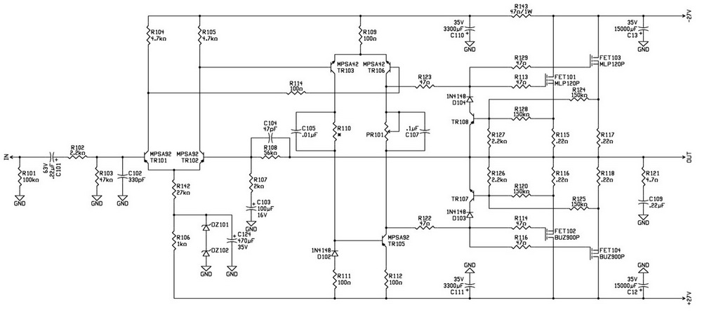

Hi Guys.
Unfortunetly my Musical Fidelity A2 plays different on one channel.
Sound from right channel is a litte bit dull, less vivid. When I listen to music the whole soundstage goes to the left side of the room. It makes me crazy.
I started to look for a reason why... I have checked preamp - ok, capacitors - seems to be ok.
Today I checked Quiescent current.
Left channel - 4 transistors x 300mA. That is ok - proper value for this amp.
Right Channel - 2 transistors x 300mA and 1 x 200mA and 1 x 360mA.
I was measuring on the emitter resistors 0.22Ohm.
The wrong value is on the pair MLP120P.
Why is it happening? What can be wrong in the circuit? Is it a bad trim pot? TR108? What can be a possible cause?
Thanks for help. It is a great little amp - I need to repair it.

Yes. On one resistor there is drop 96mv - and on the other one about 53mv.
I have checked DC at the output - there is about -48mv on the left channel and about -15mv at the "wrong" right channel.
Values after warm up - on the other resistors drop 80mv - 360mA.

It's not that uncommon for paralleled output devices to not equally share current. The only solution is to either match them (which usually means you need a larger number of devices to choose from) or to use bigger emitter/source/drain resistors which presents other trade offs.
Some manufactures install matched sets of output devices for just this reason. Generally, some current mismatch is to be expected, and it's not likely *anything* that's audible--especially at low to moderate listening levels. The imbalance has probably been there since your amp was new. It's especially common with MOSFETs as their Vgs threshold typically varies more than the beta of bipolar output transistors
The imbalance is more an issue when pushing the amp hard at full power into low impedance loads where you might be approaching the SOA (safe operating area) of the transistors. In that case it can mean the one getting more current might fail.

I have just checked drop on resistors R24 and R28 - Tadaaam! Different on bad right channel.
64mv and 27mv RCH
64mv and 64mv LCH

The difference in quiescent current is NOT a problem. It is very likely normal for your amp. You could completely remove half the output transistors and the amp would still sound great and still work fine at all but the highest levels of output. So, please trust me, the quiescent imbalance is not a problem and is common with MOSFET outputs like in your amp.

PS. For future - is there any replacement for MLP120P?
Hi Sviru
You should try BUZ901P
This is the BUZ900P complementary.
You will need some to match them and they are expensives....
Mosfets must be matched because they have large differences for the same number.
I have made some xperiments with mosfets and this can be your problem. Quiescent current is important too. These amps sound better with a large current. Do not go up to 55 deg C on the heat sinks.
64mv and 27mv RCH
64mv and 64mv LCH
Nothing strange about that, since you have different quiecent current on the two ML120Ps.......
What happens when you try to adjust the bias pot PR101 ?
Since the lower side seems to "match", I would still suspect the upper side MLs........
When I try to adjust PR101 quiescent current of the whole channel changes (all transistors). But the voltage drop ratio between the two wierd MLPs seems to be constant.
