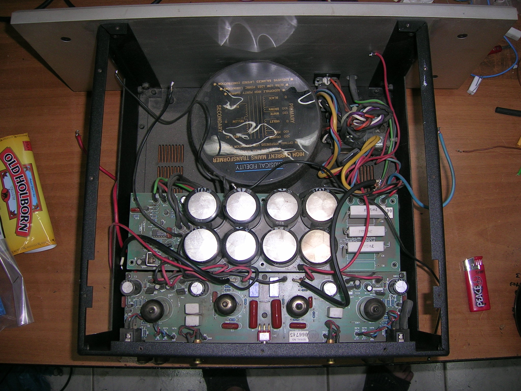

I can't remember what made me take the top of of 1 of my P150s but i was in for a bit of a shock 😀 I bought a pair of them to driver a pair of 2 way active speakers & i probably thought i'd just check them out internally.
Anyway, i noticed that more than one of the main PSU capacitors looked like there was a rather lot of pressure build up inside. The end of the capacitors was literally bulging (snap in electrolytic). So i looked at the voltage rating, 63V & all should be ok on a 75W per channel amp. That was until i checked the rail voltages which were +/- 69V DC idling 😱 Talk about a sagging supply under load, the transformer is kind of undersized..
So, if you own one of these MF amp make sure you change the main PSU storage capacitors for something like 80V versions. I was lucky & happened to have 8 x 80V capacitors with the same capacitance, if i remember right it was 6800UF. I doubt you'll be able to stick anything bigger in as the amps are already quite slimline. You'll need 4 caps per amplifier.
You have been warned 😉

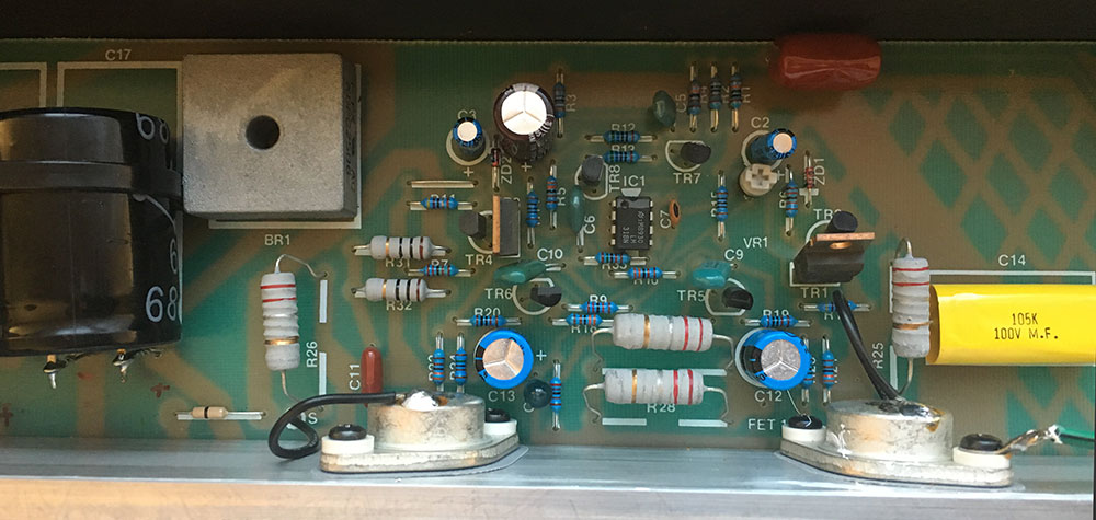

I'll back you up on those things. I repaired many here in Canada. But you did forget to make something more clear. The excessive internal case temperatures!
Way back when, I was replacing the capacitors with ones of a suitable rating, and 125 °C (not really good enough). But the most telling situation was how they decided to drive those mosfets. Crank it high and use TO-92 devices as drivers. The driver stage couldn't really deal with the gate charge on the mosfets. Another endearing trait was the wire soldered to the top of the mosfet casing to make the drain connection to the power supply. Outstanding!
At least there were somewhat reliable and easy to figure out when schematics were hard to come by. I had to reverse engineer a few.

I found some pictures and see what Chris means about soldering to the transistor directly... here the case of a T03.

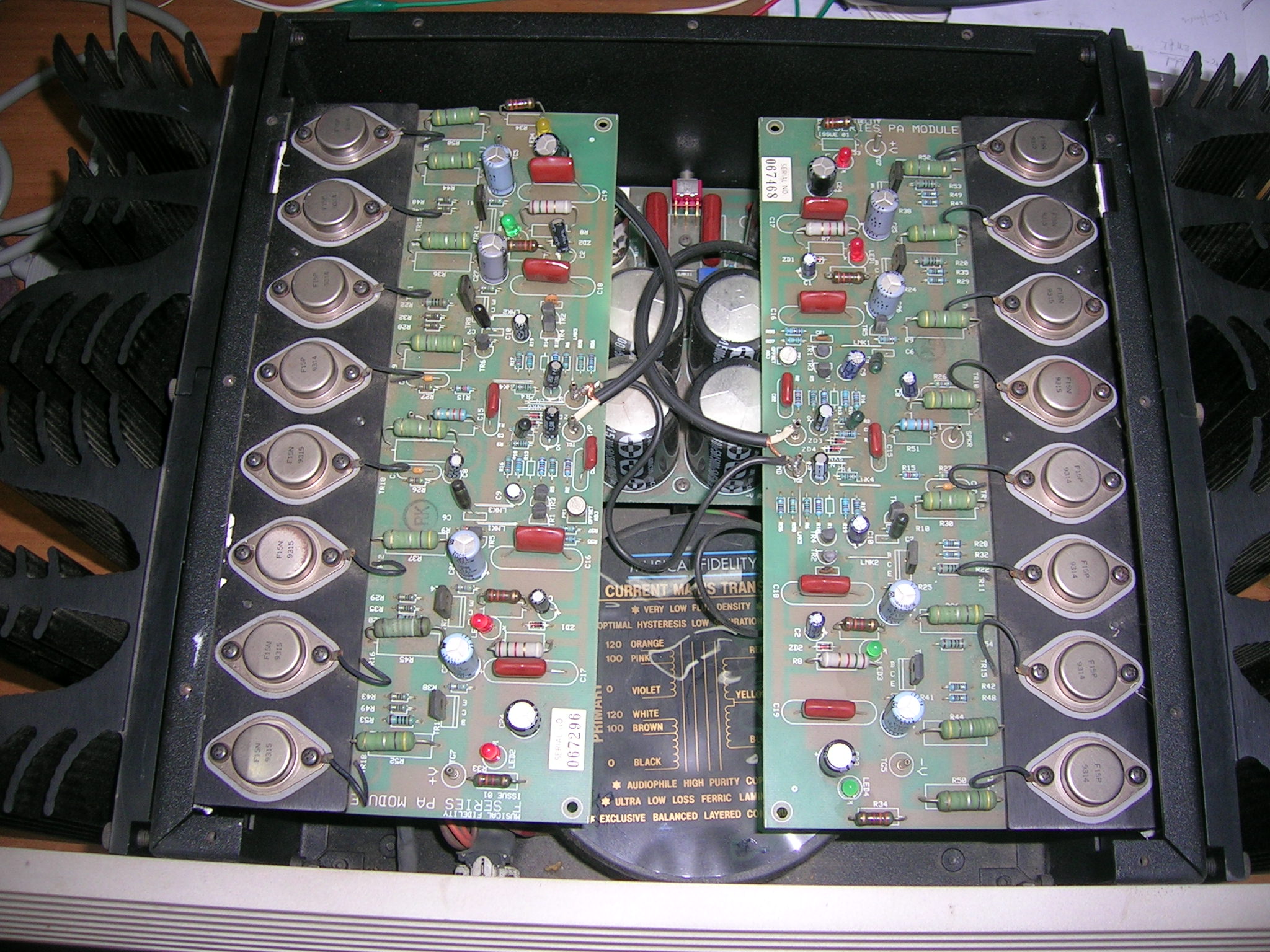

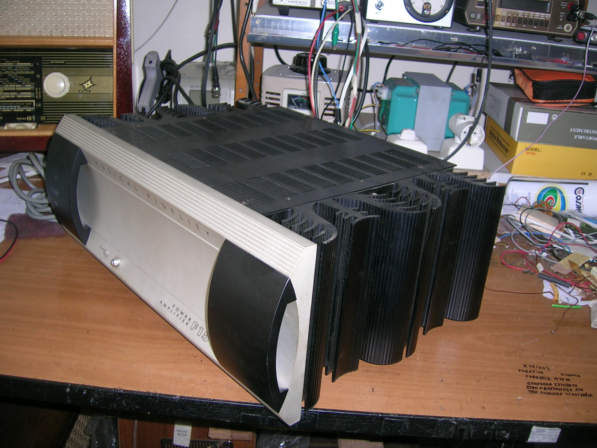

Hi all
The A1 and B200 have found their place in history as a bad example of -heat generated- unreliability plagued amplifiers.
I was quite surprised to see the same problems on a F15 monster.
Heat is trapped inside. Thus, PSU caps dry-out (to the extend of bulging externally and shrinking inside, thus the rattling when you shake the caps), diminish in capacitance and increasing in resistance. Thus x-former and rect. Bridge heat-up (worsening the scenario), DC is no DC anymore, one or more of the PSU series power resistors burn, two or more of the FET output devices fail. (*PS1)
The un-rectified lack of heat management is unforgivable for a manufacturer. Heat build-up is readily measured, consequences of elevated temperatures are well known in electronic components, so there is absolutely no excuse for them selling such equipment, regardless of market price tag. (*PS2)
*PS1. DC voltage on F15 was +/-63V. PSU caps were 65V rated. Although the 2 Volt margin is that small, I don’t think that an 85V cap would do any good. It is solely a high temperature environment issue there IMHO).
PS2. In addition (or due to it?)to high market price, Musical Fidelity was offering an after sales upgrade for F15. They were replacing all the “critical” caps with higher quality parts, they were bypassing all the elcos with polysomething caps, they were demagnetizing the x-former and they were “reorienting” the magnetic fields around the x-former, plus measuring and adjusting the dc residues at the output. All these for ~700UKP. Absurd. I would expect them to address the thermal issue instead of dealing with *@#$!*
