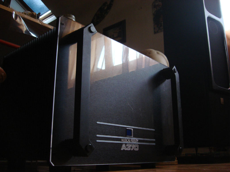

I am rebuilding 2 A370's and 2 P270's and would appreciate help with replacing the output devices.
In rebuilding I have decided to change the output devices as these run very hot. (In the rebuilt ones I will run them at about 50 degree centigrade as the mark 2 versions of each ampifier did.)
At present the amps all contain different output devices as follows;
P270 - 2sk1058 and 2sj 162 ( sound very good )
P270 - 2sj83 and 2sk227
A370 - buz - 905p and buz 901p
A370 - 2sj118 and 2sk413 ( sound good )
I would like to standardise on the output devices so that I can match sets for each amplifier economically and without having to buy different devices for each amplifier. I have a LOT of irfp240 and irfp9240 ( which I like the sound of ) and would prefer to use these if possible - although they have a greater capacitance. Has anyone tried these in the MF amps?
Otherwise any advise on the best FETS to use would be appreciated.

Forget the vertical FETs unless you are tooled up to properly debug the resulting abomination.
1058/162 are easy to get and can run fairly hot, but they are plastic devices so be sensible.
I got 16pairs a while back and manged to get 7 well matched sets of four, the Nchannel are consistently closer than the Pchannel . The 8th set had one device that was a few more mV different (well actually less mVgs) from it's partners and it shows up as extra quiescent current in that odd device.
I can only run 75mA per device otherwise the sinks get too warm.

Hafler used Exicon after Hitachi quit making their parts.
http://www.profusionplc.com/subsites/exicon.htm
The plastic only run GBP 4.15~5 in small quantities.
Hi,AMV8 said:Have you tried the buz 905 and buz901? If you have any comments on those devices that would aso be helpful.
no experience of any of the other Lateral FETs.
I have heard that they are all very similar and probably made under licence from Hitachi.
The specs from the old To3 devices to the whole range of current devices are VERY close.
I wonder if the same silicon shop is selling wafers off to be cut up and soldered to the backplate of these different "manufacturers"?
Andrew

Tc=60deg C is very different from running the heatsinks at 60degC.
If the sinks were at 55degC the worst Tc at quiescent could be >=65degC
What I am saying is that 55degC is very hot if you want good SOA from these plastic devices.

how hot your run the FETs is determioned by the loadline (the number of parallel devices) and the temperataure de-rated SOAR. For four pair on +-69Vdc and Tc=50degC the amp can safely drive a 60degee phase angle 8ohm load to about 195W until the heatsink starts to rise even higher.

I am not sure of the 118/413 pair, but ALL the others used in the MF Ax70series amps are Lateral FETs.
The change to Vertical FETs will completely change the amplifier and particularly the thermal stability of the output stage.
You are likely to blow it up if you change to VFETs.
Have a look at Vgs of a lateral and compare it to a Vertical. They are different animals.
Look at the change in Vgs with temperature. Again they are completely different.
One cannot just swap between LFets and VFets. This becomes a redesign.
I can tell you what Fets NOT to use in an MF amplifier. Don't use IRF!!!!!

Hi you can replace all the fets with 2sk2221 and 2sj352.
thay are pin compatible with old plastic lateral fets.
if the amp has had the semilab fets fitted (exicon) you will need to lower the bius current.
thay are more stable than the 2sk1058 2sj162 and the exicon's
i get these fets in reguly.
these are the plastic equvilent of the metal 2sk176 2sj56 8 amp 200v

hi there im using buz900 buz905 pairs on my mf a370 (metal packages) got them from ebay (there from semelabb ) 10 pairs of each for £75 . these have been running at 80mv and sound fantastic .. ps do you find the a370 has some lift at the bottom end ??????????
