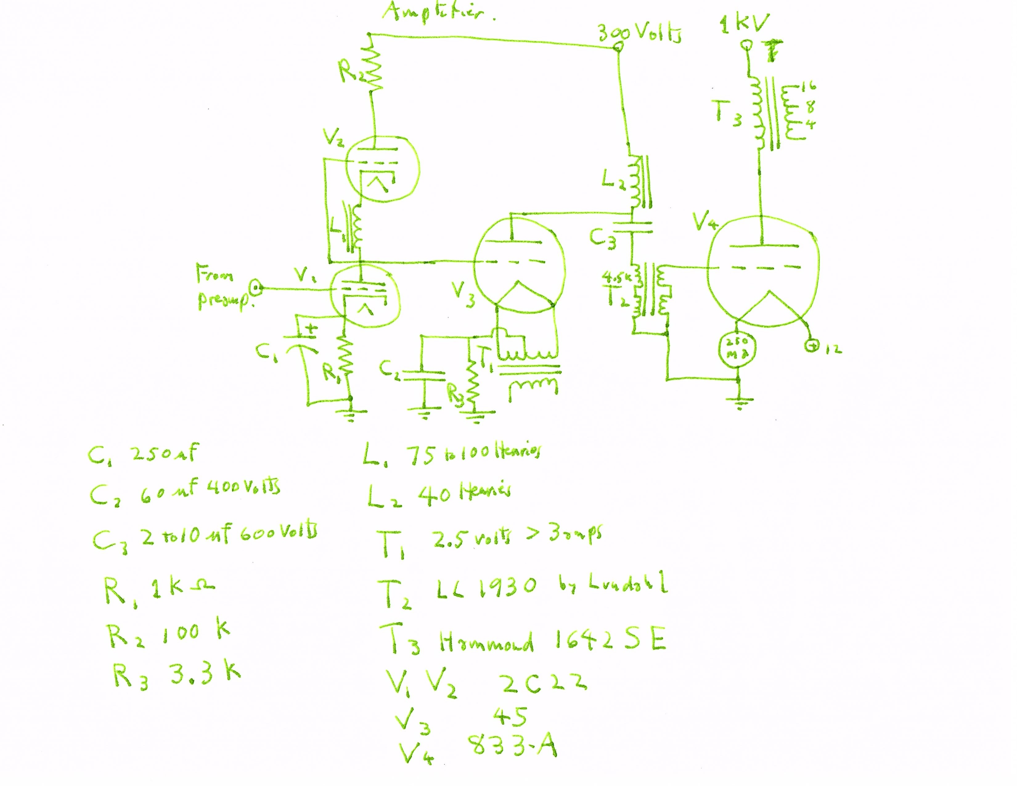

Could you provide a schematic? And what is the red material?

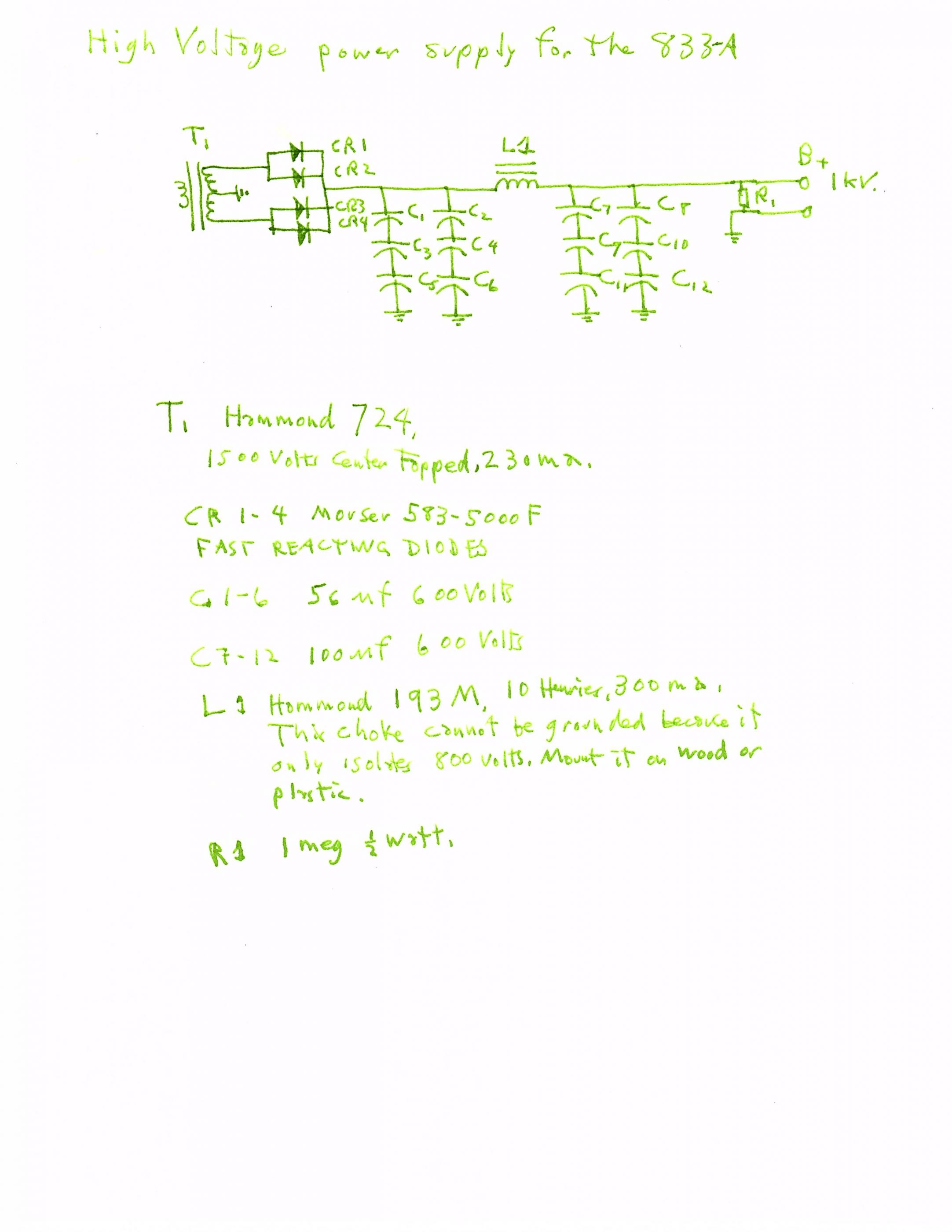

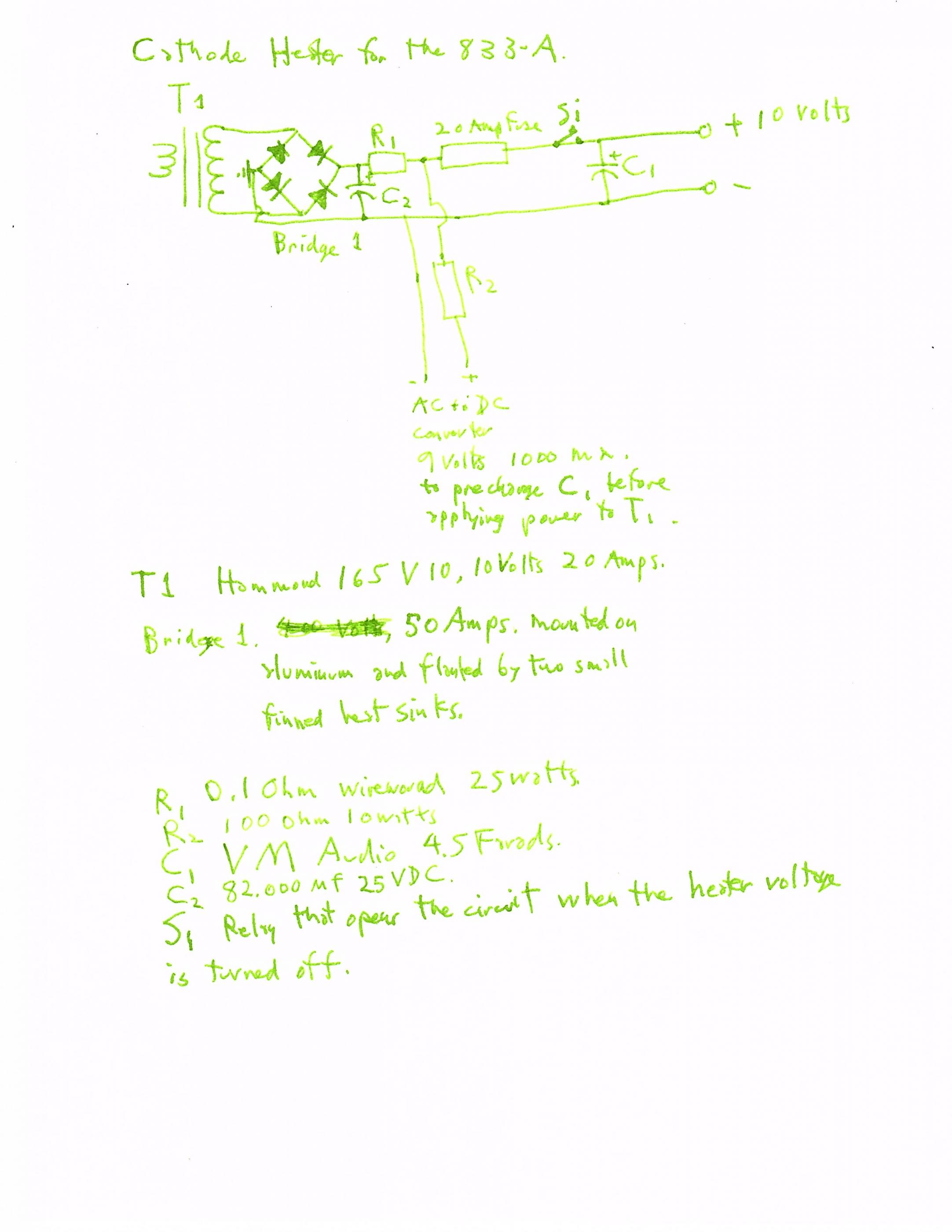

The 10 Amp 10 Volt supply has 0.1 Ohms which puts the voltage after the 4.5 Farad capacitor just under 10 Volts which is ideal. The 1000 Volt supply uses chokes which have to be isolated in plastic cages because they are not pot tested as high as 1000 Volts.
> No voltage equalizing resistors
If electrolytic, all from the same lot, it will be OK, for a while. One gets higher voltage, which increases its leakage, which reduces its voltage.
I'd be more interested in the 1Meg 1/2 Watt "bleeder". Few 1/2W resistors are rated over 350V long-term. (Also it does not bleed much... 90 seconds to reach 50V; _IF_ the resistor hasn't failed from voltage stress.)
It has been over a year and a half. I just put enough of them in series to have them overrated. So far, no signs of trouble. www.mouser.com and www.digikey.com have resistors which are rated at the voltages needed. I wish I could find capacitors rated so I did not have to put them in series because, if nothing else, it would be more convenient.

That poor ½ watt, 1,000 kΩ resistor! P = E²/R = 1000² ÷ 1,000,000 = 1 watt. I definitely recommend replacing with a string of ½ watt, 220 kΩ resistors… 4 of them would be about right.
While you're at it, use 330 kΩ resistors across each filter capacitor. Cheap, easy, the kind of thing that other posters have already talked about.
And if you are into making a few subtle corrections, the 10 volt, 10 amp supply has the switch kind of on the wrong side of the 4.5 F supercapacitor. I saw on the first page that the 4.5 F is “precharged”.
Lastly, I'm wondering, what the heck the 100 kΩ resistor is on the amplifier's 'top' 2C22 valve anode. You seem to be using choke loading (which I admire), so what's the 100 kΩ for?

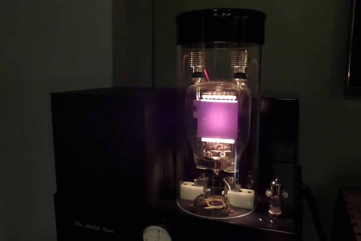

Post-lastly, I kind of wonder what the quiescent 833 anode dissipation is. It apparently has a 100 watt thoriated tungsten filament, and at least one source says that “normally, the anode glows deep red”. Is this true, or does the 100 W TTF glow outshine the anode?

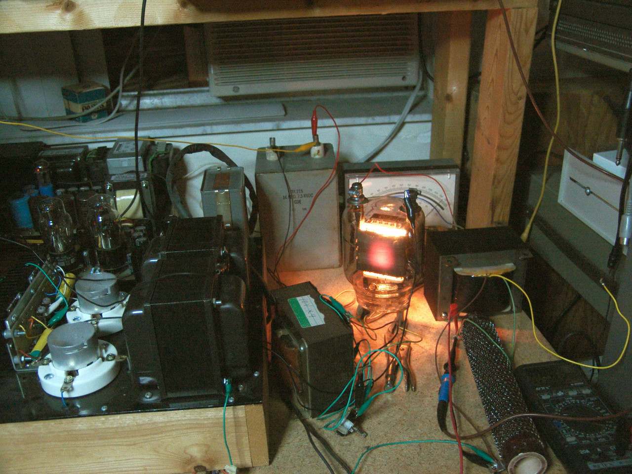

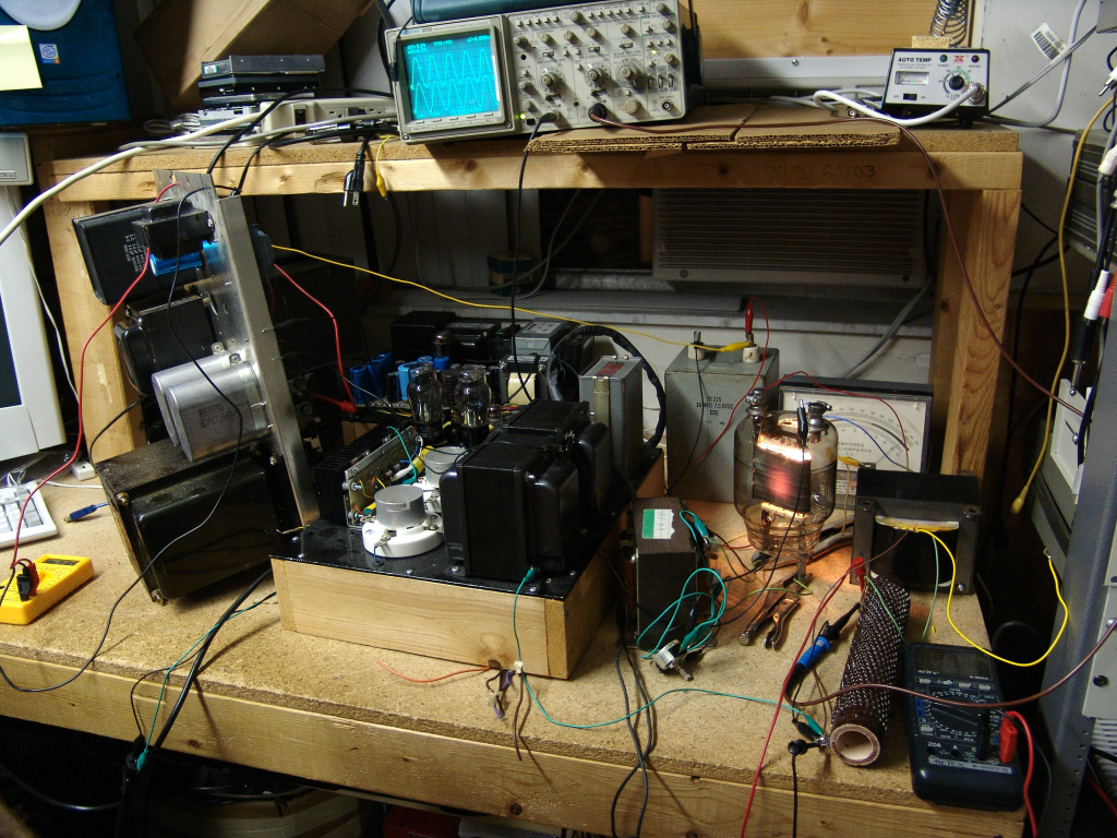

Both are quite visible but different color. In these pictures the tube is dissipating about 400 watts and as stated the filament gets 100 watts. The plate glows red at idle.

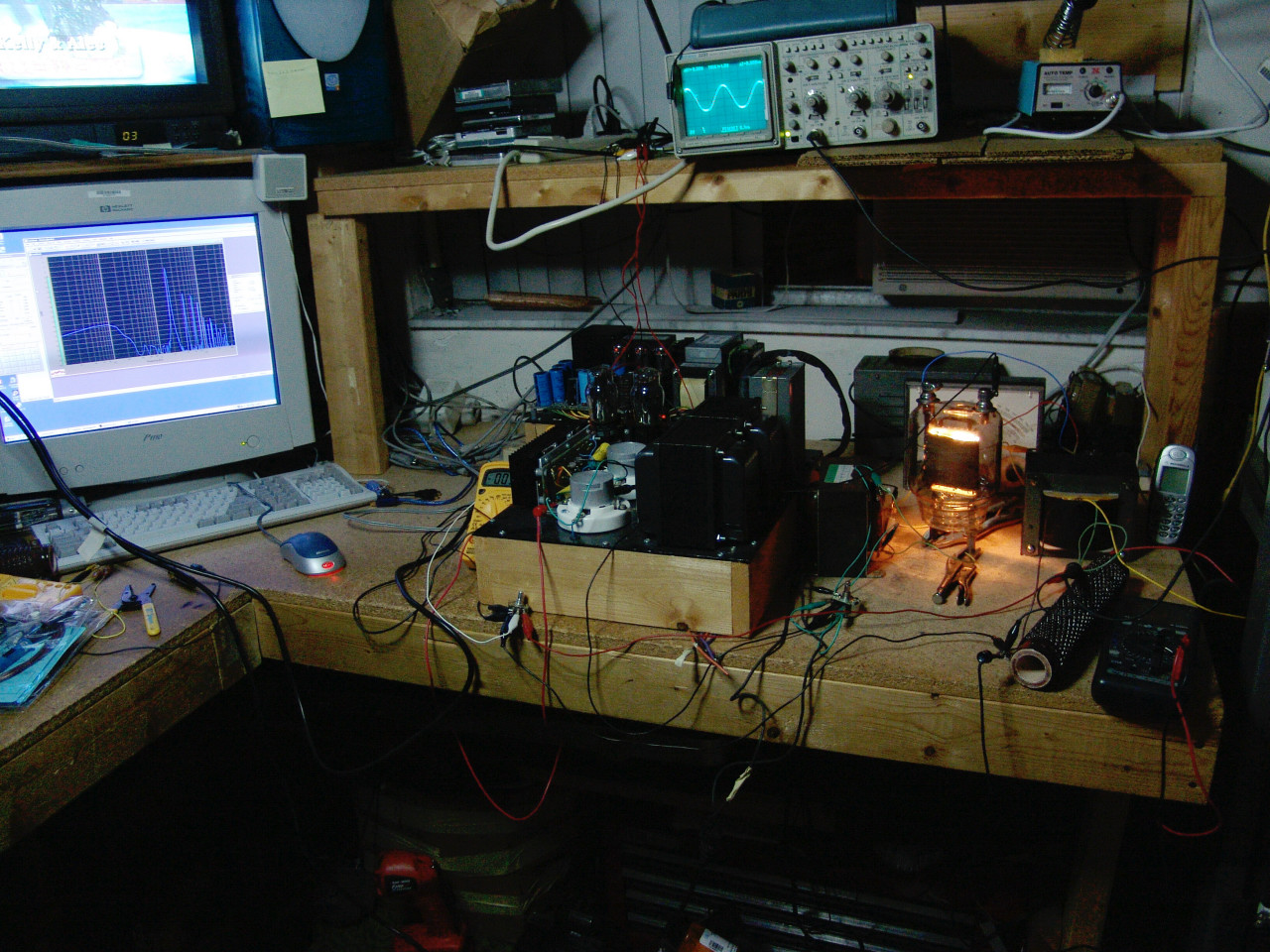

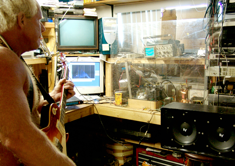

Note: Don't try this at home.....that power supply (standing vertically on its 75 pound transformer) was lifted from a radio transmitter and is rated for 1500 volts at 1/2 Amp.
This was a temporary setup to test the custom spec OPT I had made. It only existed for 1 week and there was a Lexan "blast shield" between me and it for testing (removed only for pictures since it was pretty scratched up). All pictures except the abuse test were taken with the overhead shop lights off. There is still plenty of ambient light in the room. The abuse test had 160 watts of fluorescent shop lights overhead. This washed out the filament glow since the color temperatures were similar. The red plate glow was still visible. Note that it's IR emission could be felt almost anywhere in the room.
Scope shows input (bottom) and speaker output (top) at 200 watts output. Plate glow is nearly gone at this level since the dissipation drops to about 200 watts.....400 watts DC input, 200 watts of audio output.
I performed the "serious abuse" test with a guitar preamp and speakers. It could be heard from two blocks away.......yes, this obviously happened quite some time ago. In several of these abuse tests the worse that happened was a tripped bench breaker twice. I could find a tempo with my guitar playing that excited a resonance in the power supply somewhere in the 2 Hz range. Continued playing at this tempo started pulsating the bench and room lights and eventually tripped the 15 amp bench breaker.
I measured the Voltages on the output of the lower 2C22 (a few years ago when I was running it as a 45 SET to get it to match the Voltage on the 45 grid to eliminate the coupling capacitor) and it took the 100k on the upper 2C22 to get that match using the same B+ for the driver of the 45. I later replaced the 45 output transformer with several transformers I tried out to drive the 833-A grid, a Hammond which did not step down enough, a choke capacitor coupling, a Lundahl in parallel feed which sounded good but was too thin sounding, and finally the LL2765 which has a rich full-bodied sound. A Sowter would probably work just as well at about the same price.
I the bleeder resistors are much bigger and rated at some 2 or 3 Watts and I remember it rated to several thousand volts. The way I mounted the capacitors in Plexiglas with holes drilled and soldered wires filling in and anchoring the holes because I could not find ring mounts for them made it too difficult to solder bleeder resistors in each one of them. I wish I had known about available film capacitors available at 2 kV ratings. It would have been easier to build.
I can't see any red glow in the anodes because the cathodes light up so bright. I like to run these tubes gently because distortion sets in when tubes are pushed hard, at easy going current well below up to 300 Watts maximum continuous dissipation, the electrode seals eventually give way and the tube loses its vacuum. More than once I tried used 833-A tubes used from ebay and this is how they had lost their vacuum.
If the seals fail when operated under 300W dissipation, there is probably not enough airflow to keep them cool. Is there enough space around the 833's and convection from below?
The anode is supposed to glow dull red: the zirconium getter deposited on the anode only works above a minimum temperature. No glow means no getter function resulting in a gassy 833.
110 ma at 1kV is more than enough to make Magnepan speakers more than loud enough in my small house and that way I don't need forced air cooling, even though the tubes are enough in the open not to trap heat.
