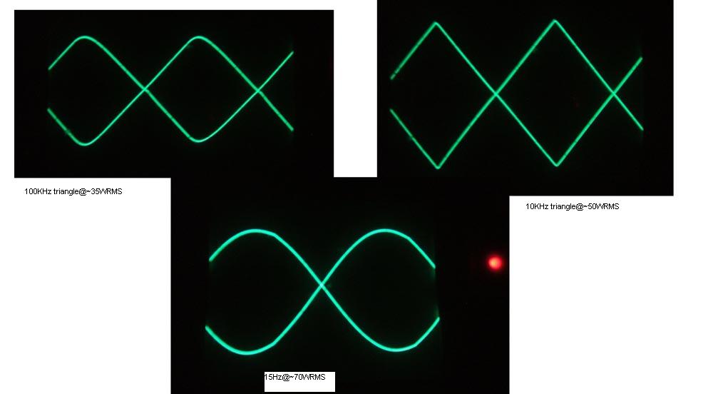

Here is some more, there may be a little phase shift at 15Hz, but seems to be a little better at 20Hz. Maybe something else to tweak. It's not too bad though. I don't know what can be tested with a triangle wave, but it sure looks pretty
. BTW, this is all with the output fet's bias at around 75mA, I think maybe it should be higher. The temp-co seems to be a little be overcompensated too because it starts out at over 100mA until it is warm, then decreases.

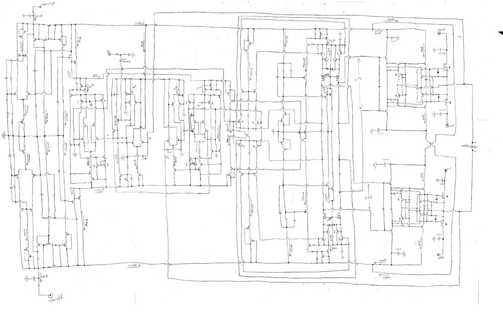

Workhorse said:Where is so-called schematic of your bridge upon the river amp??
Well, there is two places that it exists at this moment. One is between my ears, and the other is sketched out on a poster paper stuck on the wall because it contains 146 transistors and it is the only way I can draw it all out and still see and read the whole thing.

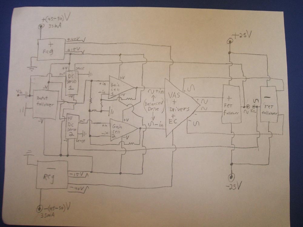

After some sleep, I got around to sketching a block diagram of the amp. I took a more 'modular' approach to the design, each circuit performing a general function. With no GNF, this made it easier to construct because I could focus on one circuit network at a time until I get it working properly, then move to the next one, ect. Eventually I was able to exterminate most of the bugs and get all the circuits to work together. Most of my surprise comes as I haven’t yet blown any of the output fets building this circuit. I'm usually par for roasting at least a couple of output pairs experimenting with new circuitry.![hot :hot: :hot:](https://files.diyaudio.com/forums/images/smilies/hot.gif)
To input a disproportional signal to the +in of the first gain cell circuit and the -in of the second, a balanced drive can be created for the VAS circuit using two equal gain cell circuits.

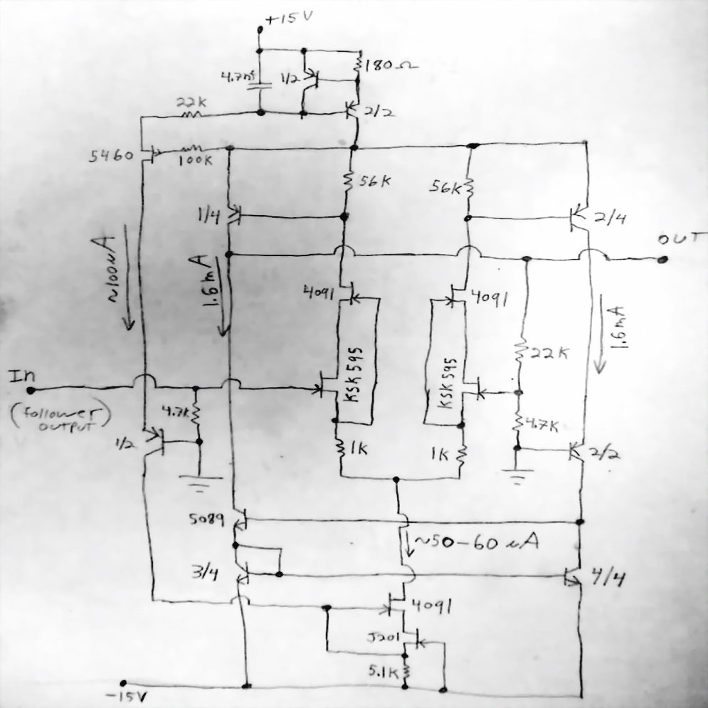

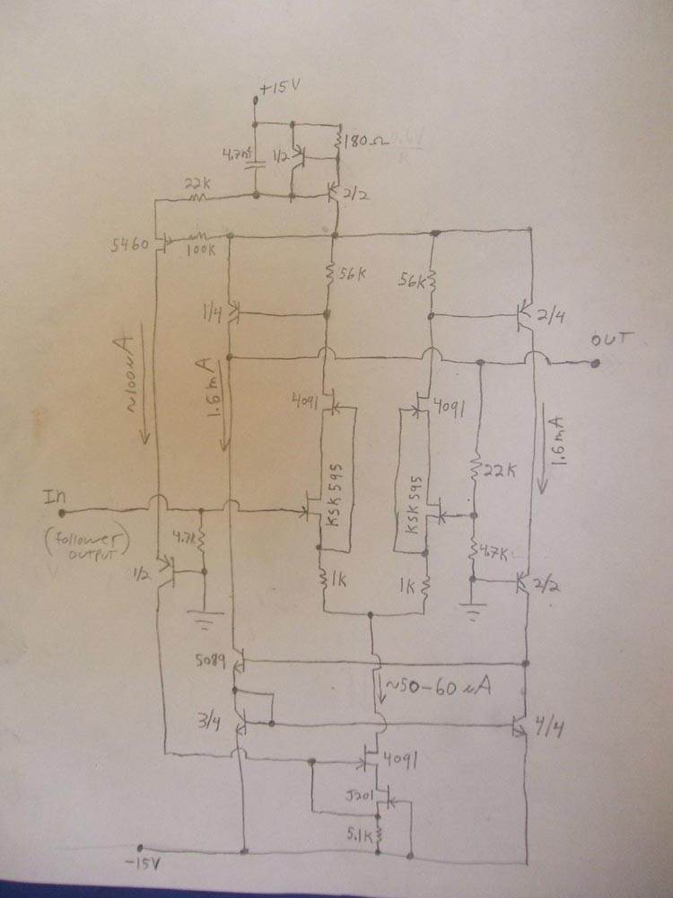

Here is the 'gain cell' circuit I used. It is self bias using common mode feedback. The transistors labeled 1/2 & 2/2 could be arrays or any general device, I guess. The transistors labeled 1/4 - 4/4 is a THAT 340 matched array. http://www.thatcorp.com/datashts/300data.pdf
I like these, IMO they work quite well, despite only an Hfe of around 100 or so. But high gain is not their intent here. The 5460 has a Vgs of about 2.2V @100uA. 5089 is a low noise, high gain transistor. http://www.fairchildsemi.com/ds/MM/MMBT5089.pdf I have found that, at least for the KSK595's I have, they work great in the 7-10 Vds and 25-50 uA range. I measured Vgs @ 25uA of about -0.35V and Rds of 1500 Ohms. It appears Fairchild MAY have discontinued these, they were 4 cents a piece when I bought them, now they are more than 50 cents and Fairchild appears to be out of stock
. Seems to be a common trend with them. That's OK, I have about 300 of them.
I would be willing to bet the circuit could work with just about whatever devices are out there, just adjust the resistor values appropriately. The 4091 is like a J111 and has a Vgs @ 25-50uA of around 9V. The ones I have measure Rds of 22 Ohms, and Vp around -11-12V. The Vgs of the J201 I have @ 50uA is about -0.8V. The output from this circuit drives one side of the complementary input J-fet diff of the VAS. My experience with this method of CMRR has been good, the VAS circuit uses this concept as well. I maybe drifting out in the audiophile high seas of absurdness, but I have had interesting and good enough results to not abandon the concept yet. Much to the contrary. Another positive result of this circuit is it limits current which is always a good thing when building solid state circuits, especially since those THAT chips cost like $8 a piece.
Don't suppose anyone else has tried anything like this, eh?

There are two of these circuits, the other has the input fed to it's -in node via a voltage divider. The result is an equal balanced signal. These two signals drive the complementary input J-fet's for the VAS section. A floating bridge amp
...hope it doesn't float away!
The CM feedback loop appears to anchor it well. I have never seen the bias drift. The only trim pots are in the output stages to set their bias. Also the active CMFB bias is not affected by operating temperature. Since the AC doesn't appear to be affected by this bias scheme, I haven't found a reason yet to abandon this idea. Is there a clear reason why this shouldn’t work?
I bet it has less transistors than mine.

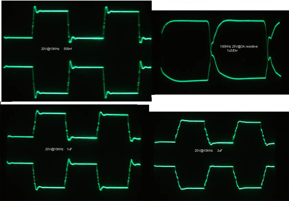

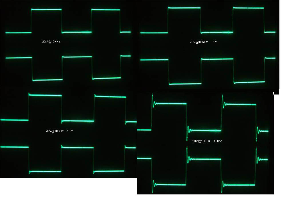

Anyway, I finally got around to doing a few cap tests....
BTW both output's are shown in each pic, 10V/Div. The two are added across the load. It is still a little ugly with significant capacitive loading, but the latest tweeks have made it a little better....
So it is moderately stable and fairly fast. Hmmm, now if I only had some real testing equipment.

Exactly forum members usually like GNFB to get the thing work and generate good THD specs on paper......only few alike us think distinctively.....The schematic looks so wierd just because of very low resolution......and congested drwaing.....I dont want to "jam" my eyesight to view it......already getting a bit of headache
BTW: You still need to learn how to draw a neat and clean schematic and how to display it on the net........
Your right, the schematic is hard to view, but it was drawn with the intent of helping me build and modify the circuit. If it was all on the computer, it would be too small to see the whole thing. Also I don't have a great electronic drafting program. That is why I just drew it out on a 76cmX127cm piece of cheap partially recycled paper. Not the best medium for posting on the net, but serves the purpose...old school style.
I may start laying it out in Eagle, just to get some of it entered. Layout is important as with any amp, but with circuit 'modules' and no GNFB, there won't be a NFB loop strung all the way across the PCB. I just realized the all 4 output devices cost $5.20. There is 4 THAT340 transistor arrays at $8 a peice.

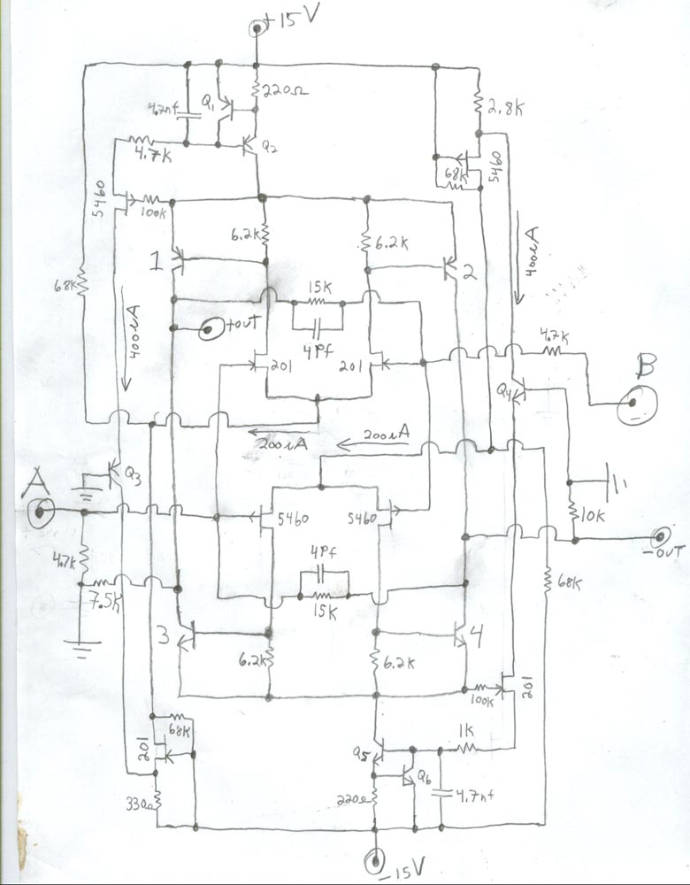

Hi
Not that many here are interested in no global feedback designs, but I have made a significant topology change to the first gain stage/phase splitting circuit. Instead of using two separate amplifier stages, I am now using a balanced bridge. So now I have a balanced bridge driving a balanced bridge.
I found the symmetry too be much better, faster slew, and fewer components. One would guess correctly that if you input a signal to just the + input, the + output will be larger than the - output, if the load impedance is the same on both sides of the bridge. This obviously will not drive both output's (VAS input's) equally and the circuit wouldn't have equal and opposite outputs. I found that it is the current, not the voltage that must be equal in the bridge. So by putting a 7.5K resistor load on the + output, and a 10K resistor load on the - output, the two output voltages are equal in magnitude. This makes the output impedances of this stage not equal, but they are driving the gates of the next gain stage input J-fets so it doesn't matter. That load is roughly equal to 2K in series with 5pF.
Transistors 1,2,3,4 are a THAT 340 matched array. Both input J-fet pair’s bias @100uA per leg. The 201 has a Vgs@100uA of -0.38V. The 5460 has a Vgs@100uA of 1.8V. This means that the circuit requires a DC servo input of +V on both DC inputs, A & B, in order for both outputs 0 VDC. 'A' is also the signal input as there is an input follower stage preceding this one. I do not find the common mode bias arrangement to affect the signal; rather perhaps acting as a form of EC. Since the circuit is actively biased and DC offset is corrected via DC servo, I have dispensed with the source degeneration on the J-fet's. It doesn't seem to be a problem. Sorry for the old school drawing, it is an excerpt from a larger drawing.
Now that I have installed an input filter, this is the quietest, fastest, most acurate amp I've made so far. You have to put your ear right into the tweeter to hear anything at all, and only in complete silence, when the house fan and the refridgerator compressor is off.
This I love, it helps that all inportant first watt of power...or maybe it should be the first 1/4W of power.

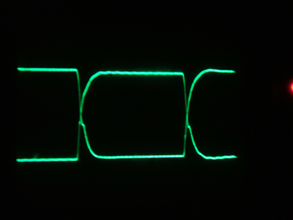

This is the new 100KHZ square wave 10V for each side, so 20V and over 2A RMS. 1uS/div. Other than that bit of crossover...
... that problem is in the output section... some tweeks yet needed there.
