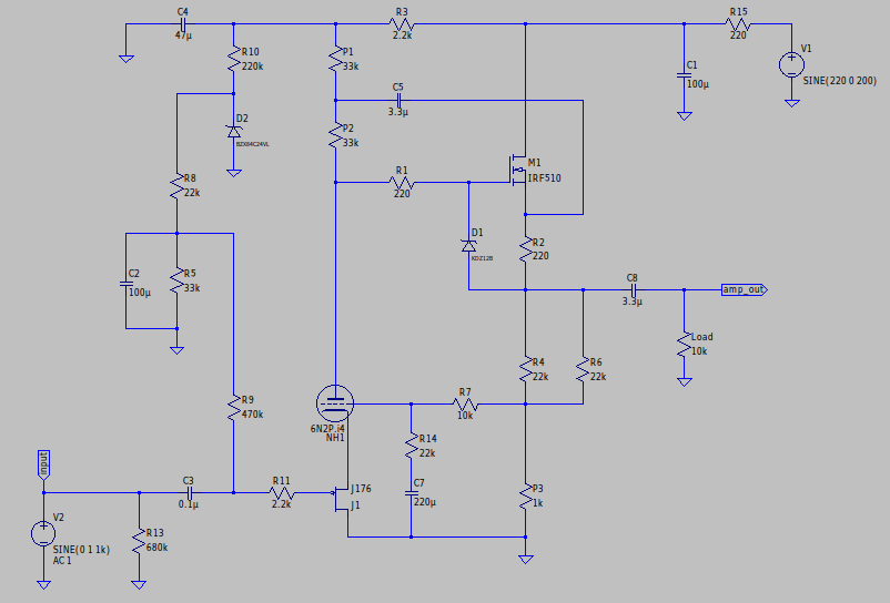

However, I am also considering another design that also looks quite good:
Distortion is slightly higher, but now is almost entirely 2nd harmonic. High impedance can also be had (scale R9) and feedback amount can be changed via R14.
What do you think about this circuit? It seems like it might be worth a try. Do I need and additional protection for J1?
Maybe the first amp circuit if better?
Also what is the best way to switch the bootstrap capacitor in and out as this drastically changes distortion and would be nice to compare while listening.
Any feedback is much appreciated.
I can attach ASC files if anyone is interested.
Slight improvements:
DC feedback has now been moved to the higher current output line, saving parts count and R16 dissipation.
I think this design will also be compatible with different tubes of the same pin-out as the bias can be set if R8 and R5 is a trimmer pot. Tube rolling fun?
There's also the fact that this is a non-inverting circuit, providing the correct phase (though its easy enough to swap speaker terminals) whereas the first circuit is inverting phase.

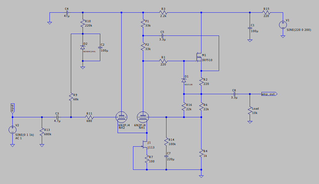

I want to use 2 tubes, one per channel (Yes my supply can provide the needed filament current). As these tubes are dual triode, perhaps I could use them in parallel for the above circuits? What would be the benefits?
I have simulated with a SRPP configuration but was not as pleased with the results as with the bootstrap.
Ahh on the preamp section! I thought you were looking at the power supply section. D1 is 12V (should limit current to around 40mA with a VGS of 4V) and D2 and 3 are maybe 16V as the preamp can be seen more as VAS as it is also deigned to drive a unity gain output buffer before the speakers.
Reactions: alain98
This also simulates well but it is pushing 4.8mA though tube NH2 which seems high, may decrease the life of the tube?
Also may need to test the JFET J1 for IDSS.
Also, I've just read that in the filaments 'warm up' period, it can draw 2/3x as much current!
This may be OK as the voltage will slowly ramp up, but I may need to increase capacitor C13 to provide a slow enough ramp to mitigate the warm up time.

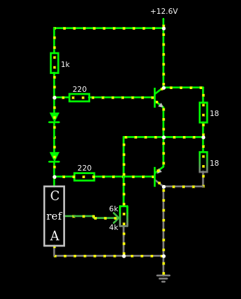

I have considered wiring in series but don't like the idea as one tube may hog more current than the other, I have considered a circuit to 'balance' the current:
A buck converter is another option, but I don't really like the idea of switching and potential EMF problems.

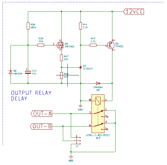

You can use non linear parts to limit output DC voltage at power on but a muting relay will have a benefit also at power off.

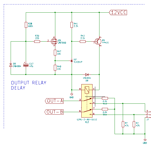

A relay delay circuit is on the schematic. R38 will be large enough for the required warm up delay.

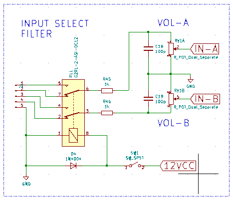

An input 100 kHz low pass filter is not luxury just as GND referencing of inputs.
The circuit for a basic input switch, low pass and volume control:

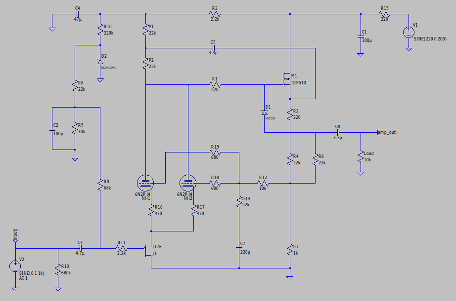

I'm leaning towards this circuit:
The zener is 24V.

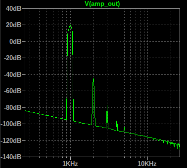

Each tube is at 700uA with a 151V plate voltage, higher plate voltage seems to bring down distortion.
This is the FFT at 15V (30Vpp) output (0.056% THD):
Seems like a good result and am thinking of designing some test PCB's.
Normally RMS values are used. BTW the muting relays contacts should be over the 47 kOhm resistors to GND otherwise they will always be in the signal path.
Would a 1 ...10 µF cap behind the MOSFET not be a better choice? Large value caps do not bring lower ripple at this spot.
Yes, I was thinking that.. This should be correct now:

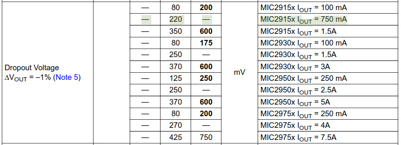

As for providing filament current, I think using schottky diode bridge rectifier to 12V LDO then to the 'balance' circuit (repurposed virtual ground) would be a smart solution.
A quick search and I found the MIC29300-12WT LDO TO-220 5A seems to be a suitable choice.
(Datasheet: https://ww1.microchip.com/downloads...urrent-Low-Dropout-Regulators-DS20005685B.pdf)
If I understand this correctly, I would only need only 220mV higher than 12V at 750mA for it to regulate properly?
