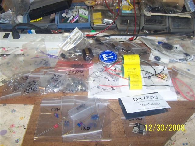

I purchased the 2900 on **ay for $175. When all was said and done I probably spent about $600 on upgrade parts using the best that I could afford.
I must state that most of the ideas came from lots of reading and even more help from the members here!! THANKS CHAS !!

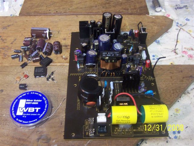

The Mods started at the Power supply which I think is the weakest point in the player.
Upgrades included, new hexfred diodes,BG capacitors, some poltstryrene caps, Auri caps for input coupling and larger inductors
The picture shows the new P.S. and the parts removed

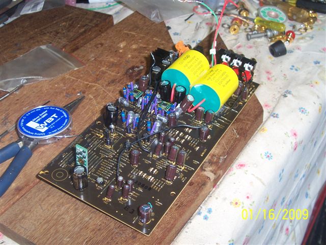

Next, I attacked the audio board. Before undertaking a modification like this it is imperitive that you obtain a service manual.
On the audio board I worked specificly on the main Left and Right channels. All critical electrolytic caps were changed to Blackgate type and and bypassed with .1NX HiQ. The film types switched to polystyrene.
Resistors in the signal path were changed to Riken carbon comps.
The output coupling caps switched from 'lytics to 10uf Auricaps.
The opamps in for I/V and filtering were changed to AD8620 and the output stage changed to opa627's on browndog converters(more on that later!)
I decoupled the 627's with .01uf +V to -V and with .1uf to Gnd on the +ve and -ve rails.

I came across some discrete opamps on a web in site in China called "Audio-gd" that seemed very resonably priced!!
So I took a chance and placed an order.
I payed via paypal on a Thursday morning and the opamps were in my hand on the following Monday morning
They have different "flavors" so I ordered a couple of different ones(the Sun and Moon) to try.
Here is where I ran into my only problem....
After I switched the opamps, the right channel was very distorted.Even after switching back to the opa627's .
After much headbanging it turned out to be a bad solder joint on one of the new Riken resistors. I reflowed the bad joint and all was good again.

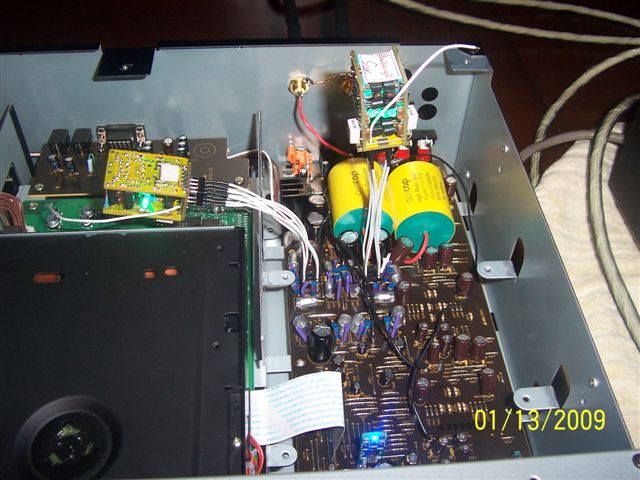

Since then I have replaced the voltage regulator for the DAC with a Dexa super regulator and changed the rca connectors to
Vampire's with DH labs silver wire for the rca's to the board.
I then used a "burn-in" disc that is supposed to help speed up the break-in period and help form the Caps.
Listening impressions range from WoW to Unbeleivable😀
I'm not good with all the adjectives that others use to describe the sound, however the quiet periods semm quieter and the impact and detail are greatly improved!!
I have about 10 hrs of listening so far, and I"m looking forward to comparing the different opamps and hearing the subtle differences that more time will bring!!
All in all a VERY worth while project and I think difficulty would be in the moderate range.
