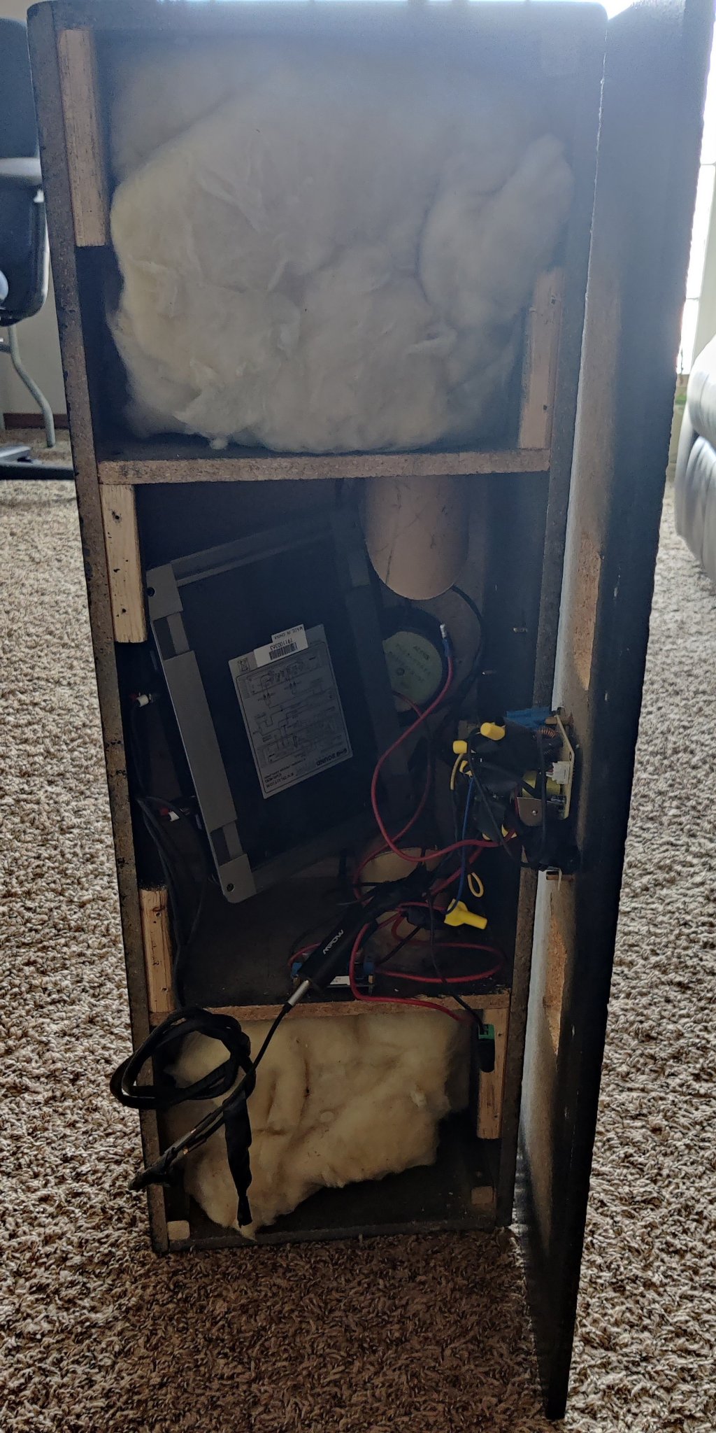

For the two full range drivers I ported using cardboard tubing, and then proved insulation in each speaker chamber. This came about after some trial and error and just playing around with what sounded better and reduced interference.
For the wiring like previously stated I used a car amp that allowed me to separate into left and right channel and also full range and high range. This amp was the second choice of amp I made because I had issues with several amp boards being overloaded due to wiring issues. The Arylic board I used I have done things with their products in the past and liked how I would get several input options: from Wi-Fi and Bluetooth to aux line in. In order to make this board work I used a voltage converter to reduce from standard ATV battery 12V to 5V. I encountered a number of problems from there, one of which was some feedback coming through the ground. I found a ground loop Isolator significantly reduced this problem to the point it is only noticeable at very high volumes.

What kind of crossover did you use? Did you simulated or measured the response? What are those weird ports inside? How did you calculate bassreflex size/length?

So, this project is me just getting into the designing and building and as such these question are mostly making me realize I need to do lots more research. With that in mind with the Arylic boards the company has designed a ACPWorkbench tool for windows in which you can adjust many settings like crossover. As for "those weird ports" I am guessing you are referring to the back panel; those square "ports" were from an early design feature that I since removed due to the problem of interference and feedback and have yet to cover; however, I am exploring a few creative options for them. Lastly as for the bass reflex calculation, I did not calculate, I played with design and what sounded good to the ear. Sorry this is a whole lot less technical then you were probably hoping for.What kind of crossover did you use? Did you simulated or measured the response? What are those weird ports inside? How did you calculate bassreflex size/length?

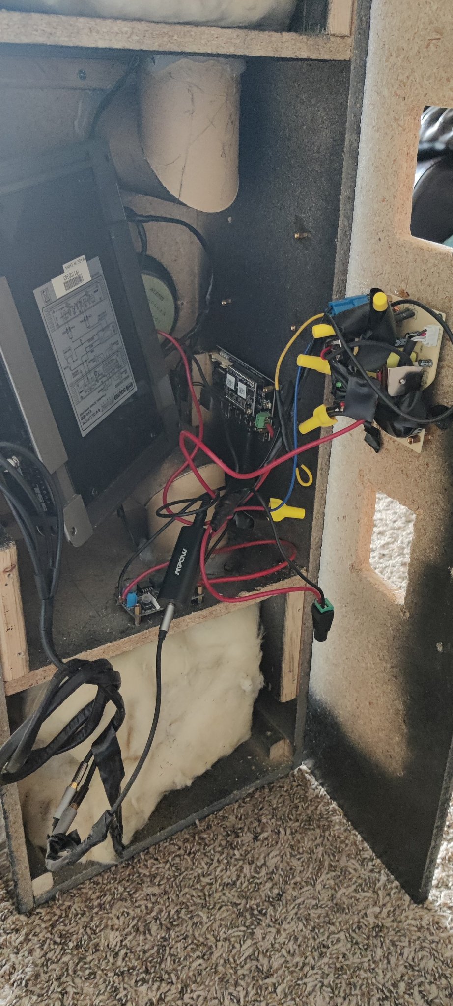

Great questions! For the battery I used a trickle charger to keep it charged (One can see it mounted to the backboard in my pictures). Then as I stated in my description, I used a voltage converter to reduce from the 12V ATV battery charge down to 5V for the arylic board. Then my amp was a car amp so it was made to run off of 12V batteries. Does that make sense?Hi there, It's so great to be able to use it with the battery. How did you connect it to the battery? And how do you play music when using it outdoors, without wifi or LAN? Does it support USB sticks?
