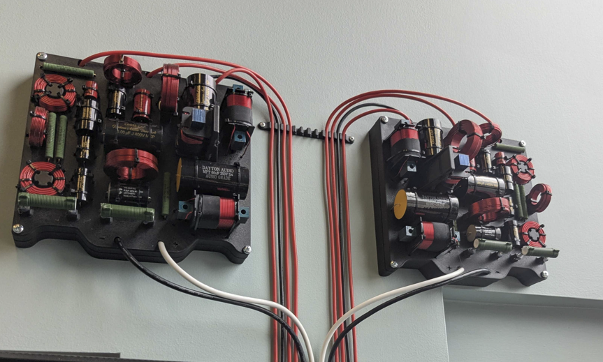

- I swear they pick their crossover points at random. Their crossover networks are pretty goofy

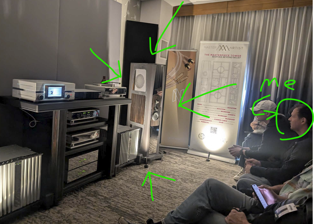

More Master Artist
These were the BEST speakers at the show. Unanimous. No question. The best. I don't even think this is subjective. Designer was in the room. There is over $10k worth of Accuton drivers and Xover components in EACH of these units. Endgame speakers. The BEST of the BEST.

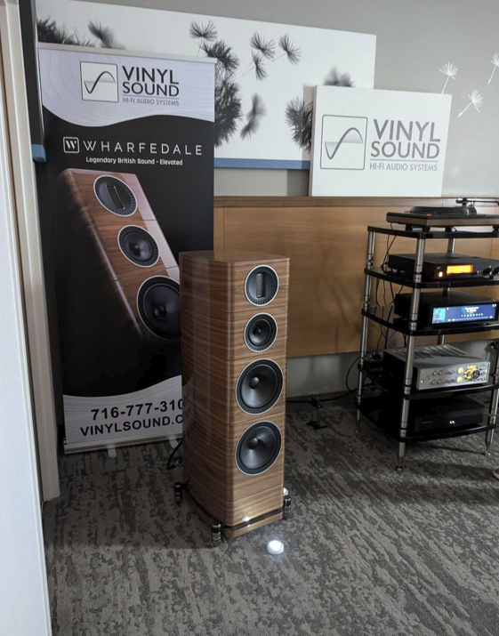

Wharfedale
Pretty basic except for the ribbon. The ribbon is exceptional. High were incredible. I asked about buying the tweeter alone and was told I could. He gave me a number to call to buy them. Probalby going to pair this ribbon with that PMC mid dome and maybe and Accuton Woofer for my end game speaker. Yup, I'm going to pull the best drivers from the best speakers in the world and make the ultimate loudspeaker. I don't even care how long it takes me to get it right.

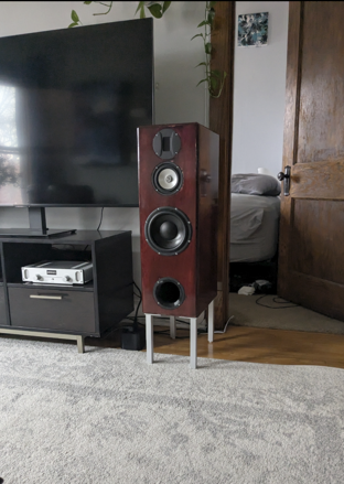

Alright, that was a lot. Now lets compare with two of my builds.
This is my 3 way I listen to every day. This sounds sweeter and more relaxed than anything at the show. Outside of the one using all the accuton drivers mine wins in our book. My bass is more dynamic. The mids are sweeter and more musical. The tweeter is tighter but not harsh like a lot of them. We all agree these are within the top 5 from the show. So how does it compare? Above 95% of the speakers there and it is being driven by a little 20w class A amplifier with a fosi dac/preamp. Not too shabby.

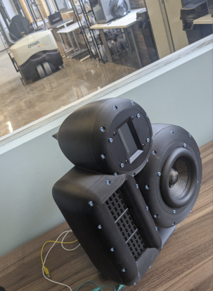

Lets do one more
This one might be a little unfair as it is designed for your head to sit right inbetween the speakers. This is the best one. Nothing beats this for silky smooth and dynamic everything. If I can manage to get this sound to fill a room and not just a 10 degree listening window, this will destroy everything.

I redesigned the HPM900 midrange crossover and woofer (none) to be phase and frequency aligned. These now will beat all but the very top end sounding (not looking) audiophile speakers. I put a new mosfet amp in 780, a tube preamp, new phono with sub filter, iphone smoothing circuit , and FM sound quality chip.
Now it sounds the way I like it. Full Soundstage, tube presence, sparkling top end when desired and great bass to 30hz.
Lots of work but worth it !!

Danville signal had an excellent AB comparison between traditional passive crossover Magnepans versus active DSP xover Magnepans. The DSP version was far superior.
Hey Perry! The reason the DSP version sounds "better" is that it uses different crossover filter functions than the passive MFG crossover, but this is not openly disclosed by Danville. So it is not all that surprising (and it is a bit of a ruse) because it is not an apples to apples comparison.
Surely the primary point of using a DSP crossover is to use the flexibility to provide a better crossover? Personally I would always assume a DSP crossover was closer to whatever the designer wants than a passive crossover unless it is explicity stated the DSP crossover has been designed to closely follow the passive crossover. Even then the nonlinear distortion of a passive crossover is almost certainly going to be absent. But I would agree with the comment earlier that a well designed passive crossover and a well designed active crossover should sound reasonably close unless the active crossover is being used in ways that are impractical for a passive crossover.
PS It's good to read write-ups like this even if one's views aren't that well aligned with that of the OP.
You could also design a "better" passive crossover I suppose. But, yes, DSP has much much more capability and flexibility than even a very good commercial passive crossover and can get the best out of the drivers, and potentially use them in ways that are not all that practical or even possible with a passive network. But active crossovers have their own drawbacks, too. I didn't intend to flame the old passive vs active war, only to point out that it would be more fair if the DSP and passive versions did the exact same thing WRT the driver outputs (e.g. filtering was exactly the same) and that you were judging each as to their sonic performance, which is what I think Danville is hinting at in their presentations. They are, after all, trying to sell you something!
So basically nothing changed since the '90s. Out of curiosity, which was the system preferred by the wife?
I agree that would be a much better demo.
