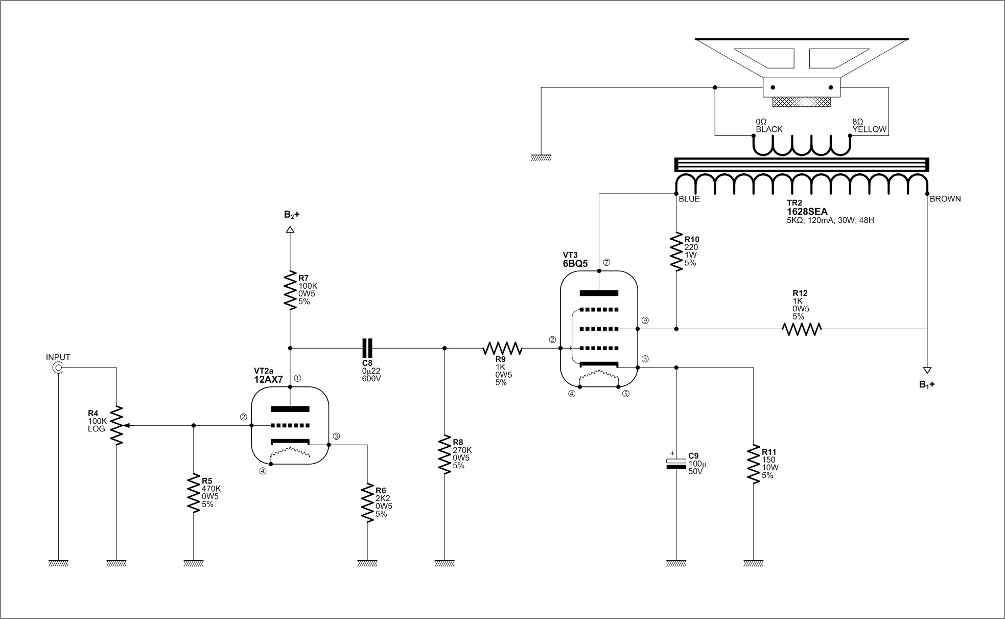

Well, after having aimed too high with an 845 Single-End, followed by a 300B Push-Pull, I concluded that I'm too much of a novice to be building such designs, so for my first ever tube amp project, I have decided to start small and easy. 🙂
I found a schematic for a 6BQ5 Single-End stereo design which seems straightforward. I have a few questions that I thought maybe some experts here would be gracious enough to provide guidance on. 😱

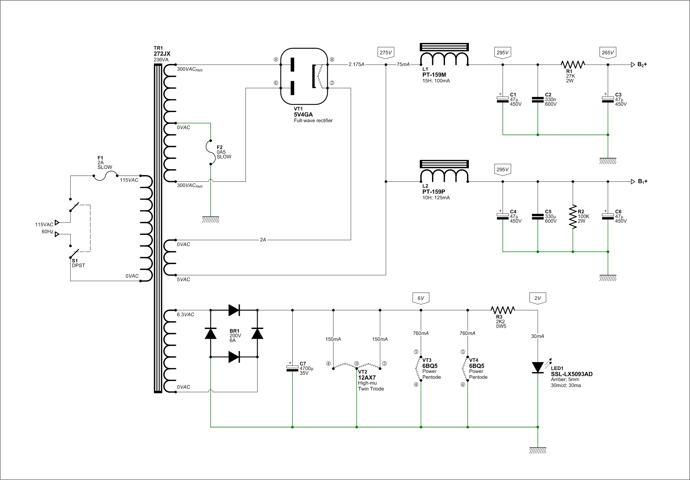

1. In the power supply circuit the 5V4GA rectifier tube was selected for its relatively long warmup time, allowing the other tube filaments to warm up before blasting their plates with the B+ high voltages. This is however a hard-to-procure tube, so what should I look out for in the circuit when trying to find a substitute?
2. For the amp itself, what kind of input is expected? Do I need a preamplifier of some kind, or can I just hook up a CD player to it?
3. What is the single-triode equivalent of a 12AX7, since I'd like to have a single triode for each channel instead of using one 12AX7 to drive both channels.
4. The 6BQ5 pentode can be wired as a triode, too. Why would I want to do this? Triode configuration offers less power, but will it sound better? Triode mode requires R10 without R12 and pentode mode is the opposite, requires R12 while R10 should be omitted, if I understood the schematic correctly. Can someone confirm this?
5. Does the output transformer have a polarity or orientation between the primary and secondary windings that I need to pay attention to?
Any other design suggestions for improvements would be welcome, I haven't turned on my soldering iron yet!
Many thanks.
Maybe I am a bit high from inhaling the paint I was using a little while ago but I would suggest another circuit as this one does not quite "gel" with me
but anyway I would keep it simple and use a pair of ss diodes instead of the tube rectifier. This thing uses a choke input design.
You can attach a CD player as is, the variable resistor (R4) at the front works as a passive volume control.
A single 12ax7 would be all you need, there are two triodes in each tube, one tube works for both channels. I don't know off hand of a single equivalent, if you really wanted 2 tubes then you could use two 12ax7's and just use one triode from each tube.
This is amplifier appears to be both triode and pentode connected at the
same time😱
R10 would be the triode connection and R12 the pentode connection. It cannot be both at the same time so you would have to add a switch to choose one or the other. Some people prefer "triode mode" some don't, with a switch you could have it either way. If connected as a pentode then you should ideally have a regulated supply for the G2 or failing that a voltage divider or failing that at least a decoupling cap on R12.
I do not understand the question but the transformer is colour coded and there are usually two wires for the primary (although this particular model has three wires the third allows an "ultralinear" connection), one blue which would attach to the tube anode and a brown which would attach to your HV supply.
The secondary connections are for the speaker connectors, usually black for negative and another colour for the positive connection depending on your speaker, yellow for 8 ohm speakers.
A 10W cathode resistor for an EL84 is more than overkill as is the 1628SEA for the output transformer.
Many thanks.
Your welcome.

1. This is to prevent "Cathode Stripping" which does not appear to be an issue at these voltages. It is a problem above 500V (IIRC). So you have the option of going SS for the rectifiers.
2. I am running a similar gain, and don't need a pre-amp. In fact I had too much gain (LOUD) till I added 8dB of GNFB. I think 6dB is probably a better value and I need to experiment with it still.
3. Not sure. Someone else will hopefully chime in.
4. Lower distortion in triode mode, but less output power as well. Yes that is correct on R12 and R10. Different harmonic spectrum as well.
If you are going to add Global Negative Feedback (which reduced distortion but also gain) you need to pay attention.
This schematic shows none so the transformer polarity does not matter.
6. That transformer is WAY over-rated. You only need a 5W transformer. I haven't done much work with SE amps so I'll defer to someone else on recommendations for an OPT.
Andrew beat me to it, I'm a slow typer.😀

1. There is no need to worry about the tubes getting B+ before they are warmed up, as long as coupling caps are rated for the high voltage. I also find your PS to be a bit overkill. These tubes do net need DC for the filaments, and smaller chokes will do OK.
2. You will have enough gain for CD input without a preamp, even if you should select to replace the 12AX7 with a 12AT7.
4. If you run the EL84 as pentode you will need some feedback. Otherwise it will have terribly high Z-out, and sound bad. Feedback can be global, or local anode-to-grid as in the RH84 amp (described in other threads).
Svein
Svein
Thanks for the tips, Andrewbee. My goal is to build an amp with as much "iron" and "glass" as possible and to lay out everything symmetrically. Even though this goal will probably be realized when I work my way up to a big 300B design or an 845. I want to keep the tube rectifier. If the 5V4 is too scarce I'll try another design.
You are correct that the schematic as is shows both the triode and pentode wiring, one or the other will have to be removed in the final construction. I didn't think of installing a switch, good idea, this way I can hear the difference!
For the output transformer then, the primary must be wired blue to plate and brown to B+, ok, got it.
You are correct that I over-indulged with the output transformer model, since a Hammond 125CSE would do just fine, but I wanted the enclosed type since it is meant to be exposed and the 125CSE as far as I can tell is an open-bracket type. The power transformer and the chokes are also more beefy than the orignal design called for.
Hey thanks for that link to those circuits, I actually own most of the Led Magazine issues from issue #118 or so, and now Electronique Pratique which has taken over. Those guys put out a large number of designs, but I always had trouble understanding all the details (they're in French), and I won't commit to building anything until I am 100% sure that I understand it all first.

>3. What is the single-triode equivalent of a 12AX7, since I'd like to have a single triode for each channel instead of using one 12AX7 to drive both channels.<
6AV6 is a rough equivalent (µ=100), in a 7-pin base, with two diodes to boot (just tie 'em to the cathode). I agree with other posters that you're better off using one 12AX7 bottle with one triode going to CH-1 and the other CH-2. One less tube socket, half the heater power (12AX7 heaters in parallel = 300 mA; two 6AV6s = 600 ma). Plus, the 6AV6 isn't as hum-resistant as a 12AX7-A (or a 7025). But 6AV6s are cheap. And you're running the heaters off DC, so hum isn't a big concern; dunno if that's really necessary in this instance, though -- and with no regulation, you're probably gonna get a bit more than 6.3 VDC from that heater supply.

OK, I see why they chose an over-rated transformer. I suspect the reason they chose that transformer is the frequency response.
What quality sound are you shooting for?
There are several OPTs you could use.
Edcor XSE10-8-5K limits frequency response to 70Hz - 18KHz. GNFB may improve this slightly. Inexpensive at $17.22 plus shipping.
Edcor GXSE10-8-5K slightly better freq response at 40Hz - 18KHz. Again GNFB may improve this slightly. Slightly more at $26.10 plus shipping.
Edcor CXSE25-8-5K slightly better freq response at 20Hz - 20KHz. Again GNFB may improve this slightly. Slightly more at $83.50 plus shipping.
Hammond 1628SEA 20-20KHz, $129.10 (AES).
Hammond Universal SE 125ASEA (25mA 3W) $49.65 (AES) Probably too small 100Hz-15KHz.
Hammond Universal SE 125BSE (45mA 5W) $50.45 (AES) 100Hz-15KHz.
You can replace the 5V4 with a 5U4GB. It's a large signal, dual diode with characteristics very similar to the 5V4. The main difference is that the 5U4GB is directly heated. I used the 5U4GB in a project when I needed to drop about a hundred volts to get to the design nominal DC rail voltage with the power xfmr I had on hand. Replacing hollow state diodes with solid state is likely to lead to serious over voltage.
Looks like there is more than enough gain for a CD player
The 6SF5 is a singleton triode that's a near equivalent of one section of a 12AX7. (if you can find a 6F5, it's the same tube internally, but with a funky grid cap connection.) This one has a metal envelope, and requires an Octal base. There aren't very many singleton triodes in either seven or nine pin mini format.
Triode connection will definitely give less output. However, it just might be better sonically in this design which does not include any NFB. Pentode operation without NFB can lead to lots of nastiness, sloppy bass due to woofer underdamping, and poor bass due to a lack of OPT primary inductive reactance at the low end of the audio band.
None whatsoever. The OPT winder has no way of knowing whether your design will include an even or odd number of gain stages. Therefore, no way to predict phasing at the primary.
...Feedback can be global, or local anode-to-grid as in the RH84 amp (described in other threads).
I've always been intrigued by the RH84 amp, and hope to build one some day. There's a few threads on it around here:
http://www.diyaudio.com/forums/tubes-valves/141434-building-rh84-se-tube-amp.html
Cifrocco, your schematic looks way over-engineered for a 6BQ5. But if you build it and like the sound, some of the iron would probably be up to putting a real triode (2A3 or 300B) in there.
If you want to start simple and inexpensive with a 6BQ5, the RH84 is a good one for little money. I built one here using cheap console output transformers and simple SS rectification and it worked nicely (until I stole the 6BQ5s for another project).
There are tons of circuits around for the 6BQ5 (English name is EL84, Russian equivalent is 6P14). It is probably the easiest output tube for beginners to work with, which is why there were so many consoles of the 50s and 60s that used them.
