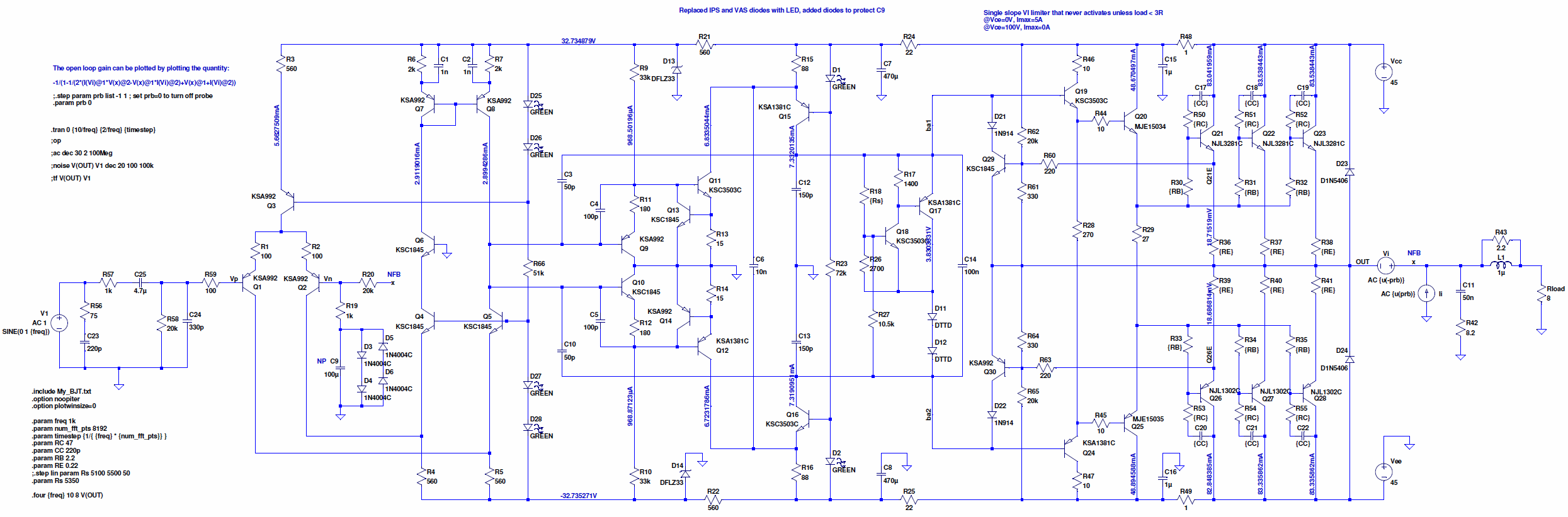

I finished reading the 2 books from Cordell and Self lately, will need to re-read both a couple more times, but I think it'll strengthen my understanding by an actual practice, so here I am with my first attempt to design an amplifier.
  • It's a classical LIN type of topology, naturally as that's what the 2 books are about;
  • I want to try something slightly different from a standard Blameless, so I've taken a push-pull VAS published by Samuel Groner couple years back, and bundle it with a EF3 from Cordell's book;
  • Target: 100W into 8R, 200W into 4R, 26dB close loop gain, simulated performance similar to a typical Blameless;
  • I hope it'll end up as something useful in my living room and sounding alright, instead of a giant oscillator busted into flames, so I've targeted conservative phase margin and gain margin. I also included VI limiting for more protection.

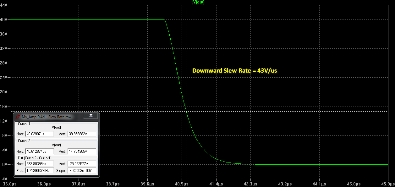

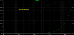

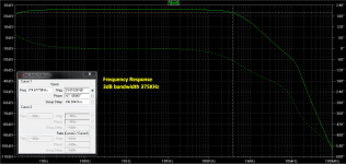

Attached are the schematic and some simulation results. In terms of simulated THD, figures are:
  • THD1K@8R: 10.2ppm@1W, 10.1ppm@10W, 10.0ppm@100W
  • THD20K@8R: 9.7ppm@1W, 23.9ppm@10W, 16.0ppm@100W
  • THD1K@4R: 10.1ppm@1W, 9.9ppm@10W, 9.6ppm@100W, 10.0ppm@200W
  • THD20K@4R: 31.4ppm@1W, 40.0ppm@10W, 33.1ppm@100W, 46.7ppm@200W
I believe these THD numbers are OK but not great, especially when sub-ppm designs are widely available in this forum. I was excited by some ppb level THD1K numbers with the circuit at some stage, but when I added safety features like zobels at the OPS transistors, base stoppers, feedback DC blocking capacitor ... etc, the THD degraded to the above at the end. I tried to mess with TPC, TMC and OIC to improve the performance, but trial and error didn't get me very far and I ended up sticking with Cdom compensation. Anyway, my novice construction skill will be the limiting factor of any actual build, so I decided to settle with these THD figures for now.
I have an IT background so I'm fairly technical, but I knew very little about electronics when I started this DIY hobby a year ago, so many of these things are entirely new for me. Hence, it's quite probable that I made a few mistakes somewhere, so your comments, corrections and suggestions are really welcomed.
Thanks and regards.

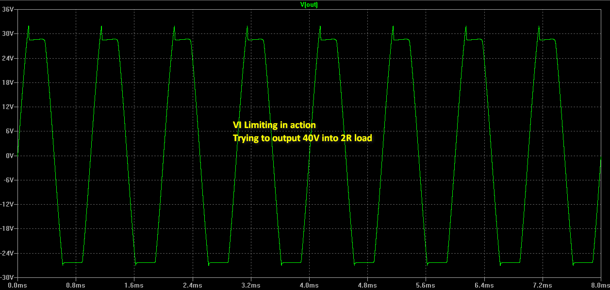

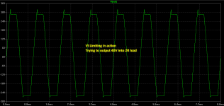

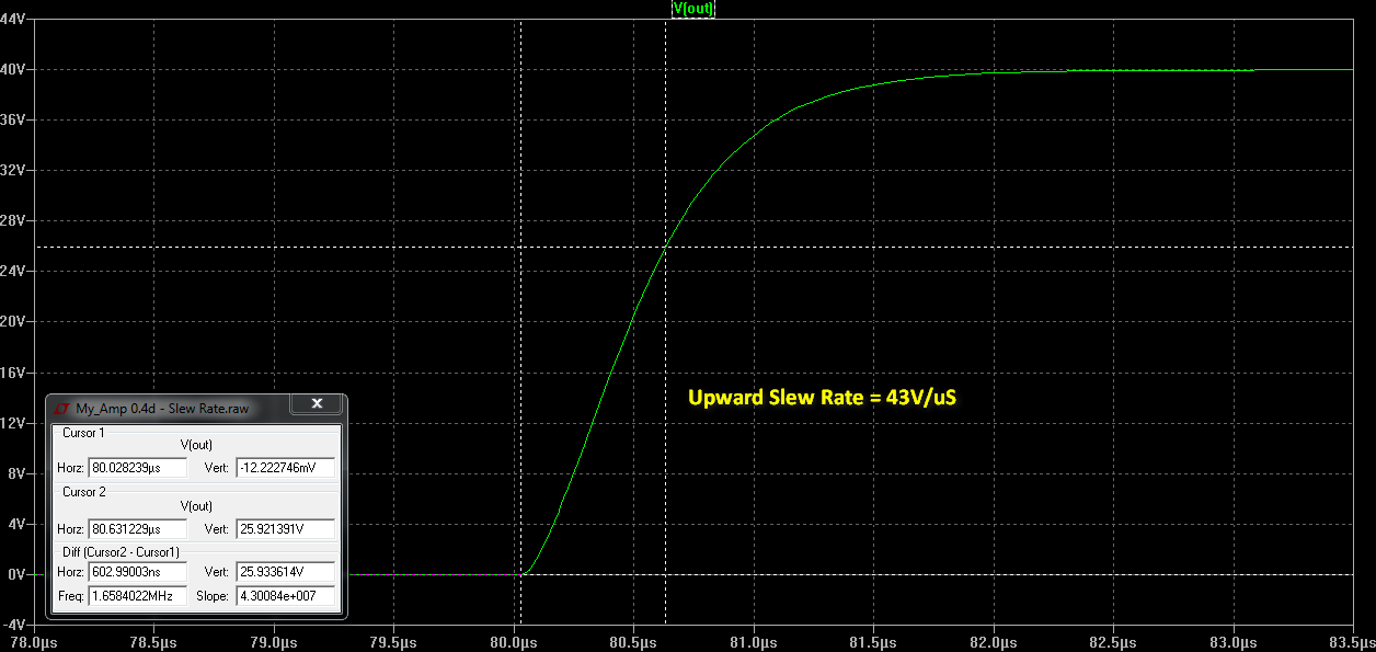

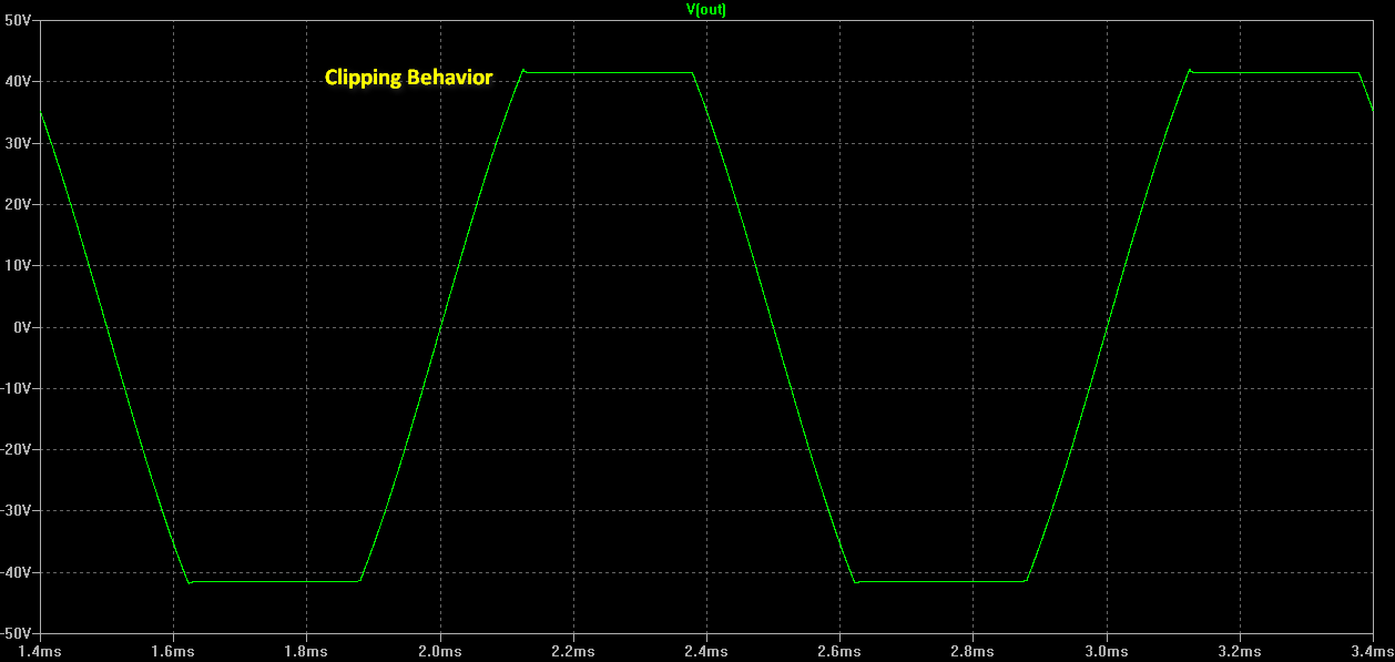

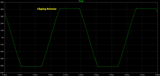

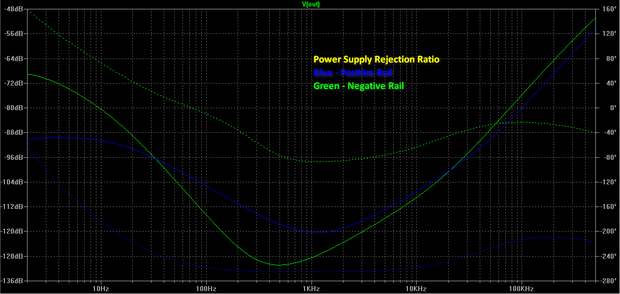

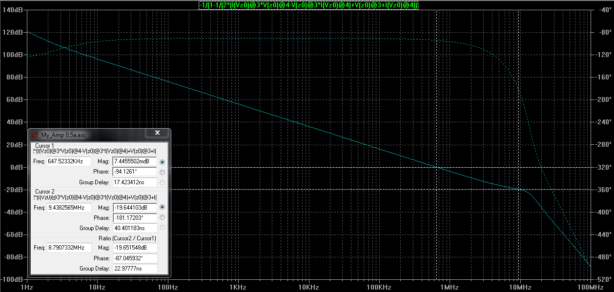

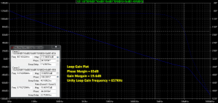

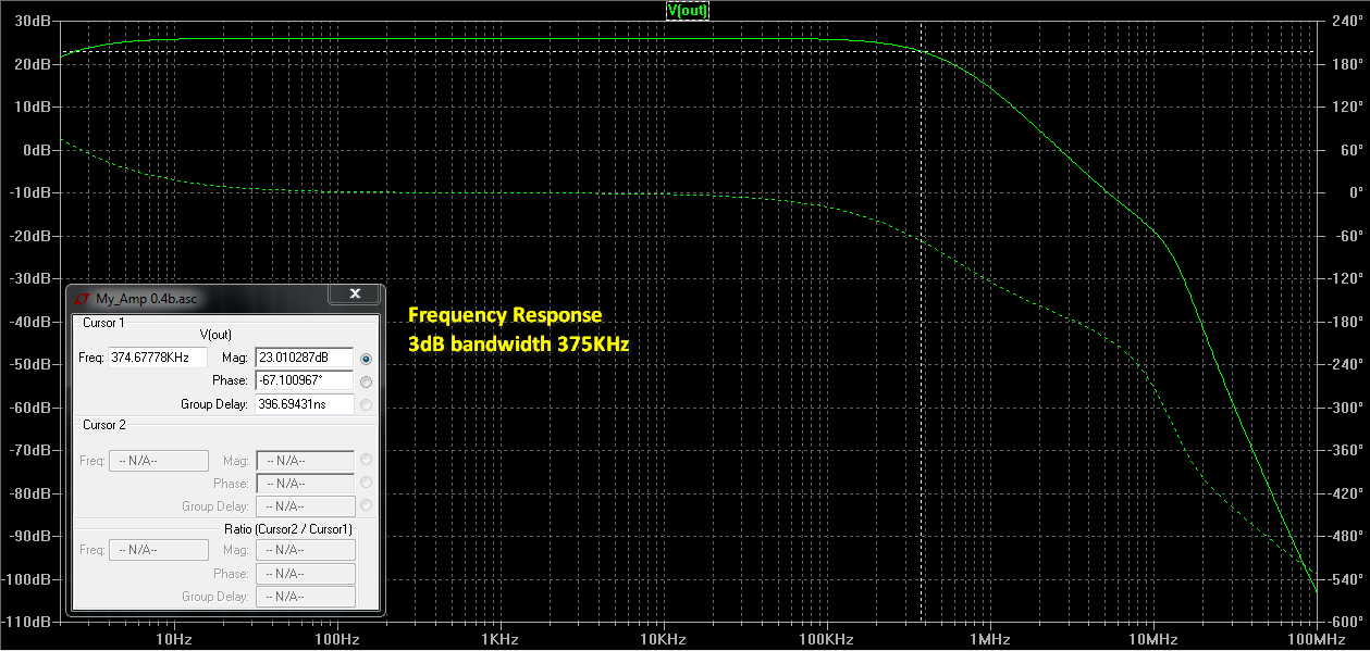

Hi Guys
Some really nice plots there.
In practice, the 1uF supply bypass should be increased a thousand-fold, a bypass should be added for the output stage, and the zeners should have caps across them for the input stage. Zeners tend to be noisy.
The 100uF cap in the feedback loop is way undersized. It is contributing significant THD to all numbers. Same with the input cap. usually for simulation, those caps are left out to be able to assess what the active part of the circuit is doing. There has been enough independent study made about capacitors to kiow the range of values and dielectric types to use in the various circuit points. For example, an electrolytic is fine in the feedback network provided it is not used to shape the low-frequency response, i.e.e it should be several millifarads. The input cap should be polypropylene not polyester, as the latter introduces significant third-harmonic THD where PP does not.
You should try a sim using a standard up to date Lin-Thompson front endjust for reference. It is pedestrian but exhibits very good performance. When I first started learning to use LTspice, the Lin gave best performance but my favourite circuits are fully symmetrical. I now have the latter outperforming the Lin. I'm sure you will achieve the same end with your circuit with a little persistence.
Have fun

-4- Achieving ppm level THD is not easy in reality - though simulators will make all manner of promises. Build a prototype and measure the THD - the measurements alone I promise will challenge you.
(OPINION WARNING HERE: I challenge you to hear the difference between 1 and 10ppm, probably 100ppm and maybe even 1000 in some cases).

Thanks googlyone, all wise words and I actually agree with most (if not all) of what you said.

I am very much of the same opinion so if I may comment.
Most of the ultra low distortion simulations are very suspect so I would not be too disappointed if your amp does not reach that level.
But if the objective is only, say 10 ppm then you don't need that much complexity.
To be more specific, you have a second section composed of an EF assisted VAS plus folded cascodes. That's a complex loop to wrap compensation around.
You should place a Tian probe within this loop to check stability.
There's more to stability than the one loop you have checked😉
Also the push/pull schemes are vulnerable to surprises if the two sides do not match perfectly.
Very easy to miss this in simulation, since the values will all be perfect.
You need to check this manually in LTSpice, try the effect of imperfect matches for transistors and especially Miller capacitors.
Bob Cordell touches upon this but does not emphasize it, he often uses other methods to avoid the problem.
Best wishes
David

You will need also to check stability as the amp approaches the rails, with an OPS, in both simulation and reality.
This has a major effect, as do difficult loads so they need checks too.

I believe going after the lowest THD possible is a must if you want a transparent circuit. There are natural distortions of sounds we hear but those generated in electronics are quite a different thing and need to be minimised as much as possible. No one can tell you how accurate spice will be compared to the real circuit, since there are too many variables and too many assumptions built into both the models and the sim algorithms. Simpler circuits seem to sim faster and real measurements corroborate performance. More complex circuits take longer to sim and tend to deviate more from the real world.
Were you to assume that the sim is off by an order of magnitude being too optimistic, then a 100ppb becomes 1ppm, which is below the resolution of an Audio precision system. This fact does not make the distortion inaudible. It is incredible what our ear is sensitive to. You will be thrilled to have a working circuit with 10% THD but it will quickly lose its luster once you live with it for a little while, especially if you listen to music that is "busy" in the midrange. The guys who like those single-mosfet amps and other similar circuits tend to listen to rather spacious music. I found the JLH to sound dreadful with any kind of modern music, but low-THD amps sound much better. Everyone has their own take on this.
As the poster above said, wiring and layout errors easily swamp the inherent performance of the circuit. Generally, if the board is laid out as the schematic is drawn, assuming a properly drawn schematic as your are, then the performance of the circuit will be pretty good. A convoluted signal path guarantees instability.
You might find the THD is lower if you take out the middle part of the circuit and use a conventional bias circuit driven by the VAS. This will allow optimisation of the idle condition for lowest THD. The current sources used are not the best ones - the feedback type is more linear. Personally, I am not a fan of circuits where the audio signal is holding off the output stage, as here. Pull-up/down is limited by the current source. Signal-driven pull-up/down provides as much drive as is needed for any load and any device set.

... That's a complex loop to wrap compensation around ...
Thanks David for your various remarks, very useful. I'll check this loop, it's not immediate obvious to how me on how to check the inner loop stability, but I'll do my homework to try to figure out first. (As I said many of these are new to me - it took me a good night of Google searches to learn how to plot loop gain with the Tian probe in it's basic form, and I still haven't figure out how to use a GFT probe). I might come back with a question in case I'm stuck.
From an engineering perspective, this VAS is probably unnecessarily complex for what I'm trying to do, but I selected this VAS cause I think it'll lead to more learning than a standard Blameless architecture, from this perspective it's probably a good choice ... another VAS I considered is the SuperTIS, but it's way too advance for me and I might try that when there is more knowledge under my belt.
...I'll check this loop, it's not immediate obvious to me on how to check the inner loop stability...
Or to most people😉 Two factors for this.
For a simple Miller compensated amp the inner loop is usually stable, so there are usually no problems even if full checks are not done.
So most people are a bit careless but you should not be if you want to try less conventional circuits.
Secondly, a push/pull amp is more difficult to check stability in the inner loop.
Requires a balun, I posted one in the tread about Paul's "lunch-break" amplifier.
You are welcome to copy it and use.
Dr P J Hurst has a nice article about this on the Web, recommended for a technically minded person like you.
Best wishes
David

Just a few notes so I don't have to remember them for next time.
Samuel (and you) have the current mirror capacitors C1 and C2 equal.
This is such an obvious choice that it is easy to miss that is a choice.
But I tried this in a conventional current mirror loaded LTP and found I could do better with non equal values.
When you think about it, the two transistors are connected quite differently so it's not actually obvious that equal values are best.
Not sure it's applicable here but worth a check.
Your bias spreader is a CFP, these are notorious for local loop instability.
Probably not worth the risk for a first build (and possibly not ever).
I recommend an impedance compensation resistor as discussed in Self and Cordell. Should have most of the benefits of your CFP and practically no down side.
The capacitors C4 and C5 are described by Samuel as feed forward compensation.
I have never analysed this feed-forward but I suspect it's like so called "Transitional Miller Compensation", both in the essential mechanism and also in the fact that the intuitive explanation can rather mislead.
So, careful simulation is called for in this loop I think.
Best wishes
David

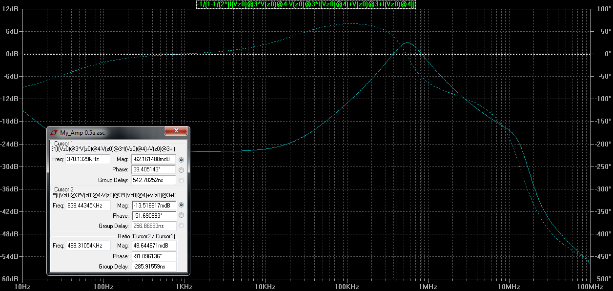

Without understanding how it works, I've taken the probe from Paul's file and insert the probe at similar positions. Got the attached result - doesn't seem right to me, so need to experiment more with it.
You need to remove the AC source at the front end of your amp. This interferes with the tian probe. The plots look much nicer once this has been removed.
Need to have a think about the probe placement... It's all still relatively new to me and thinking takes a long time.
Paul
... would it be possible to add the model definitions to the .asc file as an spice operative? ...
Certainly 🙂, attached. I removed the AC source and the plot looks more reasonable now, at the same time it looks remarkably similar to the outer loop, need to think about what that means 😕
