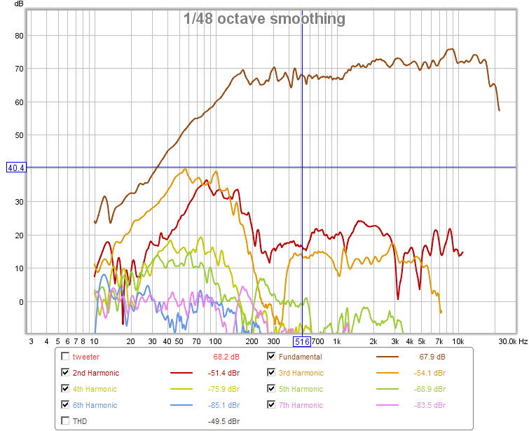

Lorepeo, here is a graph to give you an insight of why freq of 250/300hz is often choosen to cross over full ranger and sub. Driver is Vifa Tc9fd, a popular 3.5" full ranger.
http://www.diyaudio.com/forums/atta...erformace-testing-platform-hd-tweeter-raw.png
The plot represent freq range and below that distortion level for differents harmonics (2,3,4,5,6). If you look carefully you'll see that once you are below approximately 300hz distortion level start to rise dramatically. This is somewhat typical of small drivers and 5" does exhibits more or less the same behavior. You should notice too that spl level is quite low (around 70db past 1khz... probably with 0.25watt input for these measurements) and as power increase these figures will too and probably for the worst (and maybe in a non linear fashion!).
As you can see on the freq response graph there is no clues about that. But if you listen to the driver you'll hear that.
If you cross your sub at approximately 300hz distortion for the full range will be kept at minimal and your sub driver distortion should be low too. Overall the sound will be better that your full ranger playing 'alone' and 'really' full range.
Thats oversimplified but it's just to explain you one of the reasons this cross over choice of approximately 250/300hz for fast and why it could give better end results (at least when used as direct radiators drivers).

My doubt was born by reading also this forum

But if you suggest me that best cutoff frequency (for "my" kind of full-range) is around 300 hz also in a configuration that is not a normal two way speaker but a full range assisted (as less as possible) i'll do it in that way.
Some full range speaker for example has higher minimum frequency and smaller xmax (fostex fe126en xmax 0.35 mm and min frequency to 83 hz).
Now it determined that the best cutoff frequency is around 300 Hz, there i answer you:

Just a comment.
I find it fun and interesting to get max out of just one driver. As long as you dont expect to play very loud it is amazing what you can achieve.
One of my latest projects:
http://www.coolcat.dk/bjoern/TABAQ_MICRO_for_W2_803_SM.pdf
Hi
Bjørn
Hi
Bjørn
