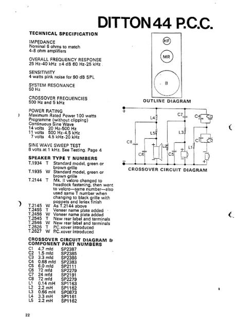

Crossover mods are not totally straightforward. Replacing non-polar caps with film types make a speaker brighter. Often you need to add a little resistance to compensate. I would think the mid particularly would benefit from better air coils. But again resistance might be significant.

Also have disassembled one of the filters, extracted some capacitors, but can't identify the type, maybe someone could help please?
1 - Seems to be a bipolar capacitor, unknown dielectric material. Markings are "ELCAP - 72uF -50v - N.P" I think "NP" stands for "non polarised" but would love if anyone could confirm.
2 - Im a bit lost with this one. Also seems a bipolar type, but the band in one of the sides keeps me concerned it may be a polar one. Also unknewn dielectric. Markings are "ERIE A304 METALLISED 2.0uF 150V DC WKG 74/46"
3 - These ones seems a traditional electrolithic capacitor, but apart from the band no other sign is showing me polarity, all electrolithics I have seen had a minus marking on the cathode. need confirmation on this subject please. Markings are "24uF 25VDC RED WE 99RAS 8 75 8" the red one got "CCL 6uF 50v REV WG 75 CRAS MAR 73"
