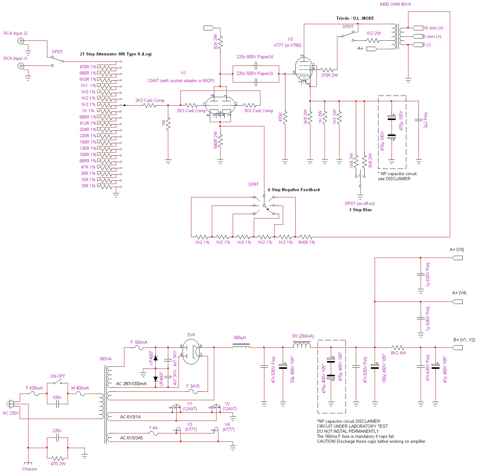

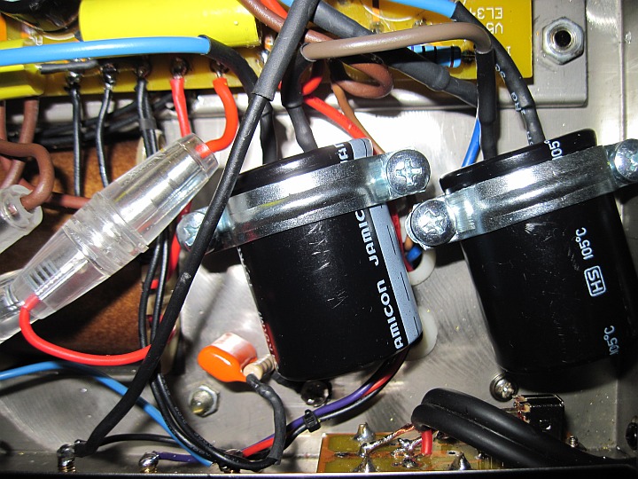

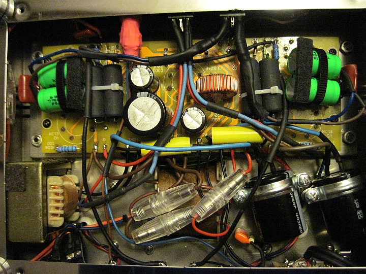

Nearly all of us spend our lives searching solutions for an elusive Holy Grail of the amplification, but this time I can say my Holy Grail found!
This is the second time I'm using NP capacitors across DC power supply with excellent sonic results in a DIY amplifier: the first time some years ago in a solid state headphone amplifier, and now in my tube amplifier.
But today is different, since the working voltage is ten times higher than in SS amplifiers. Thus, please take this just as an electronic reading and do not test by yourself (disclaimer): I'm already testing, I'm still alive and my house is not burned yet...
Non-polarized electrolytic caps have the same basic construction as polarized, except they use two anode foils with the electrolyte saturated separator interposed between, rather than an anode and a cathode.
Two normal electrolytic (polarized) 470µF 400V capacitors in series back-to-back (negative-to-negative) will work as a substitute.
Two identical electrolytic back to back capacitors in series halve the total capacitance, but won't give double the voltage. With voltage across the pair, one will act as a cap while the other as a short. Thus our 470µF/400V plus 470µF/400V series returns a 235µF/400V NP capacitor.
It would be best to add diodes across at least the capacitor connected to ground in order to prevent reverse powering as electrolytic caps can withstand some reverse voltage, but not too much. If we apply reverse voltage, the insulating oxide layer un-forms and current flows, the cap heats up and generates gas. Now the only reason for which current can flow in either direction is that the separator is wet, and that wetness dissociates into gas. It's the gas pressure that blows the capacitor. Large ones often have a pressure vent - if they don't, they can explode with some violence. But adding those "safety" diodes made the circuit too much non-linear, and in fact sound gets immediately worse, as it was before adding the back-to-back caps. Thus, after some listening tests, I left the diodes out and, anyway, till now everything is working very quiet without them.
What is important is not so much the duration for which the cap sees reverse voltage across it, but rather the total number of electrons that leak through the cap in the reverse direction: as long as you keep an electrolytic capacitor reverse-biased without drawing much current, all is fine. However, when you have two back-to-back, the forward-biased capacitor prevents a prolonged DC current from flowing. The 160mA fast fuse in the circuit is mandatory, as the forward-biased cap could fail short or increase too much the leakage current in the near future. Usually, as they are new, IL<0.02CV, so in our case is about 3mA, which looks safe to me.

How is this different than anything else if it's just bipolar caps connected to ground? Just a little distortion?
Why do you still have other capacitors in there?
Joined 2009

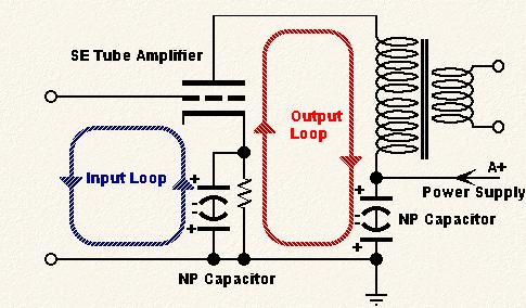

The diagram shows a typical SE amplifier with transformer output. The caps are in the usual places, but they are non-polar electrolytics. I've used NP caps in SS amps and found them very good. Never tried them with tubes though.
The other electrolytic polar capacitor was already in and acts as DC reservoir capacitor after the chocke. I doubt that the back-to-back cap could do this properly. Thus I left it in the circuit. I didn't test without it.
The additional back-to-back NP big size capacitor acts as favourite path of AC signal.
The smaller NP polyester capacitors acts better to bypass HF/RF signals.

WHAT AC signal? This filter is after the rectifier, so you should have nothing but positive going pulses.
To do science, did you try installing a plain old polar cap in the same position of similar value? In other words your difference might be the increased capacitance, not the bipolarness.
Joined 2009
the signal AC is what flows through the cap after the rectifier. The signal current, like any other, has to flow in a loop. What signal current flows through the tube and output transformer must complete a loop through the power rail decoupling capacitor and cathode capacitor.
