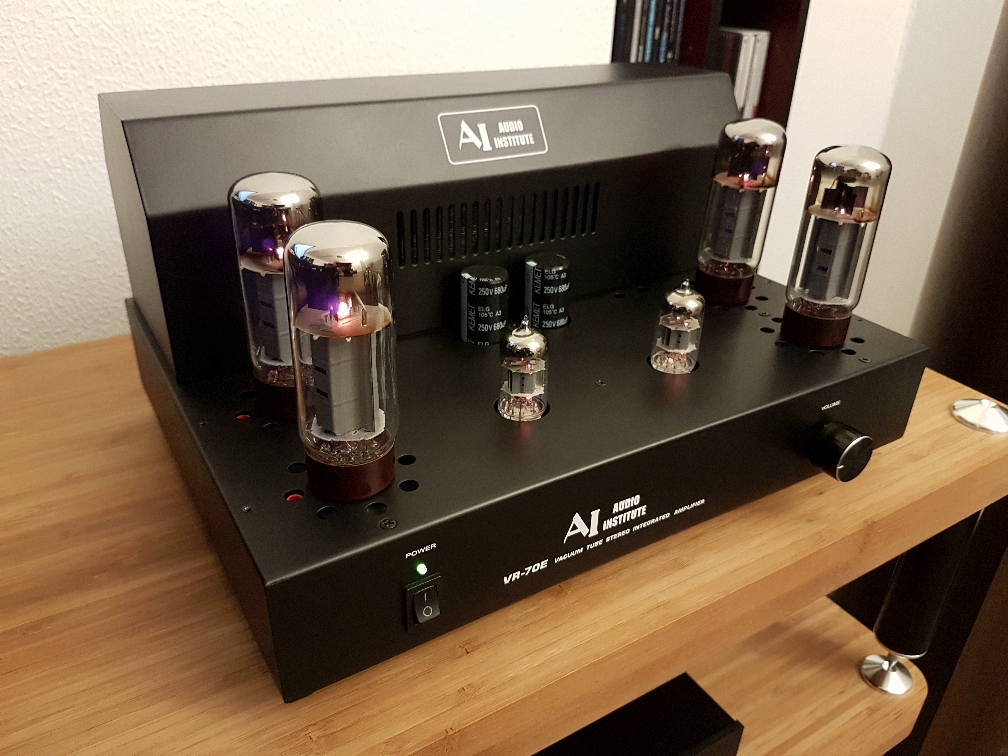

This topic I've made to present my way of modification of not expensive, PP class A Audio Institute VR-70E Amplifier, however if there are any Dynavox VR-70E owners, considering / planning any mods as well - both units are the same build, probably comes from the same, Chinese factory. The only difference are:
Audio Institute vendor "Affordable Valve Company" was (perhaps still is) located in UK;
Dynavox vendor "Dynavox" is located in Germany;
Description on schematics & PCB is a bit different - eg. same C7 cap in Audio Institute was C26 in Dynavox as far I remember.
Hope someone like it, as I do. That much, so I found myself some potential to use there. So like the others, who done their steps to improve the sound.
Was it worth it? Absolutely. Worth every penny I spend on it since I bought it 🙂
This is the photo on how it was look like on the day of arrival to me. By the way that was also the last photo where it was look like that:

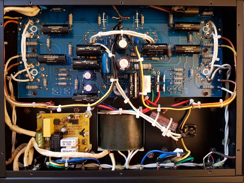

Here we go again 🙂
Sorry for a bit delay, being busy at the moment.

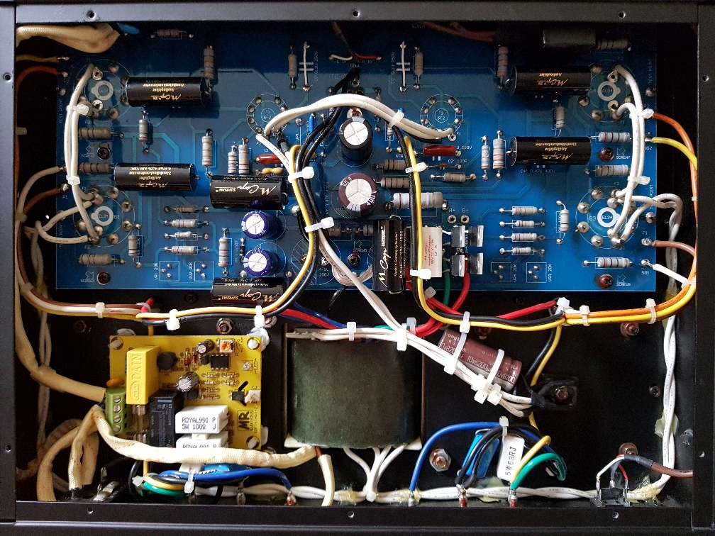

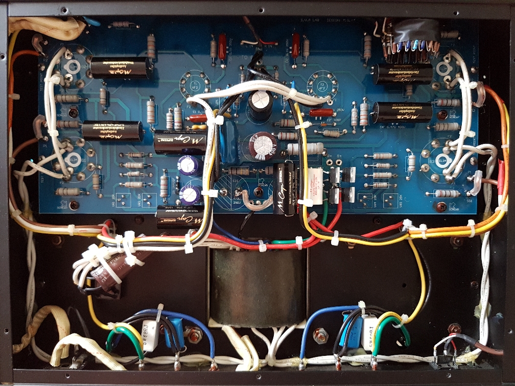

After small, first step (removing input Caps) I was advised to do some changes in power supply.
Replace 2x 470uF 250V Capacitors with 2x Kemet 680uF 250V. Those Caps actually are seen behind 6NF2 Valves. Kemet Caps are bigger - fortunately in length. As they coming out through the top they doesn't obstruct with anything else.
On the photo below you can see how they look - old caps are half size of them:

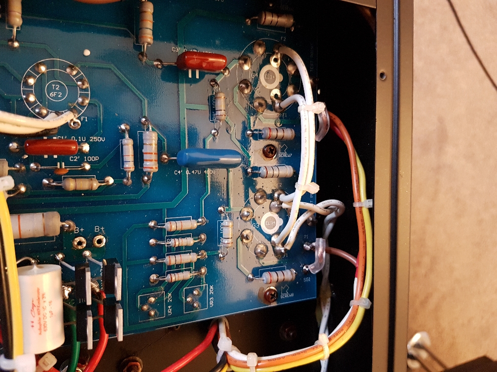

70V circuit - adding parallel Mundorf MCap Supreme 0.1uF 1400V next to C24 & C25 220uF 100V caps factory fitted there.
More changes in 420V circuit.
Stock Rectifier Diodes replaced with extremely fast switching Wolfspeed Z-Rec 1.2 kV, 10 A, 11 nC Diodes.
Both helping guys foud that B+ wires are soldered on PCB in the worsest possible place. Right after their suggestions both wires been soldered to positive pole of C21 Cap.
C8 0.47uF 350V Filter Capacitor residing there been replaced with Mundorf MCap MKP 1uF 630V + parallel Mundorf MCap Supreme 0.1uF 1400V
Quick thoughts after power supply changes. Sound became yet more open & airy. Also been better detailed with much less distortion. Smooth. Nicely smooth 🙂
The Amplifier having now quite better ability to drive speakers, bass kick became faster, punctual and more accurate. Faster beats became more recognisable in music, lower frequencies just gets more pleasant.
Soon after those changes I've get rid of negative feedback Caps (C5 on PCB) and used Charcroft Audio Silver Mica 47pF 500V Caps. Funny fact I've discovered there - description on PCB say that there supposed to be 100pF Caps, however I found 220pF in one channel and 47pF in the other. So what was top frequency limit so far? God knows... Can't actually remember what changes in sound I've had after that change, definitely was something to do with resolution. Charcroft Audio Silver Mica had opinion of the best to use in negative section anyway - worth any penny there 🙂
More to come...

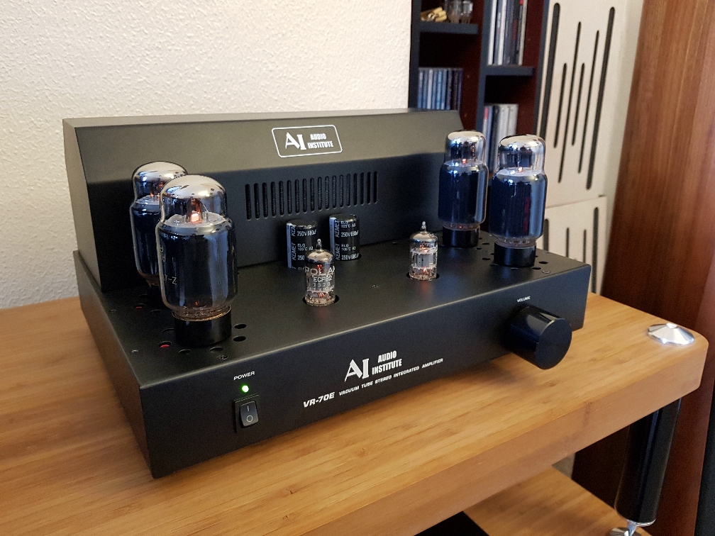

Just the reminder - VR-70E works in Ultra Linear 2x40W mode by default. The vendor - Affordable Valve Company was offering this mod for £158 stating "YOU CANNOT GET FAIRER THAN THAT !". Seriously? Overall cost of Triode setting starts from few Pennies to few Pounds if we decide to have it switchable version. The output power in Triode mode is 2x20W.
Somewhere in the meantime I tried this Amp in Triode mode. Experienced DIY-ers surely know how to do it, however I will show the example on my unit if any owners are interested.
Job is simple - need to disconnect, isolate and leave away four wires marked on both channels as SG1 for bottom Valves and SG2 for the top ones. Solder small bridge between P1-Sg1 and P2-Sg2 on PCB for both channels. Job done, photo below - you can see small bridge wires in clear sleeves there:
Some people prefer Triode mode, some others stay with UL. Can't decided? You can always implement switches - they can be found factory fitted in some other brand Amps 😉

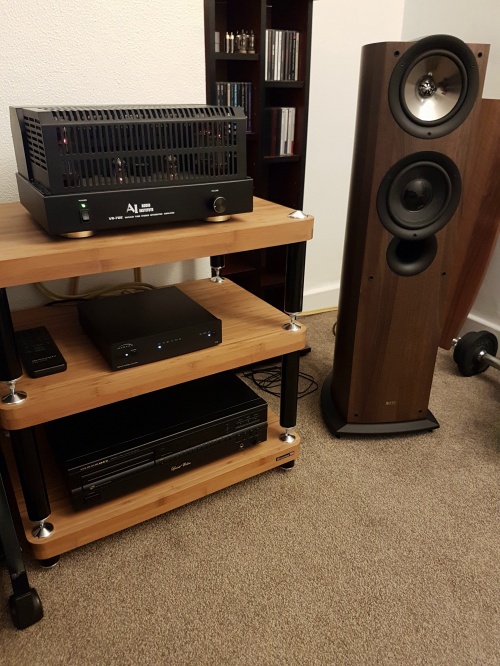

I am running this beauty made in 2007 with 15yo speakers (Sonus Faber Grand Piano Home), and for now I don't want anything newer than that!
Yep, micro & macro dynamics is pretty good with stock parts - however mods I've done in power supply areas just change that for even better. Way better 😉

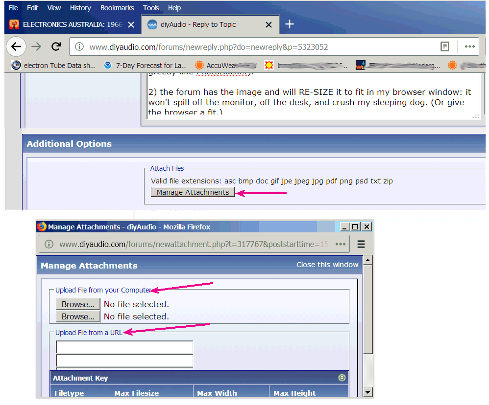

I am spotting that problem with photo from time to time - entering this topic.... 🙂
Please use the Attach function on this forum.
1) the image will stay with the thread even if the external host goes off-line (or greedy like PhotoBucket).
2) the forum has the image and will RE-SIZE it to fit in my browser window: it won't spill off the monitor, off the desk, and startle my sleeping dog. (Or give the browser a fit.)

looking at your pic's it seems that the grid stopper resistors are not connected properly they should be between 0.47uF caps and the EL's grids, at the mo the caps run the signal straight into the grid and the 100k Ohm resistors are doing nothing to stop any oscillation.

Good job that resistor failure doesn't drag any consequences to the Valve. I think so, as I was swap two of them in places to verify the side of the fail - valve side or Amp side. No idea if Tube Valve lifespan was affected or not, but I am not to worry up front for that reason.
At least I know few facts now - the Amplifier is a bit over ten years old, so simple bits have right to give up their lives there. And resistors replacement for a bit better than stock ones is not drilling wallet much - so it is a good time to refreshment 😉
I am not very keen with electronics, so location of that 100k Resistor is "as it was" - as I don't now much about it. Simply no idea why someone designed that circuit that way and what pros & cons could be spotted there - if it will be like you mentioned.

Next step in modifications was testing some Chinese no name Potentiometer - which supposed to be "based on black Alps" basing on seller recommendation. Whole story is worth only four words - terrible quality, horrible sound. In that time I was waiting for delivery of AN-100K from Audio Note, mentioned couple posts ago - so i just tried it in the mean time as I was curious of it.
Bigger improvement in that time was adding softstart Circuit. Some people say that is nonsense and may causing problems. This one is well designed with protection at 95°C/6,3A, adjustable time 4-12sec. This is not one of those been sold on eBay by the way.
Fitting this softstart board forced me to reorganise some components in that area - goes quite well, only trouble is that the speaker transformers had to be unscrewed to release rectifier module fitted with one screw and place it by the other side of power transformer.
The photo below was taken after last mods been made up - until Amp broke down. That was while ago - some other was planned, but never made up till I had to re-open week ago. But about those changes will tell you later, let's come back to those changes from the picture.
First change - swapped C1 Caps next to 6F2 (ECF82) sockets. A lot better sounding, better in every aspect. That only confirms how crap those original Capacitors are - every change is the winner!
Second one - AN-100K Potentiometer finally sat there, this change forced me to buy new volume knob. Nice big, heavy piece of metal. Simply beautiful, just take a look guys 🙂
Due to "squeezy" resizing of Forum Script I recommend to click on the photos. It will be also better to see changes I was mentioned 😉
