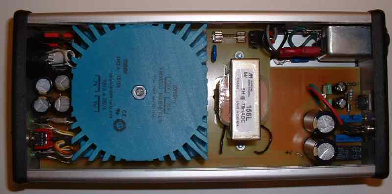

I investigated the Michell HR supply upgrade and after some search and advices made my own CLC filtered, high current dual speeds upgrade supply,
see: http://www.diyaudio.com/forums/showthread.php?s=&threadid=62049&highlight=
Here the power supply.

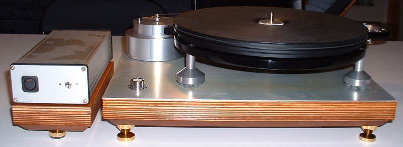

Still waiting for the tonearm and cartridge, I decided to built an upgrade platform for the table. This table is rigid and most users report a better sound when using a vibration absorption table.
See this thread for the details: http://www.diyaudio.com/forums/showthread.php?s=&threadid=65266&perpage=10&pagenumber=1

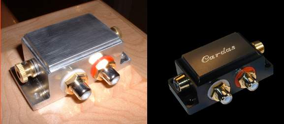

I was already convinced to buy a Rega RB300 tonearm and rewire it with better cables. I wanted to terminate the arm wires into a Cardas CPIB Phono box mounted on the platform. This would give me a strong connection point, allow to move the table without having a mess of wires hanging around and I'll be able to try different cables for a better sound 😎
The only drawback was the price of the CPIB so I decided to build my own. Here the result compared to the real thing, not bad.

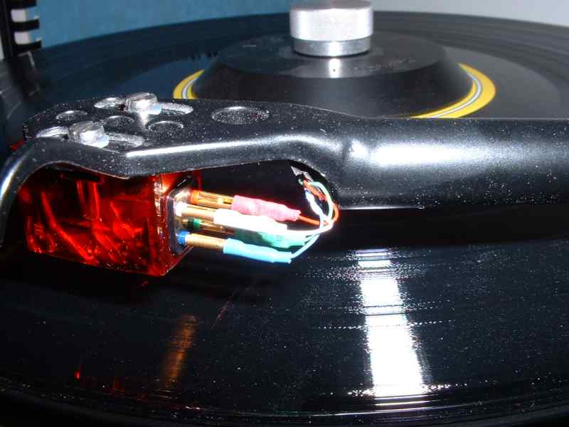

Then I found a very nice used RB300 tonearm on audiogon at a good price (less than third of the street price), but guest what, the wires were missing. No problem for me, I was already planning to upgrade the wires anyway.
So I got the tonearm and it was in very good shape, and the arm tube was indeed empty, not even a gnd wire left to ease pull back some new wires. Some challenge here...
I decided to go with the Cardas 33awg tonearm wires. Instead of buying separate lenghts of each color wire, I bought the Cardas tonearm cable that contains Four 33 awg wires twisted then bundled in Teflon tape, braided shield. It is small, very flexible and cheaper than separate wires.
I was also planning to use this cable as interconnect using Eichman Bullet Plugs connectors. So I bought 5 ft, 2 for the arm and 3 for the interconnect.
The rewire took me just 3 hours and went very smoothly, a piece of cake. I was even able to reinstall the arm ground wire as the original. I installed my connectors box on the platform using four 4-40 hex head screws and terminated the cable. I was wired again.

And a close look of my new tonearm wires. I did everything, the small clip installation, etc... A lot of fun. Big Bear fingers stay away

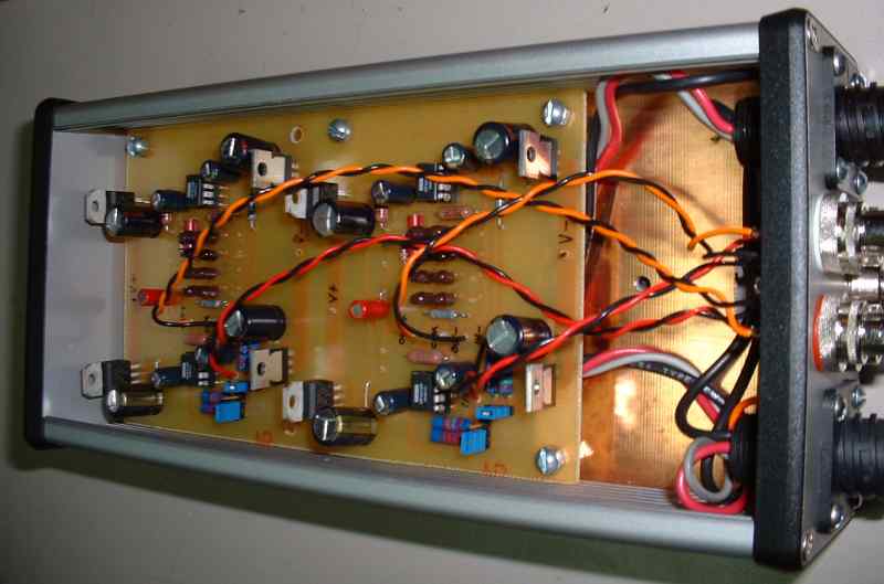

So I decided to build rapidly a nice, little PhonoClone, a clone of the renowned 47Lab PhonoCube. See for the details: http://www.diyaudio.com/forums/showthread.php?s=&threadid=57398&perpage=10&pagenumber=19
Its sound using my current DL110 and Kyocera turntable was just impressive. Years ahead of the NAD PP2.
