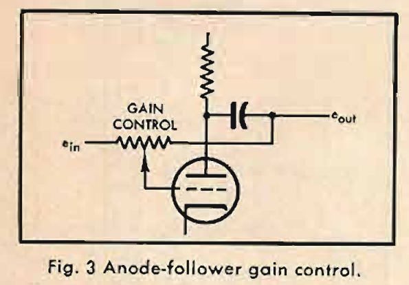

Schade original feedback (1938) can be found here:
https://www.dos4ever.com/uTracer3/Schade.pdf
Crowhurst reposted that kind of anote-anode feedback in 1952 here:
http://www.tubebooks.org/Books/Crowhurst - Audio Handbook No2 - Feedback 1952.pdf

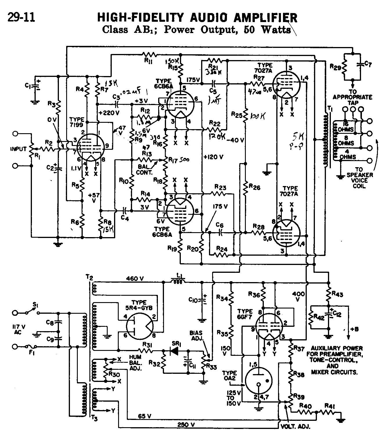

I will use, as a reference the schematic share by Bandol on the first post of the original EL34 thread:
https://www.diyaudio.com/community/attachments/schema-el34-rev-3-12-july-2018-pdf.701184/
First of all, I don't use the version with the dedicated pcb for PSU, because I personally don't find it very useful based on my experience:
the negative rail voltage regulation is not strictly needed because all negative supplies pass through cascoded CCS, so highest possible noise rejection.
Low voltage positive supply could benefit from a 7824, but even without it I've found it not noisy at all.
Looking at the Mullard datasheet of EL34 ( https://frank.pocnet.net/sheets/129/e/EL34.pdf ), I've chosen to work at 23%UL for different reasons.
I will then talk later on about a second feedback I applied, but it would be off-topic here.
About R33 and R38:
