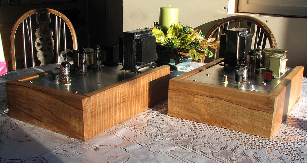

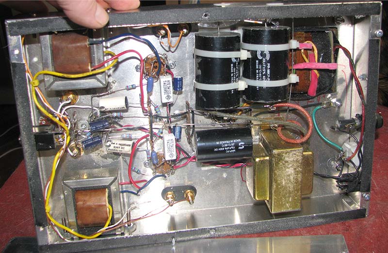

SE, Scade feedback, RH84 probably the best example but can be tweaked up a bit. We built a parafeed variation in monoBloks that are very good (and have appreciated significantly given what they were recently listed at on Canuck Audio Mart).
I don’t rate them as good as the PP (very different sound) but has near twice the power. The single biggest thing you can do to the sonics are the big black things. At least the last stage of the power supply should be a poly cap since it is in the signal path. Ours had no
\elcos, was parafeed (a pair of OPTs & PS Trafos from Grundig consoles), one used as the parafeed choke. Separate filimant supply, hybrid rectifier, and a ckoke in the PSU.
This was the 7th iteration of the amplifier that started out as a Decware ZEN clone. They kept getting better. I do have som edifferent deas for version #8.
If you want to do one on a budget, OPTs and PS Trafo from old consoles. Especially if you are lucky enuff to find one parked on the side of the street with a free sign on it. For example i thing the parts cost of the monobloks above was on the order of $150.

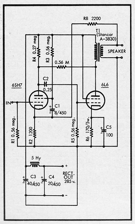

SE Shade is what I suggested originally, and about as simple as it gets. Nobody seems to have discovered the link I posted earlier, so I try again with the schematic:
6SH7 may sound exotic and certainly not available in new production. Fortunately they are cheap and abundant, so grab yourself an extra set and the amp should last a lifetime.

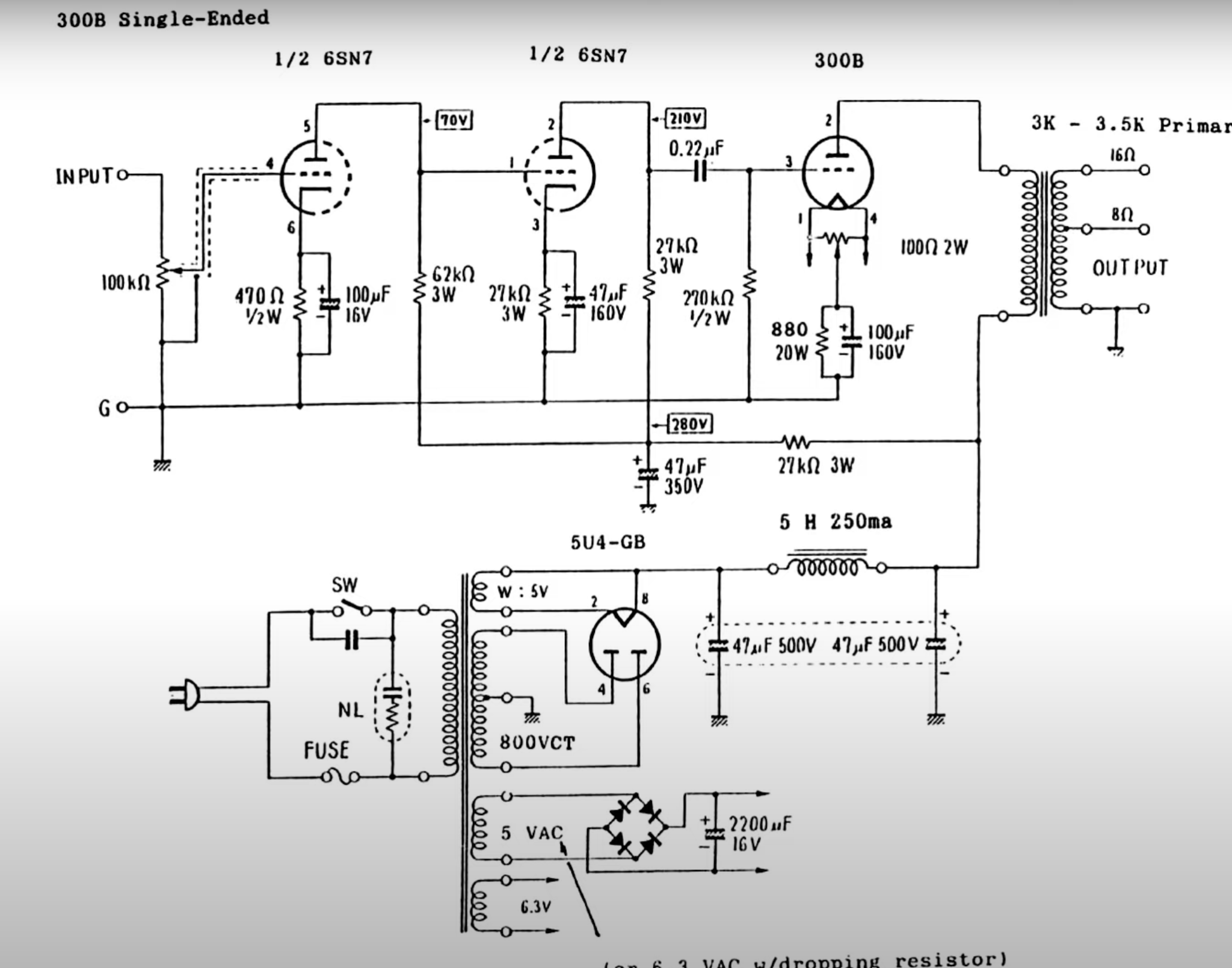

What's up with 300Bs? They seem to be simultaneously sought and avoided…
The usual. Some swear by them, others swear at them, and some ignore them.What's up with 300Bs? They seem to be simultaneously sought and avoided…
DHT tubes require special care with heater power supplies, 300B need good drivers, and good ones are expensive.
