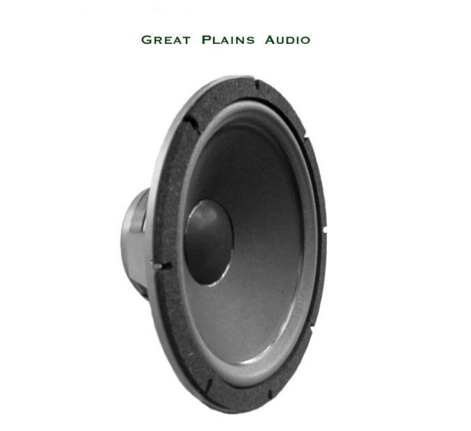

Maybe one of the best, if you can resource overseas, not trying to be rude and deserving some testing is after all the Acoustic Elegance (AE) or for this short resume the Great Plains Audio 354(GPA). 😀
http://www.greatplainsaudio.com/downloads/3154.pdf
