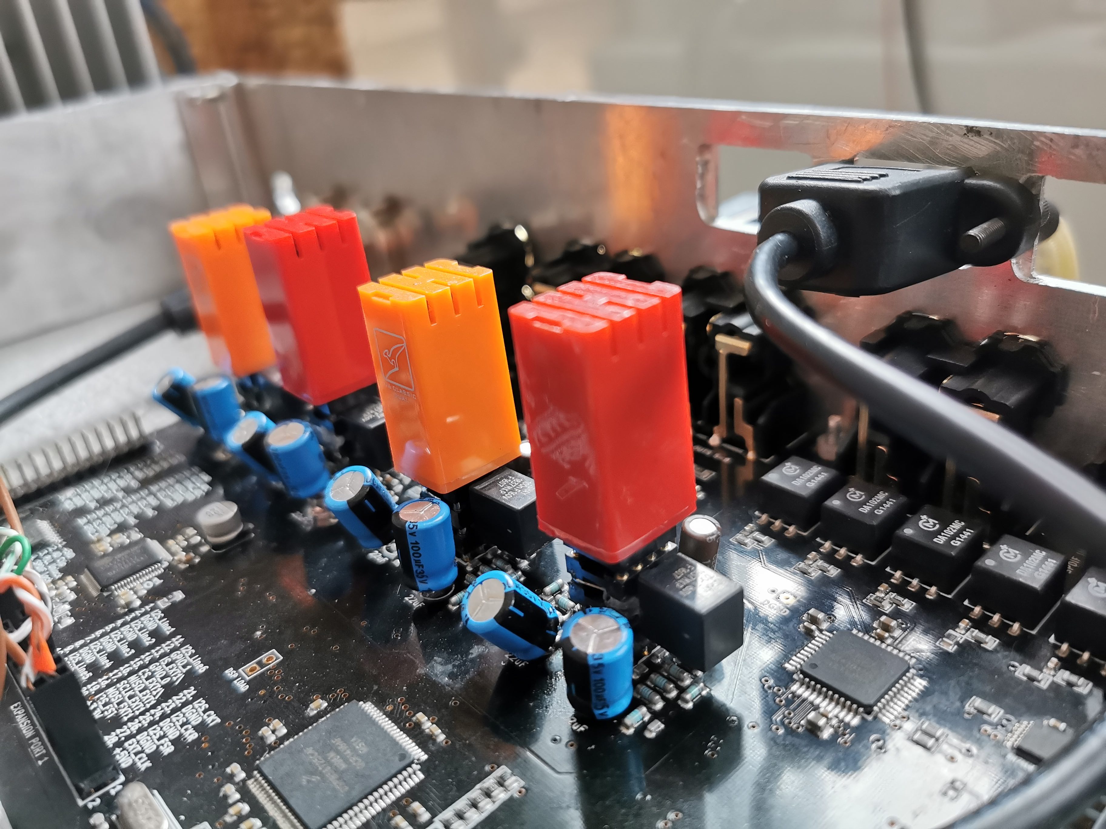

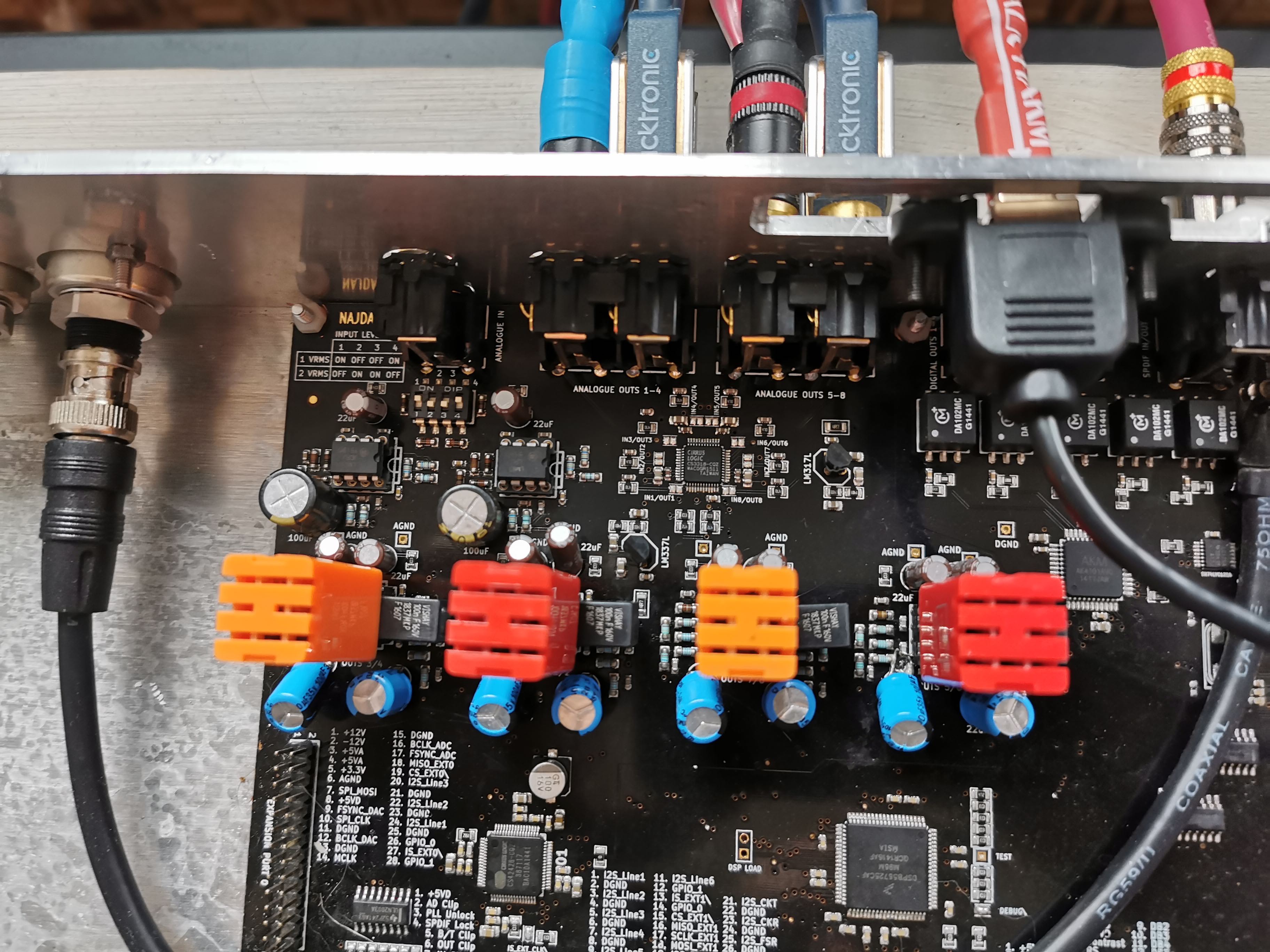

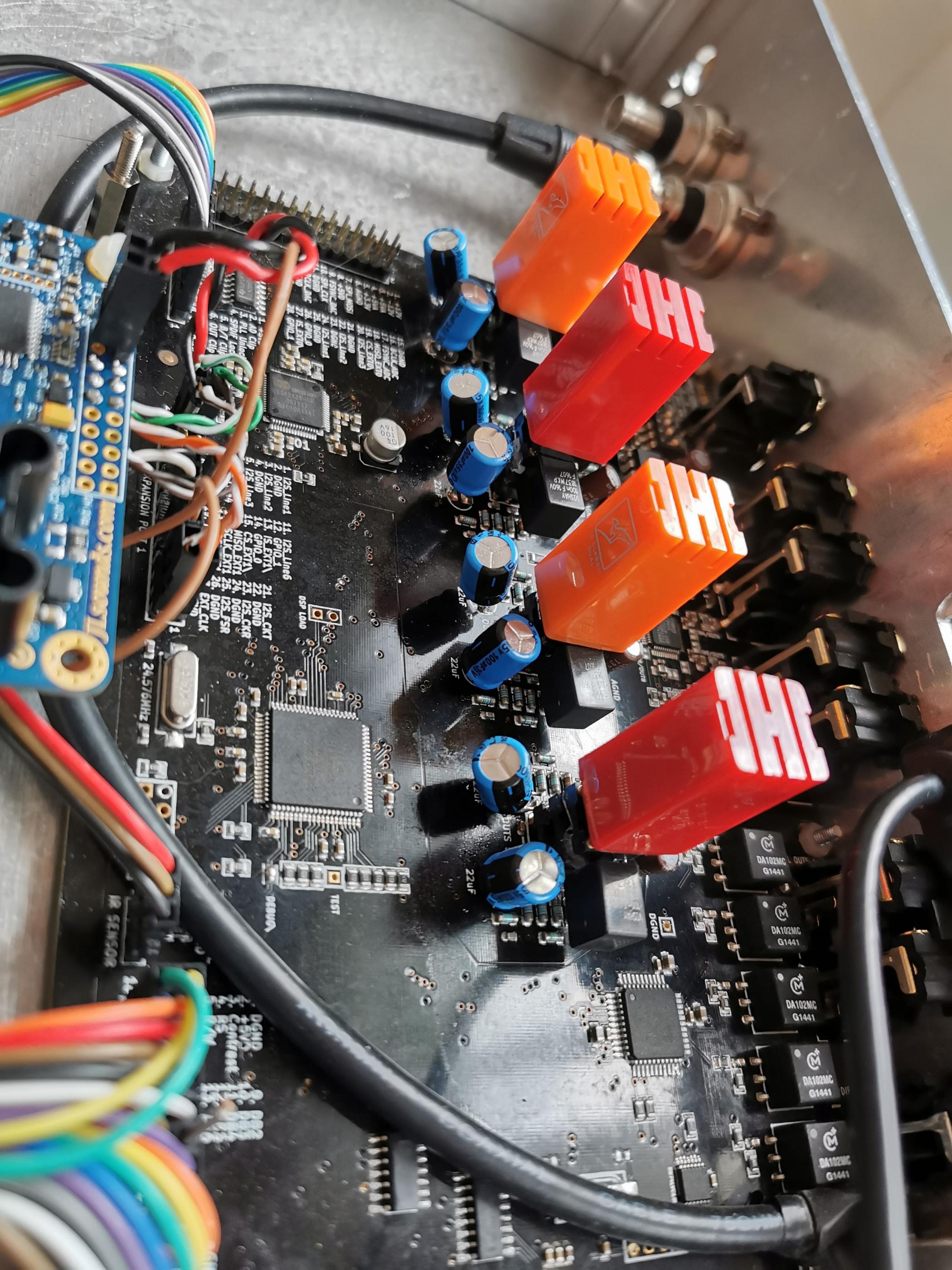

When the opamps arrived, I decided to try if they even fit to my modified Najda board. The board had all the electrolytic capacitors close to the opmaps replaced by Wima MKS film capacitors. I didn’t consider this as an upgrade, by the way. Bursons did not fit the modified board, so I had an good excuse to go back to smaller sized electrolytic capacitors. Replacing them made just enough room to make the Bursons fit.

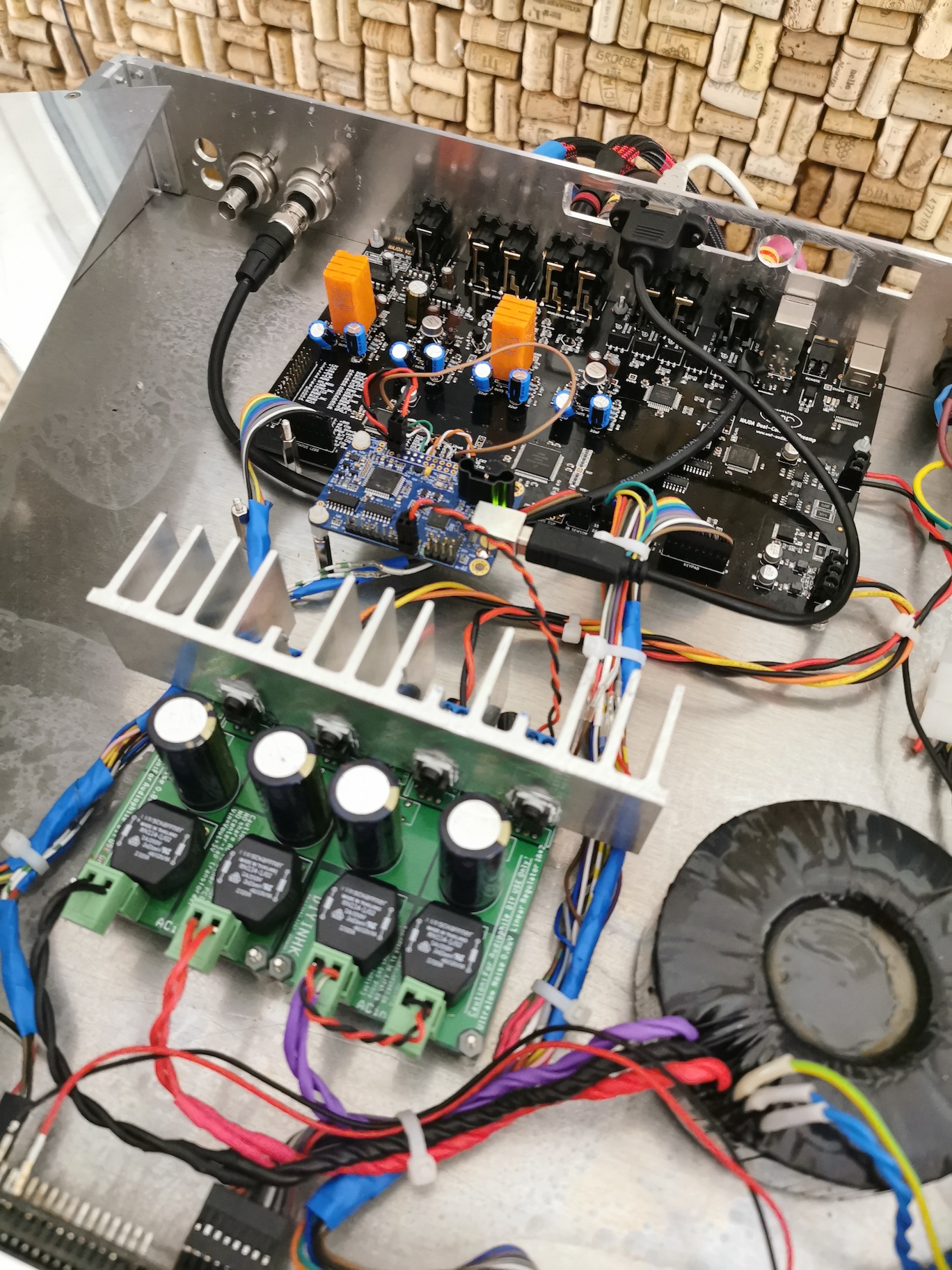

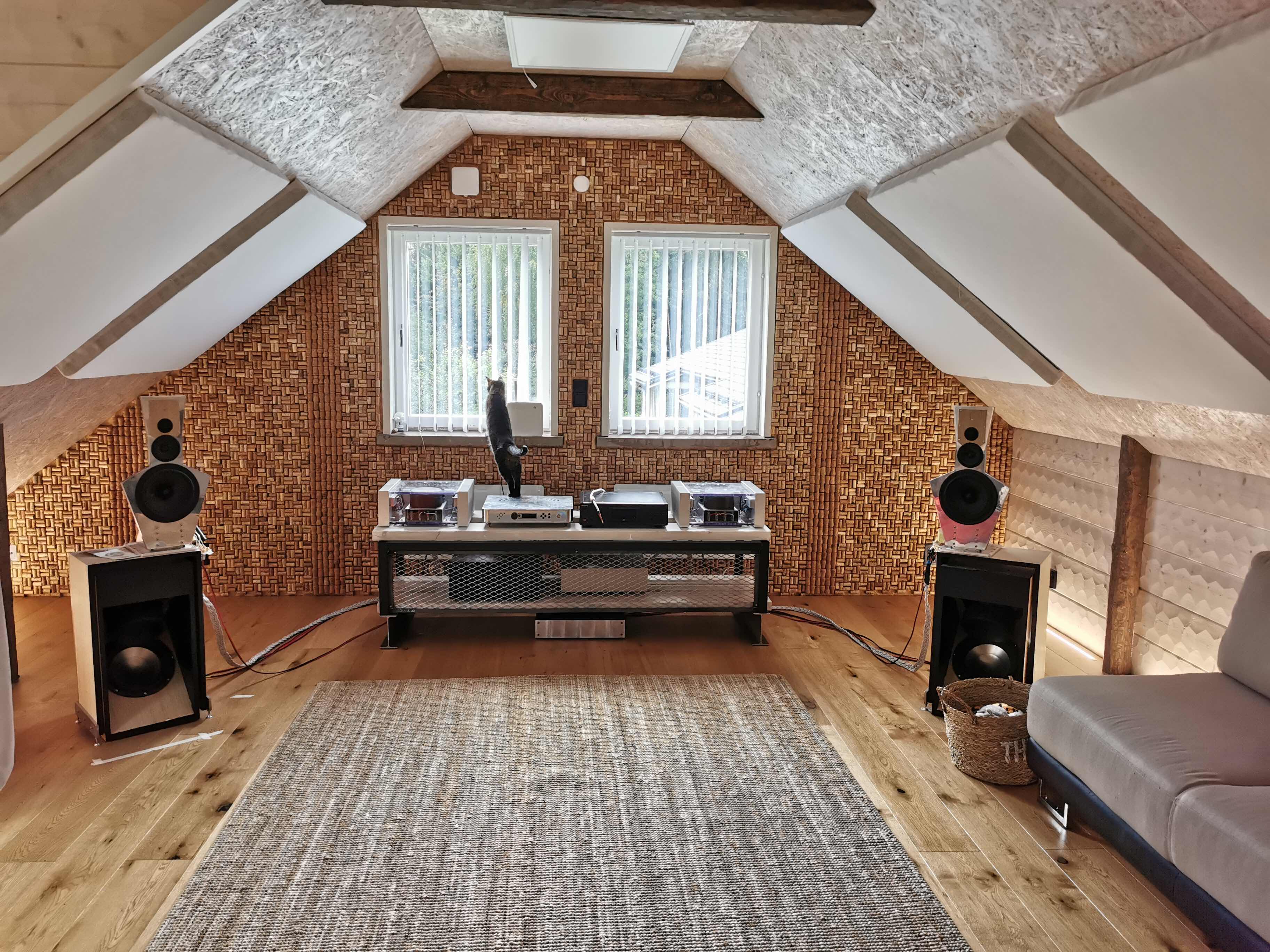

Attached are a couple of photos of the system

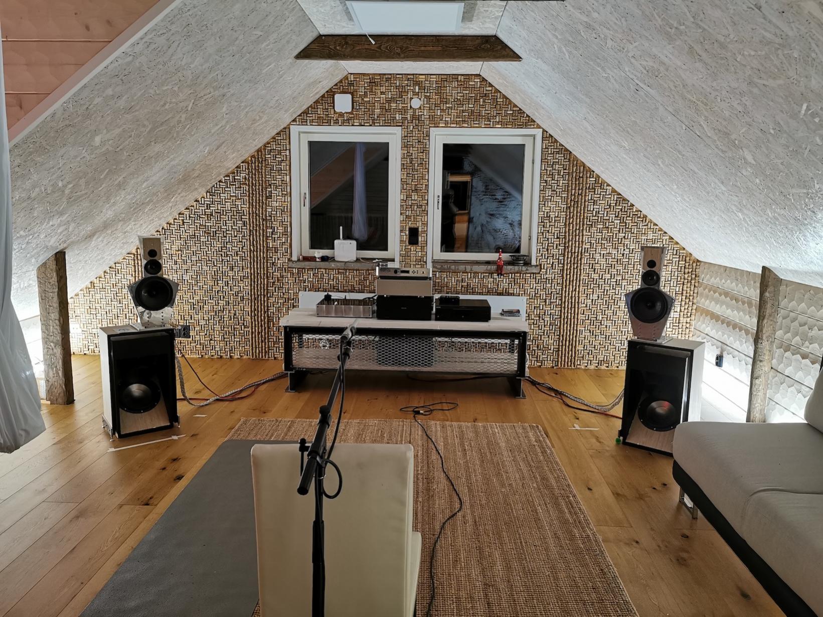

Next, I added some acoustic treatment to the room. I added 8pcs of 120cm by 120cm by 5cm acoustics panels plus a 2cm air gap to the slanted ceiling. Then, replaced some of the Primare class AB amplifiers with Pass F5 DIY versions. To be exact, tweeters and upper midranges are now amplified by the F5’s. After these changes I was very surprised, the soundstage got quite funny and a lot deeper, much deeper than I could wish for or ever want. So, for me that was a bad thing. In the songs where you would want to have the singer on your face, it’s too far away. Then, with some experiments with the acoustics panels I was able to affect the depth of the soundstage. This confirmed that the most of the problems in the soundstage are caused by the room, and perhaps the slanted ceiling and not by the opamps.

My question for any and all op-amp rolling:
Have you checked for radio frequency ringing or even oscillation with a 30 MHz (or higher) O-scope?
This is exactly the right question! Simply replacing opamps (certainly high speed ones) might result in such. Also large devices tend to pick up nasties faster than DIP/SMD packages. A plus for the LME is that it is the metal can version which is shielded.
When the opamps arrived, I decided to try if they even fit to my modified Najda board. The board had all the electrolytic capacitors close to the opamps replaced by Wima MKS film capacitors. I didn’t consider this as an upgrade, by the way. Bursons did not fit the modified board, so I had an good excuse to go back to smaller sized electrolytic capacitors. Replacing them made just enough room to make the Bursons fit.
So technically better decoupling is replaced to make way for audiophile opamps? Isn't this illogical?

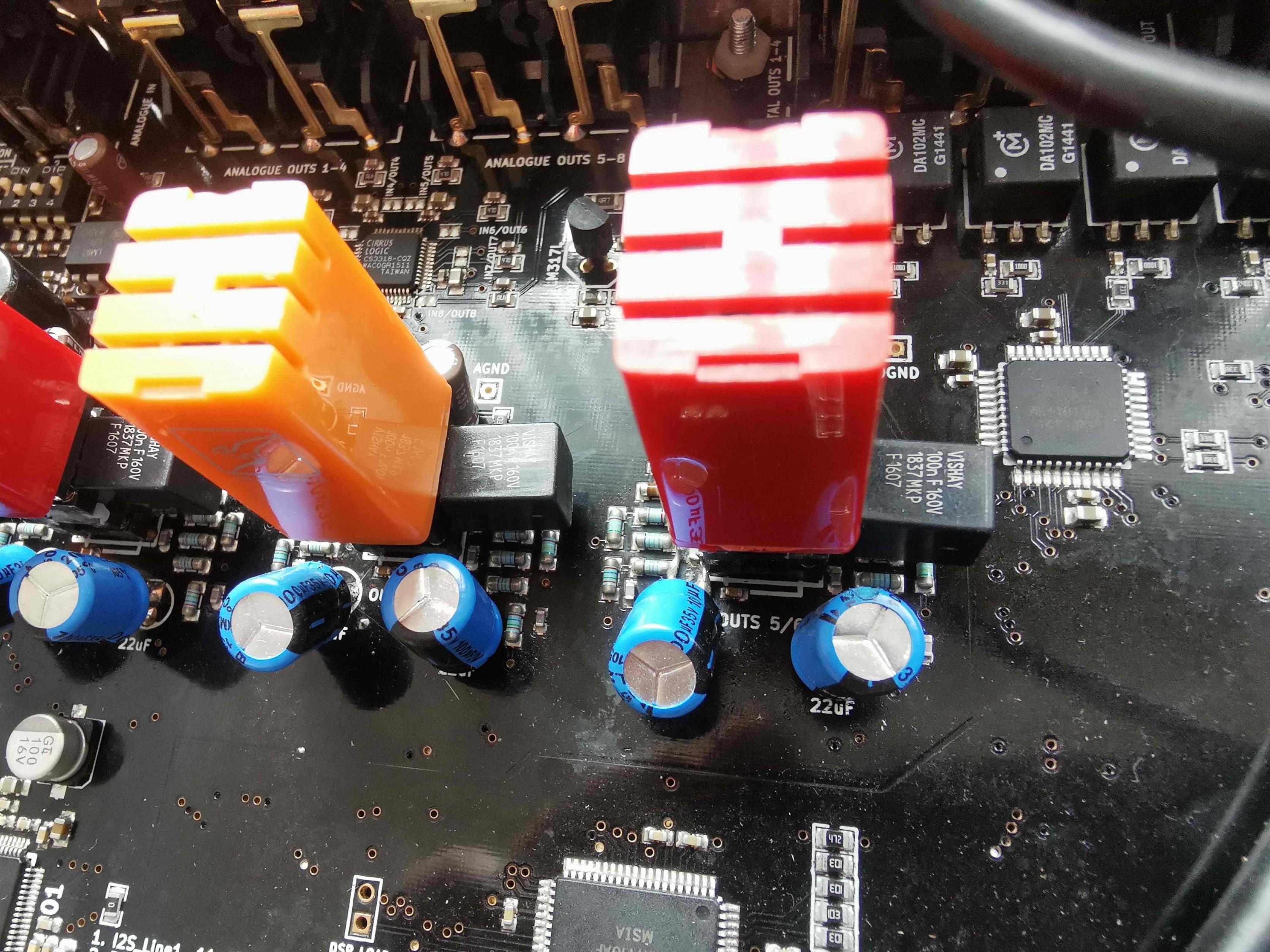

Here are the promised photos of the opamps and system and listening room.
Yeah, I haven't checked with scope...
You are absolutely right, it is illogical. I just did not like the Wima mkS there, I felt the ELNA Silmic II was better in this position. I also tried both decoupling and coupling with the MKS but found that those ELNA's sound better to me. This is very strange, I hate the idea of having capacitors - especially electrolytics - on the direct signal path, this is why I use F5 amplifiers, but in Najda I found this better. Too bad there was no room for proper polypropylene in coupling.

I love your wall treatment. I pity your liver 🙂
