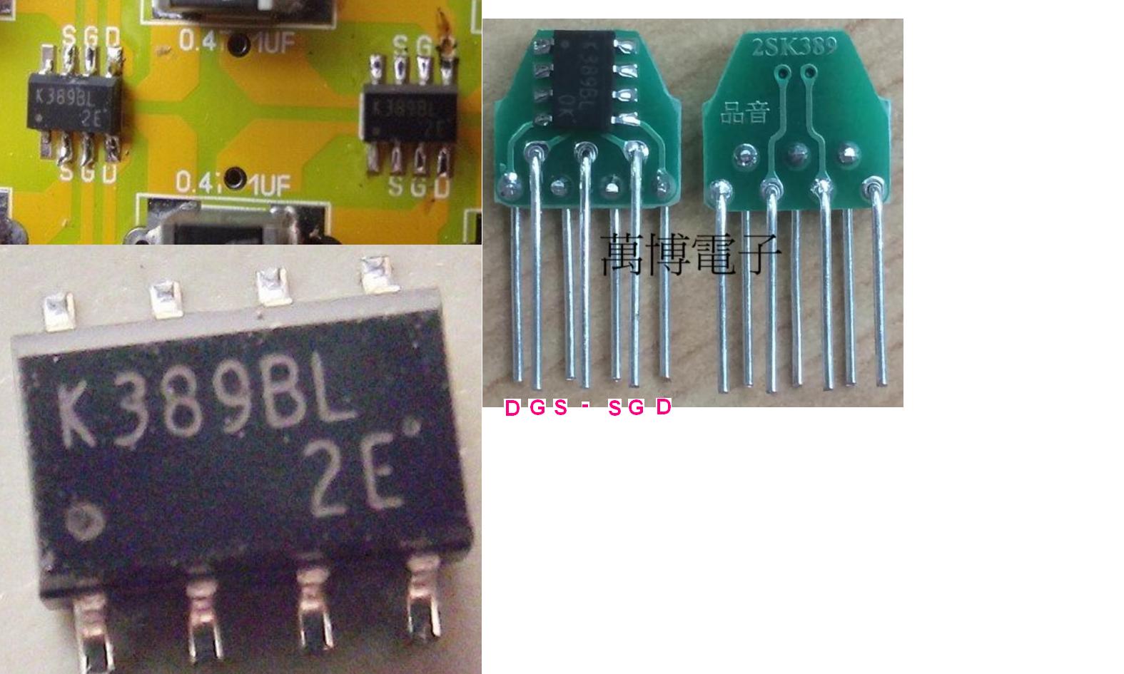

I found some "Toshiba" 2SK389 SOIC packaged dual transistors on Ebay. They do NOT have the same pin-out as the Linear Systems LSK389.
They are marked K389BL OF
I soldered them onto some DIP adapters to test them. (I checked the adapters for correct pin translations)
The pin-out appears (and works) as:
pin2 S1 or D1
pin 3 gate 1
pin 4 D1 or S1
pin 5 S2 or D2
pin 6 gate 2
pin 7 D2 or S2
No apparent connections to pin 1 or pin 8.
The FETs trace on the curve tracer just like a 2SK170 and are well matched for gm. However the current offset ( Idss ? ) can be mis-matched by up to 25mV gate V.
(half a step division offset with 15 traces and 50 mV steps, so 25mV mis-match) One device did trace perfectly matched.
I would think that adjacent dies would be better matched on Idss. Could these be matched 2SK170 dies in an SOIC package?

Any way to tell which pin is Source versus Drain. They (and 2SK170) trace exactly the same way by swapping S and D around. Does it matter?

The parts are symmetric so you can swap D for S. I recall matching of originals was .5 ma idss, so .25v max Vgs is realistic.
There is no records of Toshiba making this smd chip 2SK389.
Even if they ever did, shouldn't they have used the different part# for the different looking part,
just like they did for the 2SK117 dual (5 pins)?
Of course LS did use the same part# for the through-hole and smd versions of LSK389, but the
smd pinout is different from the "mysterious" part.
Yours:
pin 2 S1
pin 3 G1
pin 4 D1
pin 5 D2
pin 6 G2
pin 7 S2
The pics attached demonstrate that the boards were made to produce the same ZIP pinout as the
original 2SK389.
If your chip has the transconductance of 2SK170, that is higher numbers than the 2SK389 jfets
should have...
The pinout is also different from the new JFE2140 dual...
The first guess will be for chinese production...

Wow, you hit the Rosetta stone there. Clearly the same part on that board as I have here. I wonder who makes the part in China. Probably less than a $1.00 from the manufacturer. I paid $9.50 for it on Ebay. "Original Toshiba" $$$, yeah right. Ha!
