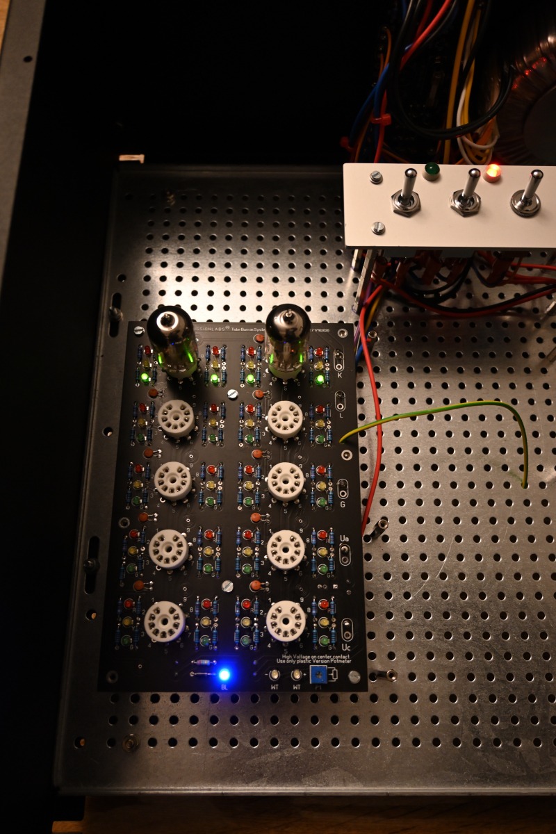

The "project" is an AC-driven tube tester I might try using for matching JFETs. The tester will peak into positive grid voltage. It is made for 9-pin noval type tubes like ECC83 etc. and uses 220V anode voltage. It can be reduced using a vario in front. So this was the main reason asking for the article.
If someone has an idea for nice universal "sockets" for small signal JFETs I would like to know. Maybe 6-pin DIL sockets can be used.

So far the tube burn-in tester looks like this. Bias is adjusted via a 10-turns pot which is not visible in the picture.
A PCB overlay will be installed so only socket and LEDs are visible. The idea is to match via LED light emission.
