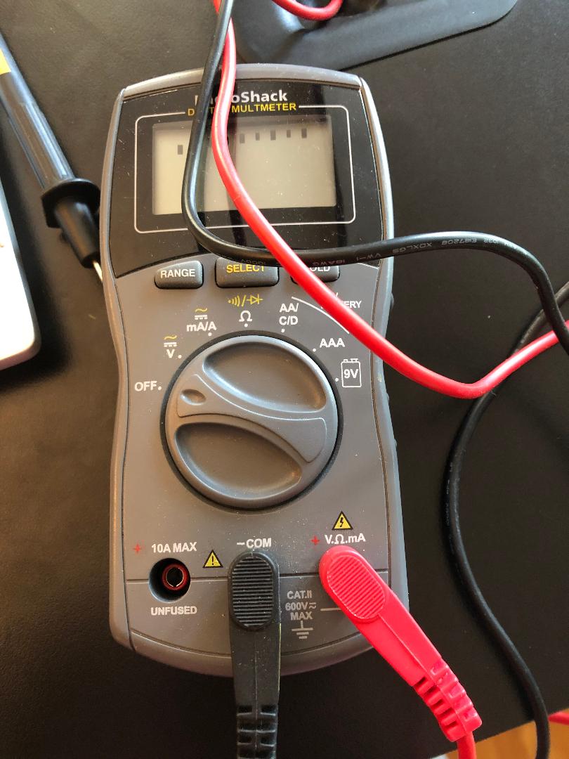

I do own a DMM (Radio Shack brand...I know, insert laugh here 🙂... but it is of lower quality and I'm not sure if I have the skills to trace the music to see where it stops. The schematic for the NAD 1300 isn't as intuitive to me as other schematics that I've looked at. Likewise for scraping the VU meter with a 10 ohm resistor...I would need more specific instructions to complete the task.

I predict your radio shack meter will provide random number when measuring music or frequencies different than 50 or 60 hz. I trace music from a earphone jack of a $10 FM radio or a $15 kiddie keyboard, using 1/8" stereo plug to dual RCA plug adapter cable. Don't use a cell phone. Any DC or oscillation fed back from input of a defective product under test can blow a $600 phone.
