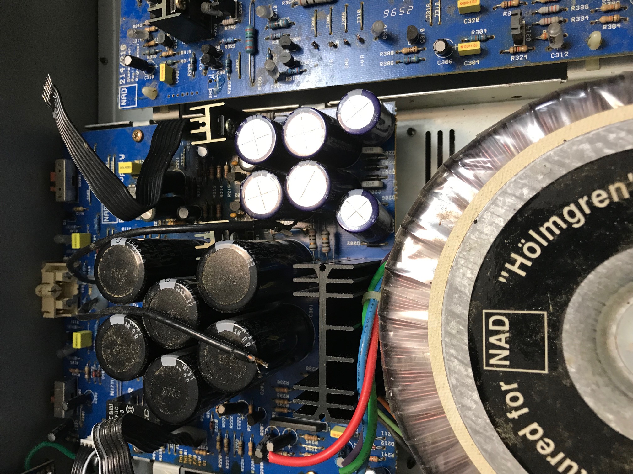

Took it home and opened it up - well it didn't just quit, the Left channel had a catastrophic explosion inside. 2 small 100uf/100V caps (C309 and C333) were completely blown off the board. It looks like the electrolytic went everywhere and has caused some corroision (yellow/green coating) on a few resistor, diode and one transistors legs and took the coating off the heatsink in a small area. He had clipped all the wires from the PSU to amp board. I guess he was trying to get the other channel to work. Either way it's stuck in protection mode.

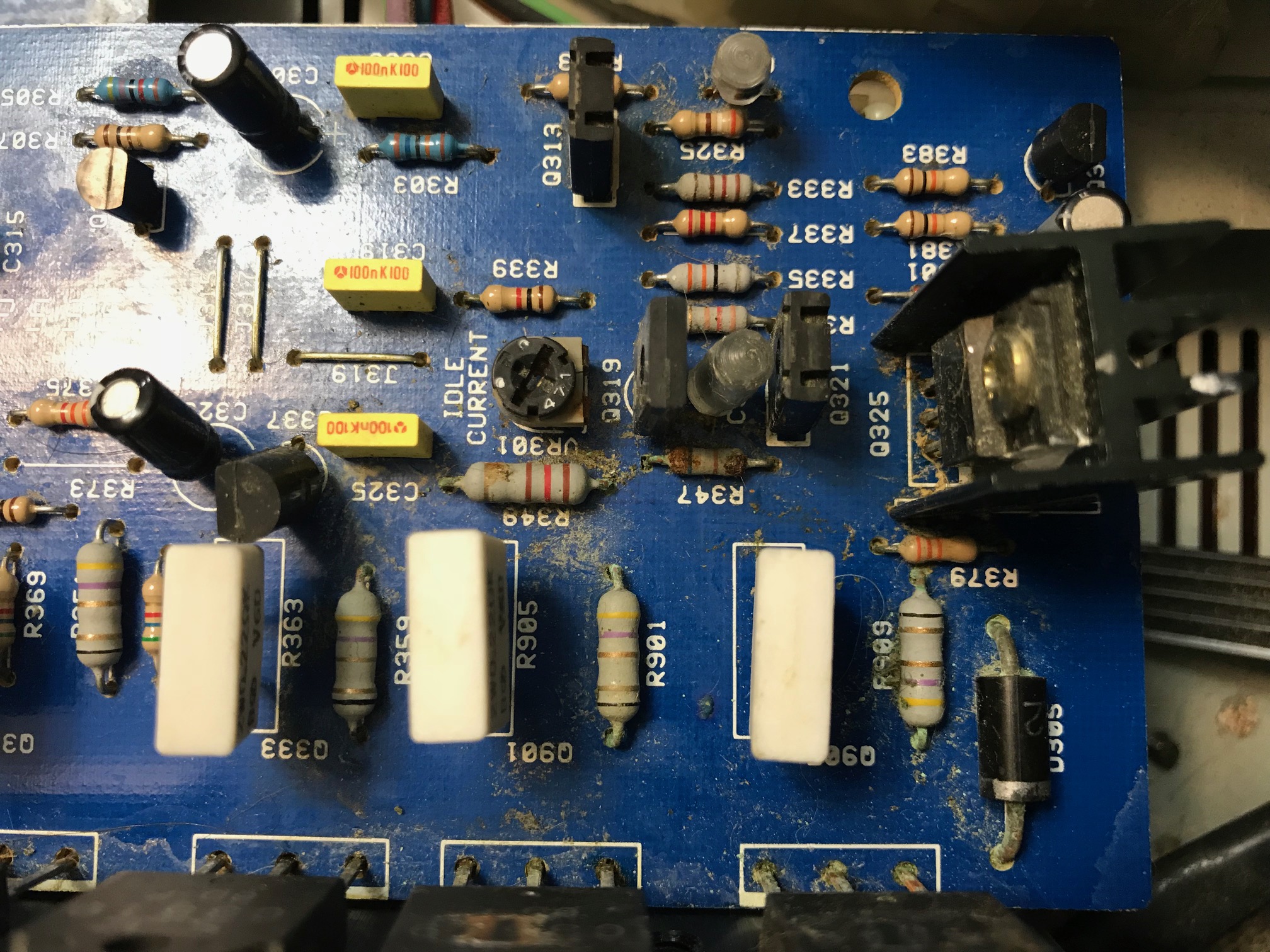

Looking a little deeper and found Q301 has the bottom half of its plastic blown off, obviously measures bad. Then there were a few (4-5) resistors that look burned, but only 3 measure out of spec. I assume the others gave up before all the resistors could burn completely. R327, R315, R331 are badly charred and measure out of spec.

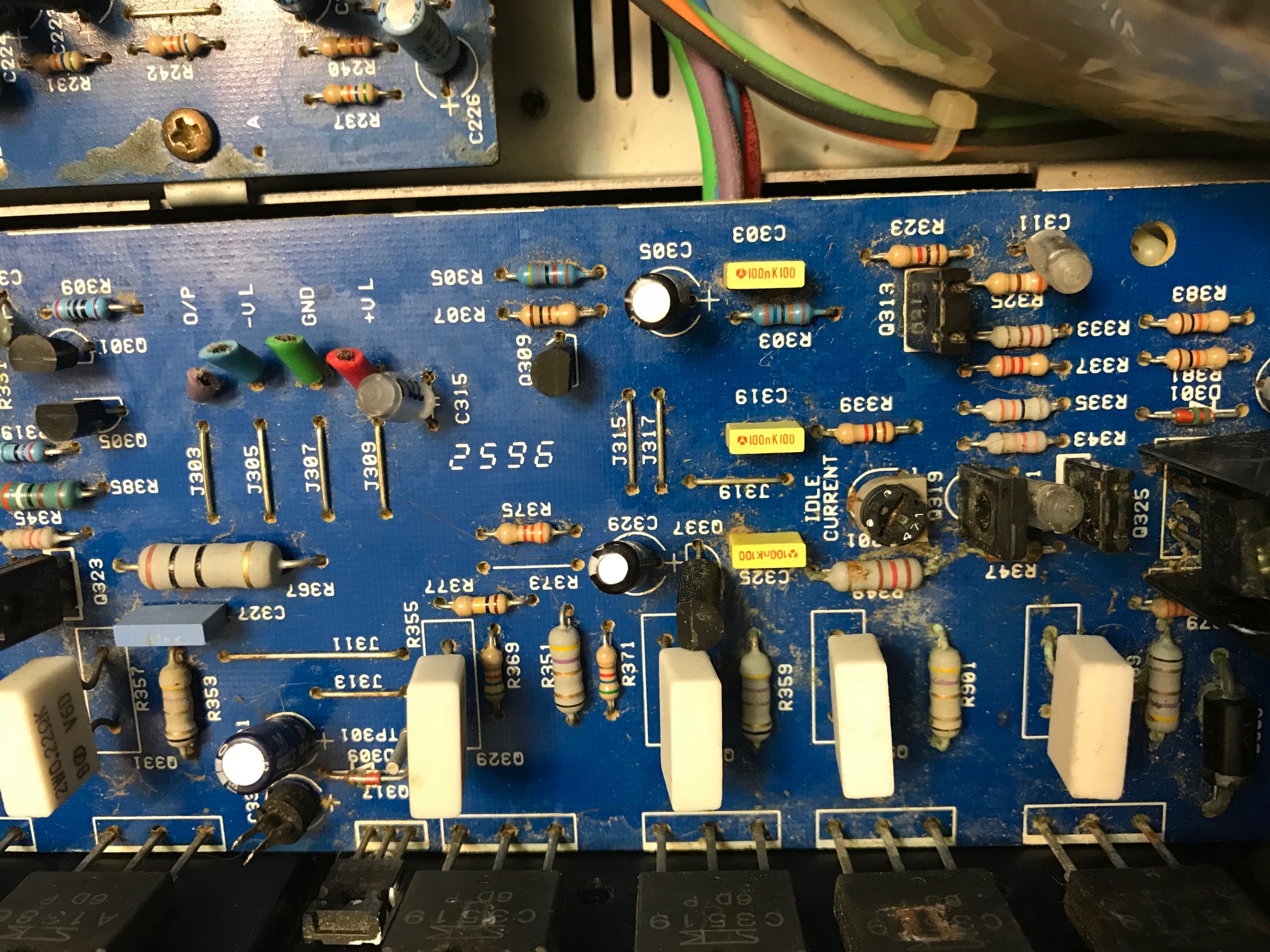

I checked all the small transistors and it looks like 3 are bad (incl. Q301) and only one power Transistor gave any strange readings - but might change if I re-work and test out of circuit.

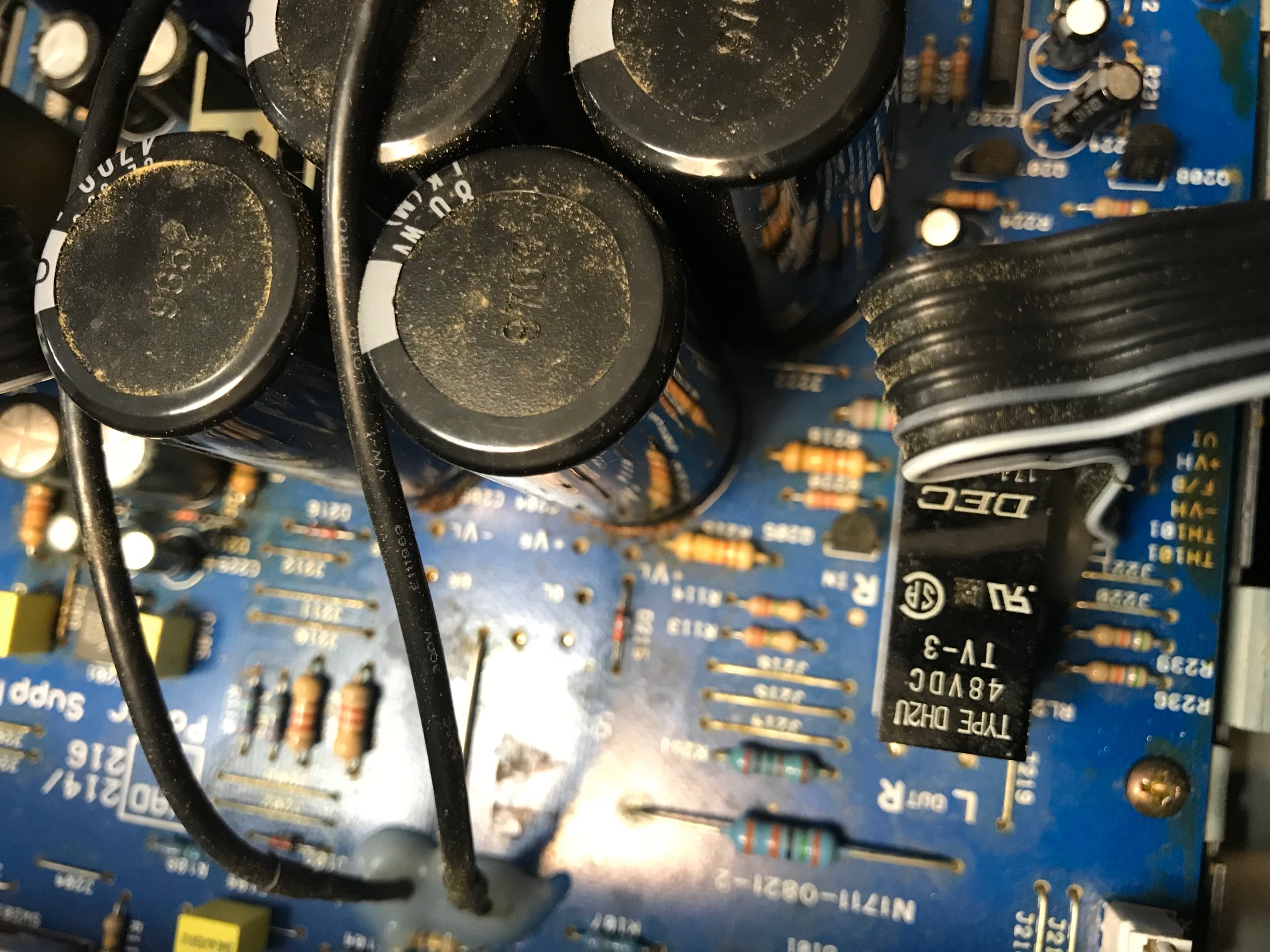

The power supply also looks like the mains power caps have leaked - but only just starting to seep. Voltages going into and out of the PSU are within the 48VAC & +/-67 Vdc specs in the service manual. Hoping it just needs some new caps all the way around and it will be good. Will probably change the relay for good measure, since I can't test it without a good amp channel.

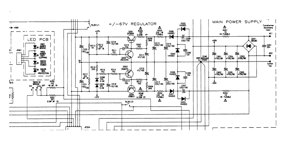

Tried to include enough info and pics for someone to comment. Pics include the PSU and Amp schematic. I also have the actual PSU with a close-up of the leaking. Then a few pictures of the bad channel board, after I cleaned it with a toothbrush and Alcohol.

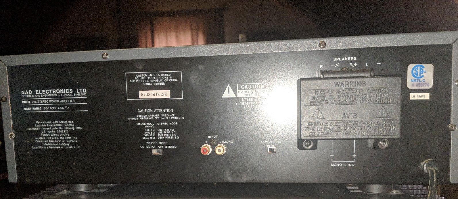

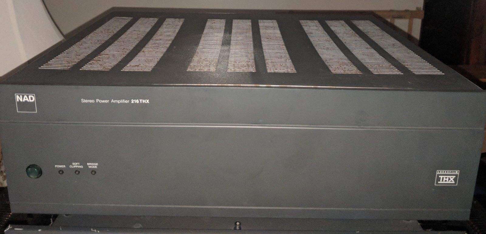

Here are pics of the front and back and the sides are just as clean. I would consider it very clean, especially for 20-years old.
There is one solder track (highlighted in PIC) going to -V that is gone. It's missing 10-12mm (1/2") of solder track. Should be easy enough to patch back together.

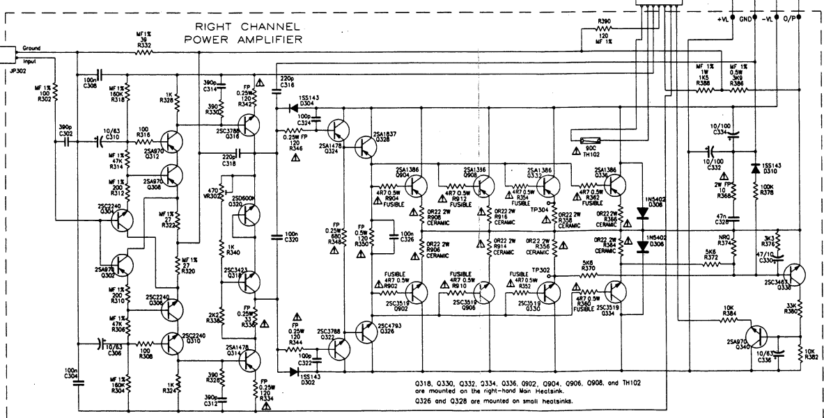

IMO NAD 216 is a well designed power amplifier.
Strong output stage with triple EF and 4 output pairs. NAD 214-218 (among many other NAD's) employs current feedback. See Stereophile review of the related NAD 218 (added cascode in VAS).
I'd rebuild it.
I'd rebuild it.

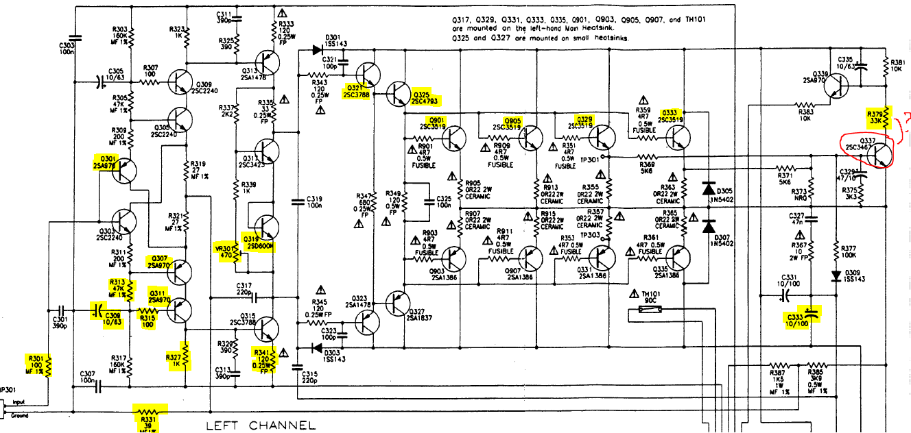

Ok - tried to test and get a list together of "bad" parts to make one order. I have tested every resistor to verify within spec., I have also tested each transistor with a DMM (by itself, but also comparing to the other channel)
I have attached a marked up schematic and I'm hoping you could verify if I'm on the right track, as far as replacing all the transistors that could be shorted as evidenced by the resistor and capacitor failures notated.
Case in point - R379, would that take out Q337? This is one that tests ok on one test, but the next day I tested it as bad?
Q301, Q305, Q307, Q311, Q321, Q325 all test as bad with a DMM - granted a couple others test good one day and then I do it again to verify and it tests bad. I am ordering complementary pairs and will replace both NPN/PNP.
Is this many transistors going bad typical? In past on much smaller repairs I've done, it was only 1-2 transistors that were damaged?
Additionally - the power transitors Q901, 905, Q329 and Q333 all 2sc3519 are all testing bad with DMM. They are showing 0.016 drop voltage compared to 0.593 on the compementary transistors.
