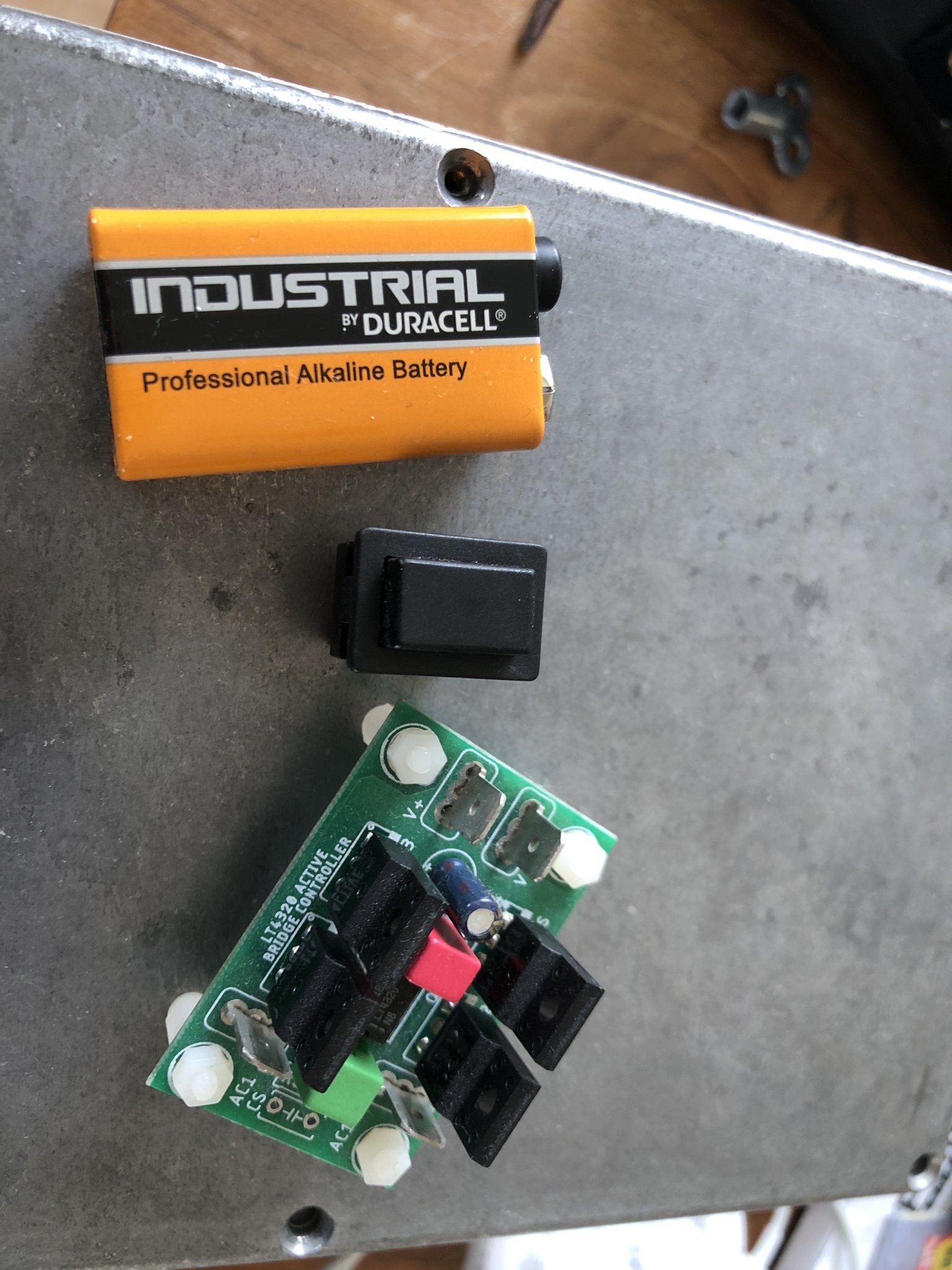

Hi I am afraid you can not find an original knob anymore that is still OK. As the switch itself also will fail within time (they are known for that) replacing it completely for a new mains switch with attached square knob is a possibility. Make sure to choose a double pole type that can handle the voltage and current.

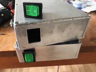

I think I used a non illuminated Marquardt push button type for that in the past (1661.0101). If you cover the front cover with tape and use a 2.5 mm drill predrilling the outline and a file you can do wonders. Here an example of a larger 20A rated illuminated 1835 rocker type switch in a cast aluminium casing.
