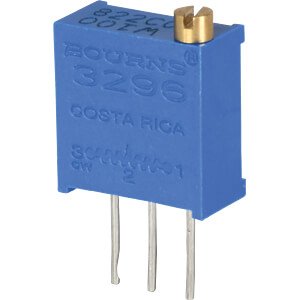

Test on the board trimmer R624 300 ohm - they fail after years of the usage. I'll replace these with precision trimmers, if you cannot find 300 ohm, 470 ohm can do the job. Even this trimmer measures good, I would recommend to replace it. You can check R618 200 ohm trimmer about the values as well.

Thanks I'll check all of those next. Coincidentally when I was checking the aforementioned transisitors, trim pots and diodes (all tested fine) I found that trim pot R668 in the right channel was bad. It's the one right under the bar that connects the selector switch knob to the switch at the back so I don't know if I can sneak one of those taller units in there. Either way, glad I found it now instead of after the issue is fixed and I went to set everything back to spec.

Re trimmer replacement--- I can't find the post, but @anatech recommends against muti-turn trimmers. IIRC, he argues that their wipers don't handle current through the wipers as well as single turn types. This design has a relatively low pot value, so wiper contact resistance may be a vulnerability.
A positive is that this design fails into a safe state if the wiper opens.

Thanks. Yes. Not only that, but with a single turn trimmer you know where you are.
Bias current is not an exact adjustment anyway. You will find it varies with temperature and often line voltage. You do wan to set it as close as you can and follow the manual. I always let them sit at the last adjusted value to make sure it is stable there. Therefore, a multiturn control to set bias does not make any sense.
Some brands have too much range on the control. We used to call it "Yamaha syndrome" for example. That makes them sensitive to adjustment. The fix? Get the bias current close, measure the control value and adjust the series resistor and pot to make the control less sensitive while bringing the adjustment in range. Then you can set it much more easily. Under warranty we couldn't do that of course.
