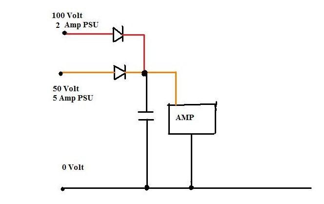

Sounds a bit like the old R.M.S. versus music power argument. Only guessing but you could do it this way.
The amp would see 100 volts for transients appearing from a " low average" signal. Anything of longer duration and the 100 volt rail collapses and your left with the 50 volt high current one.
Just made the values up.
