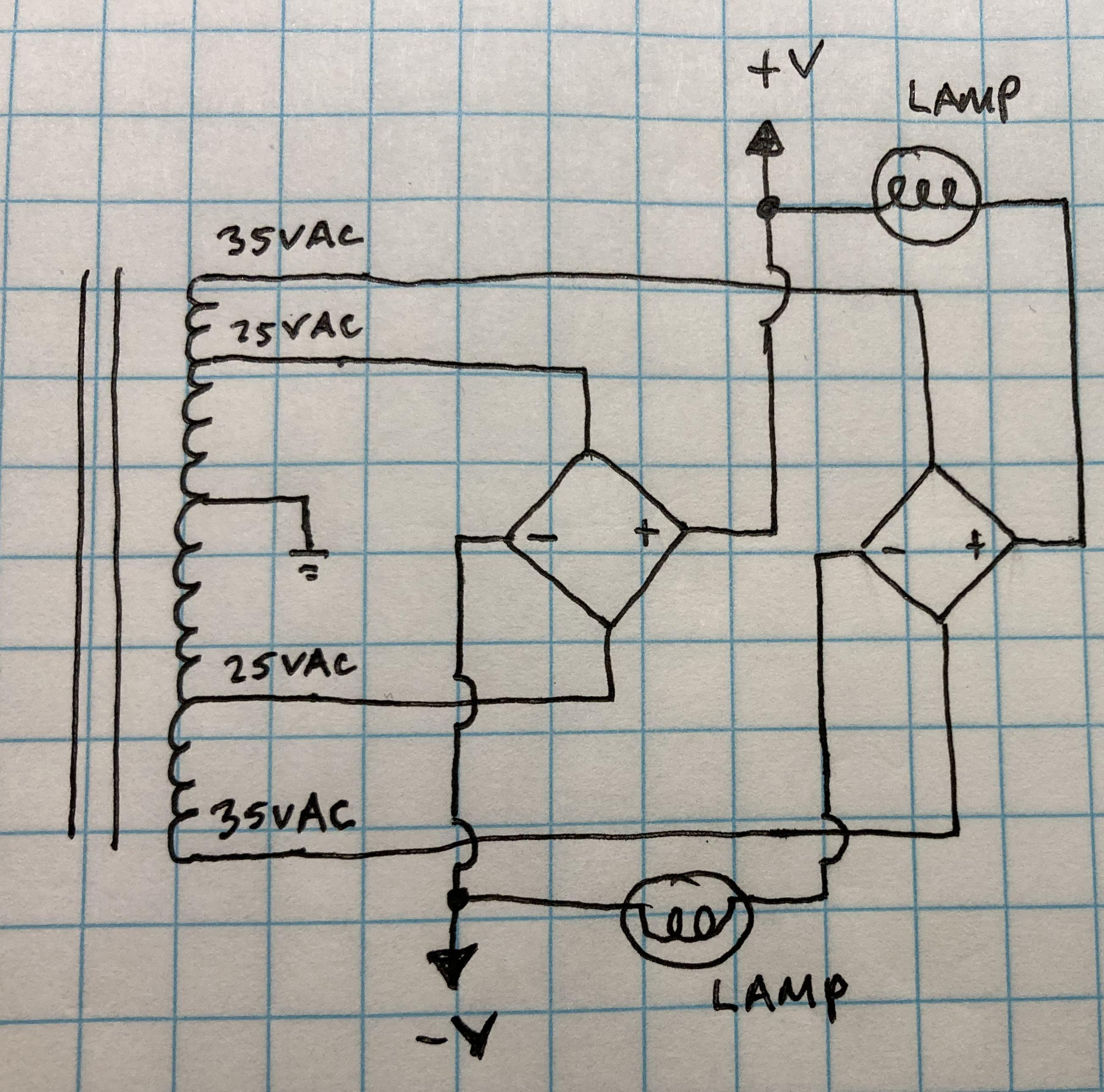

However, the between the 25VAC bridge rectifier and the 35VAC bridge rectifier there are two light bulbs (!). Are these part of some power boost circuit? It looks like even in standby these bulbs have ~10VDC across them. Is this really the source of the standby power draw?

Drawing the transformer center tap secondary winding another way and showing the dual bridge rectifiers connected via lamps. Even if no current is drawn by the rest of the amplifier from the +V/-V rails, these two lamps would have ~10VDC across them all the time. In this amp the transformer is energized even in standby.

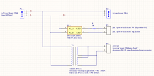

I think it will probably be OK to install a small power supply to keep the +5V rail on all the time and use (inverted) STANDBY to control the main power through an SSR or relay.

Those two light bulbs in the power supply are what NAD refers to as "PowerDrive-S" technology. In standby mode there is some current flowing through the bulbs, but it's not significant.
Most of the power in standby is consumed because the +45V and -45V rails are ON and bias current is flowing through the output transistors. So there's a warm heat sink right next to two big no-name 10,000uF 50V caps which are always under power. No suprise these units often show up on the used market "AS IS" with two bulging leaking filter caps.

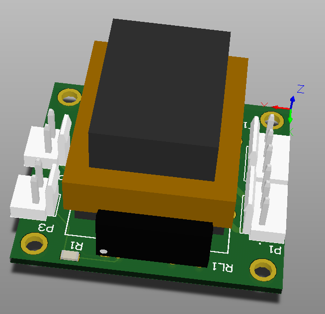

I've got a solid state relay I'll be using to control the AC to the main transformer. This relay will be controlled by the microcontroller pin 15 (high when ON). I'll be installing a small 6.3VAC transformer which will be always on to provide the +5VDC for the microcontroller.

......... ..... ..between the 25VAC bridge rectifier and the 35VAC bridge rectifier there are two light bulbs (!). ... It looks like even in standby these bulbs have ~10VDC across them....
No. Think about the rectifiers. They can't both pass current. The only flow is the idle of the power stage. (Which may indeed approach 20 real Watts.)
Circuit to add standby power and use a solid state relay to switch AC to the main transformer. Parts cost is about $10 not including the small 2 layer PCB. The SSR is driven by pin 15 of the micro, which is high (measured 3.6V) when the amp is not in standby.
