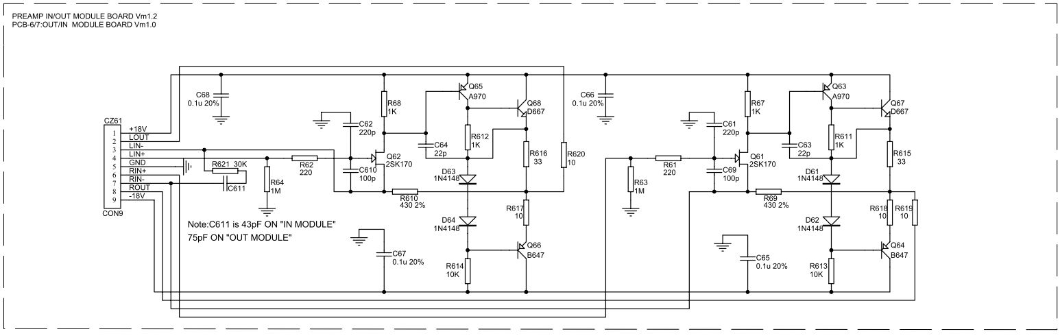

Hello to all, I recently bought a C325BEE unit in full working order, but I was very disappointed with the midrange resolution and finesse.
It seems really strange to me, as I often read about complaints on the treble range, not in the middle.
I want to try a quasi-complete recap of the signal path, mica or polystirene capacitors instead of ceramic ones, new electrolytics (I like cerafine or Nichicon Muse) or substitution with polyester equal values and so on, if anyone is already experienced about this please can suggest something specific to me?
Anyway, having a look at the schematics sincerely I haven't understand what the rc cells R621 and C611 (see schematic attached) is useful to. It connect the two negative input of the stereo line amplifier.
I already seen this kind of topology (with bigger capacitor value) in a differential line amplifier based on two sections that works with balanced input signal. The RC constant of this RC cell suggest that it works form near-RF on (around 3,5 MHz), but:
It seems to me that it has nothing to do with stability, I'm just asking myself if it's necessary all at all, and sincerely I'd need a suggestion about it because I'm not a technician.
Just to give an element to think about, this RC cells disappear in the C326BEE schematics.
Thank you to all

The RC connection is in the C326BEE also: (IN module = 4.7K + 10pf) (OUT module = 4.7K + 94pf (two 47pf in parallel).
Not 100% sure either of the main purpose of the RC network other than to present a common noise floor (reference) between the 2 channels.

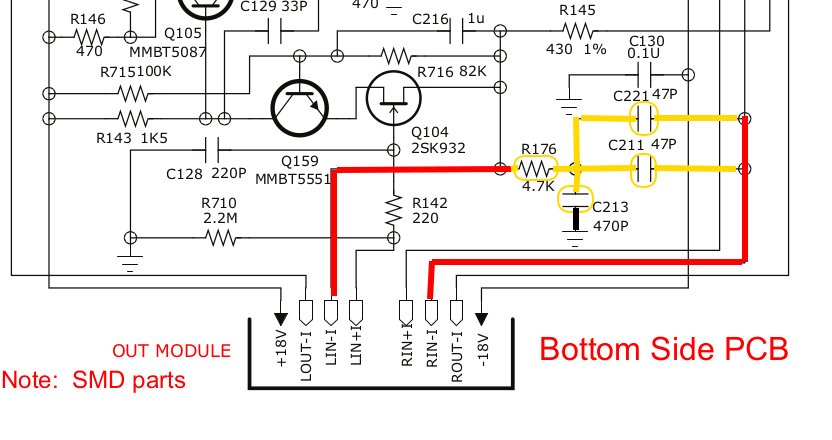

Anyway, sincerely I can't manage to understand the function of C213 (470pF to ground) in the out module of C326BEE, seems like it make the two channels works different, isn't it? bah, too low technical skill 🙁
C213 is bypassing high frequency noise to ground. And being that the node is connected to the L- and R- network, makes sense trying to eliminate as much noise from this node as possible.
I look at these caps+resistors like the RC snubbers that are used to quiet the switching noise from power supply rectifier diodes. The C325BEE uses only 10pf caps across the secondary connections to the diode bridge for both that normal and high power supplies. Still it's a LC network (coil of secondary and cap) working to reduce HF / EMI noise.

"C213 is bypassing high frequency noise to ground. And being that the node is connected to the L- and R- network, makes sense trying to eliminate as much noise from this node as possible." yes, it's true, but -Left channel goes to C213 through 4K7 resistor, -Right channel through 94 pF, doesn't this lead to a different behavior between the two channels?

Both R- and L- are "seeing" the same structure (see attached image).but -Left channel goes to C213 through 4K7 resistor, -Right channel through 94 pF, doesn't this lead to a different behavior between the two channels?
