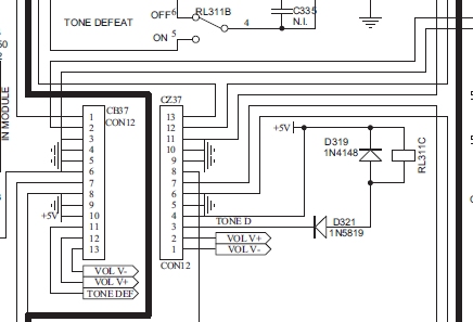

I have this problem with my Nad amplifier. Yesterday the amplifier was in standby mode and i observed that it's starting to make relay clicks constantly. The relay clicks repeated in 2 seconds interval, the amber power led it's no longer lit, the power button not responding. Disassembling the amplifier i found that the clicking relay is the one on the volume and tone board. Measuring the 5v rail on main board i get 0.4v ascending to 1.8-2v synchronized with the relay clicks. If i disconnect the power supply board from the main board, i get stable 5v on power supply board. Any idea how to find the bad components? Thanks!
There's one relay on the Tone-Vol board, enabling tone defeat.
Check D319 next to the relay.

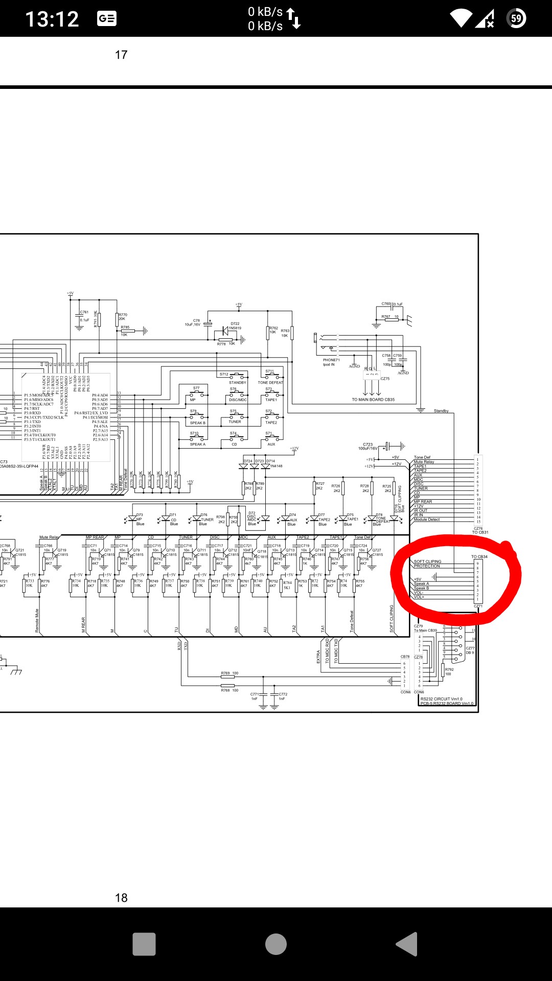

Thanks MarsBravo. I will test test diode. In the meantime i did another verifications. Here is a cable that came from the key circuit and go in the CB34 connector on the main board. If i pull off this cable from the main board i get stable 5v, +-12v, +-18v and so on the other rails, on the front panel all leds is lit, except the power led. With the cable connected i get the same instable voltage on the 5v rail, and 0v on the other rails. As i can see on the diagram, pin8 of the CB34 connector is related to protection.
Then there is a shorting of the 5V rail on this board (and not on the ToneVol board, which respons to the failing 5V only).
There's quite a lot connected to the 5V rail on this Key board... I've a look at it.
