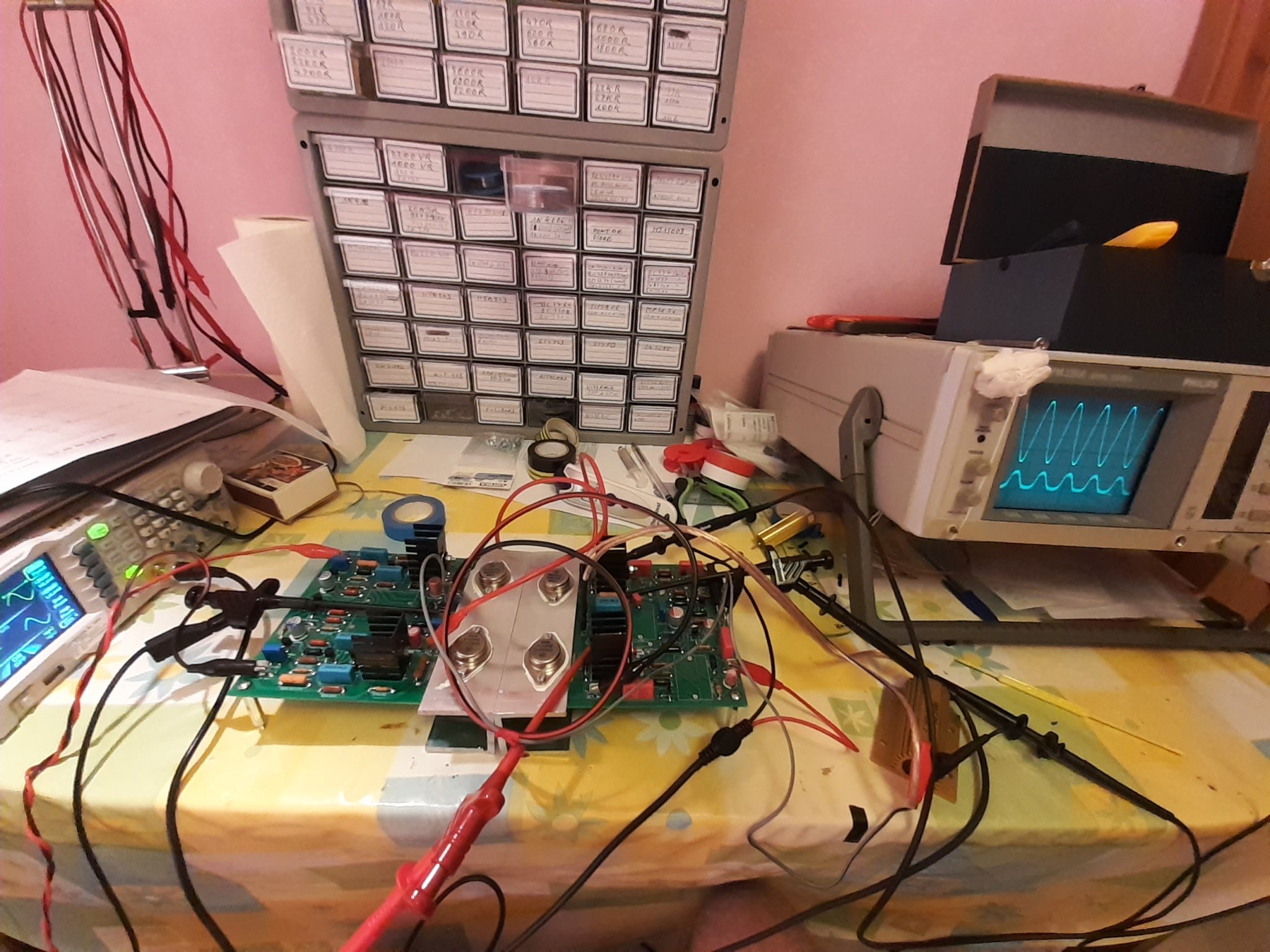

I thus tested with the oscilloscope and by ear for the VBE the 2N2222A in comparison with the 2n5551, my choice fell on the 2N2222A which seems to me a little better to the ear but also on the noise in the data sheet. I also tested the ZTX690B and 2N6428 it's works but it's not better.
For the output ones I tested:
BUV22 but they are not really suitable for the ear it is not very convincing and I think that the bias and the drivers are not suitable, there is too much crossover distorsion with MJ243/253 drivers.
Mj15024 they seem better to the ear than the Mj15003 but they are only 15A so there is no point in taking T0-3 boxes, there are also too much crossover distorsion with Mj243/253
2N6341 They are suitable and sound better to the ear making 40mhz for 25 amps they are probably the best performing so I have chosen it for my new amplifier.

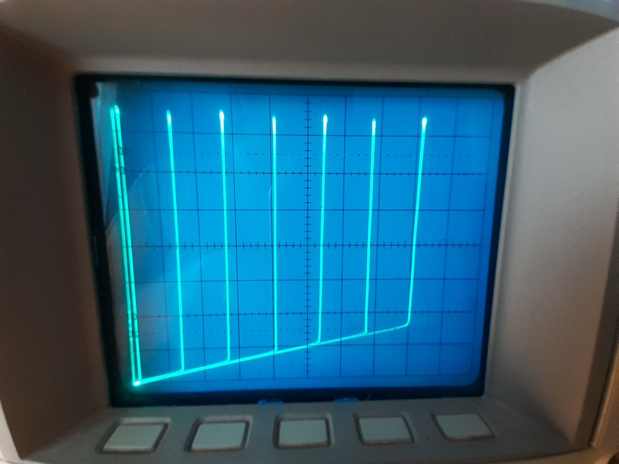

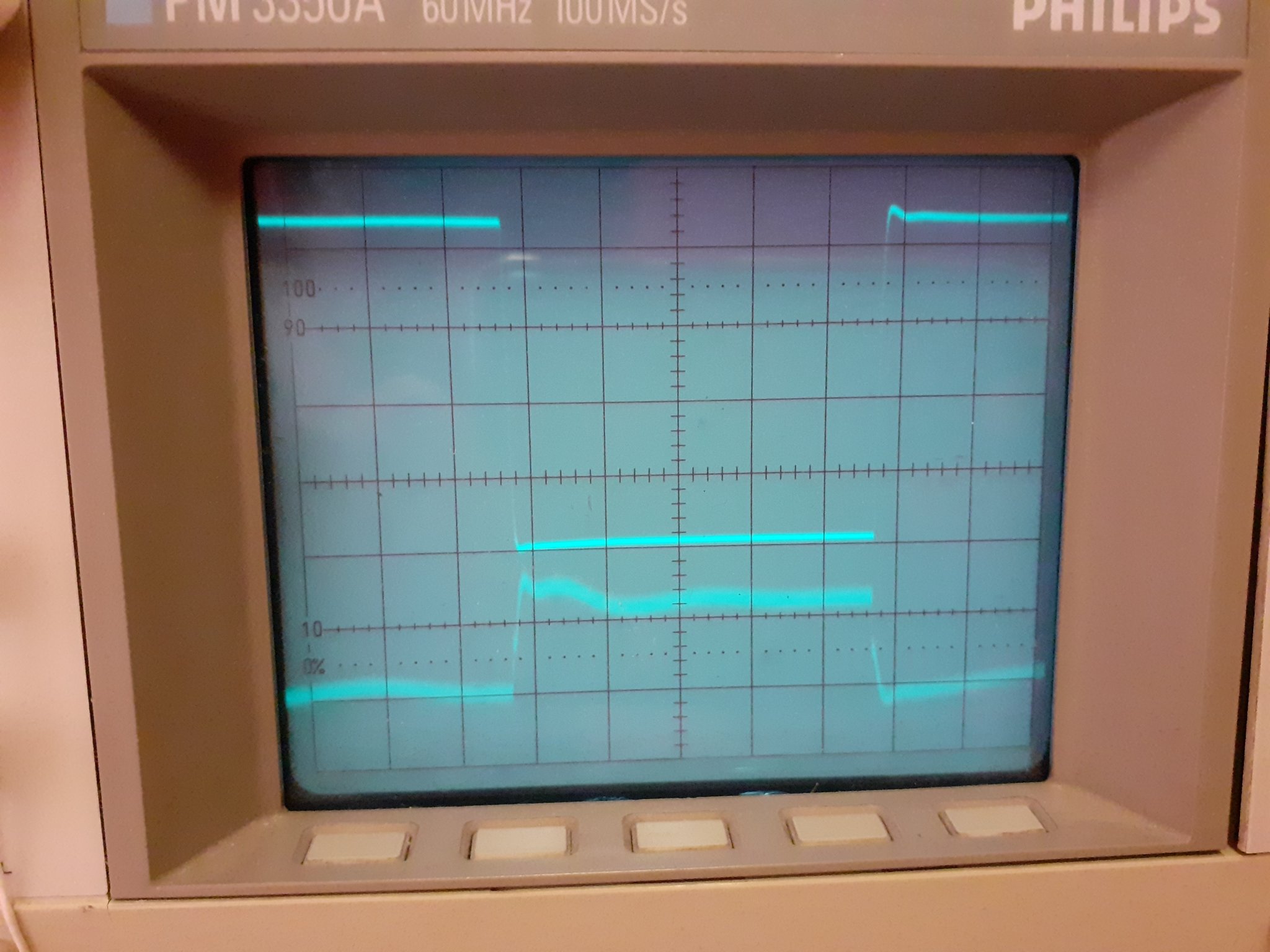

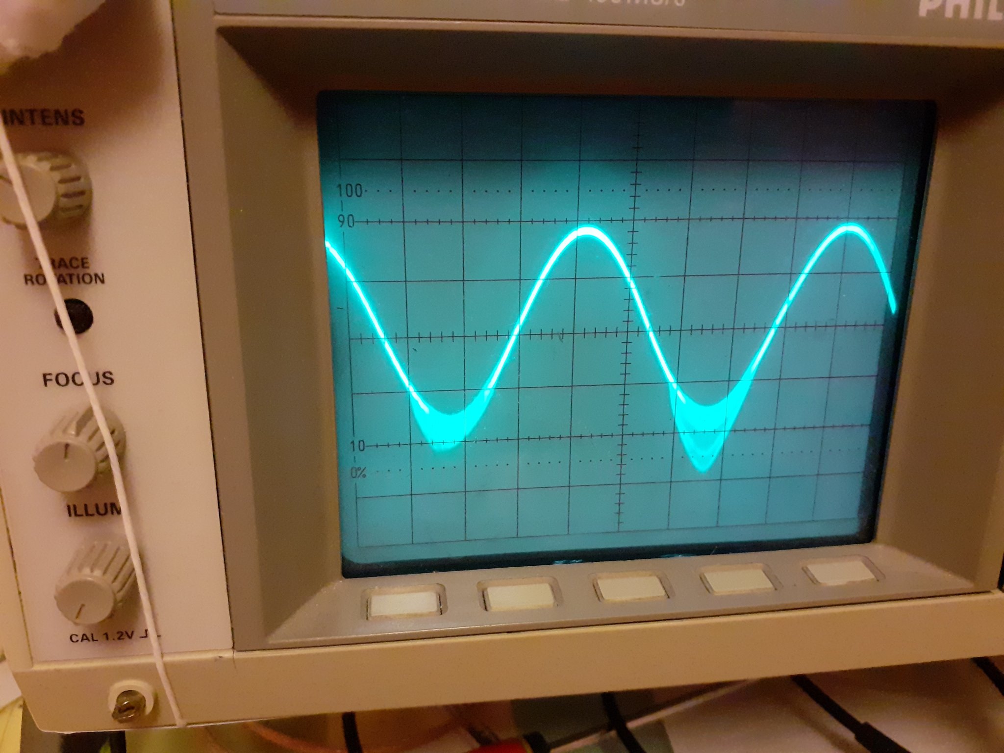

I had noticed Phase compensation problem with 2N6341, I didn't initially understand the problem, I was able to fix it as you can see later in the topic.
The adjustment of the phase compensation is more or less delicate it depends on each type of power transistor used but it also depends on the PCB layout. If the MJ15003 and the BUV22 are quite easy to adjust, the same is not true of the Mj15024 and especially the 2N6341. Having done the setting for the PCB layout used in my amplifier (V2.1) I cannot give the optimal values for the latest files I give here (V2.5)

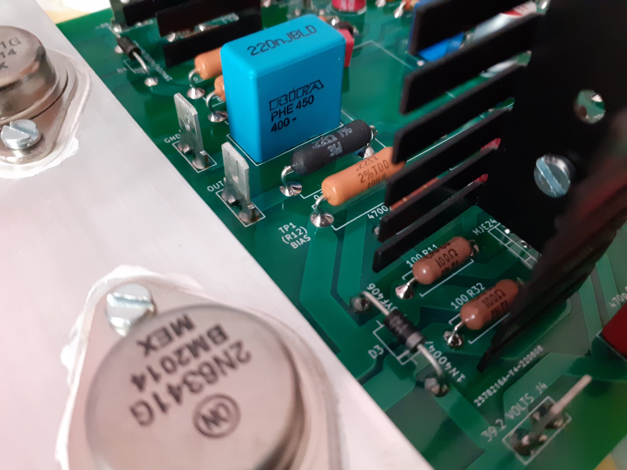

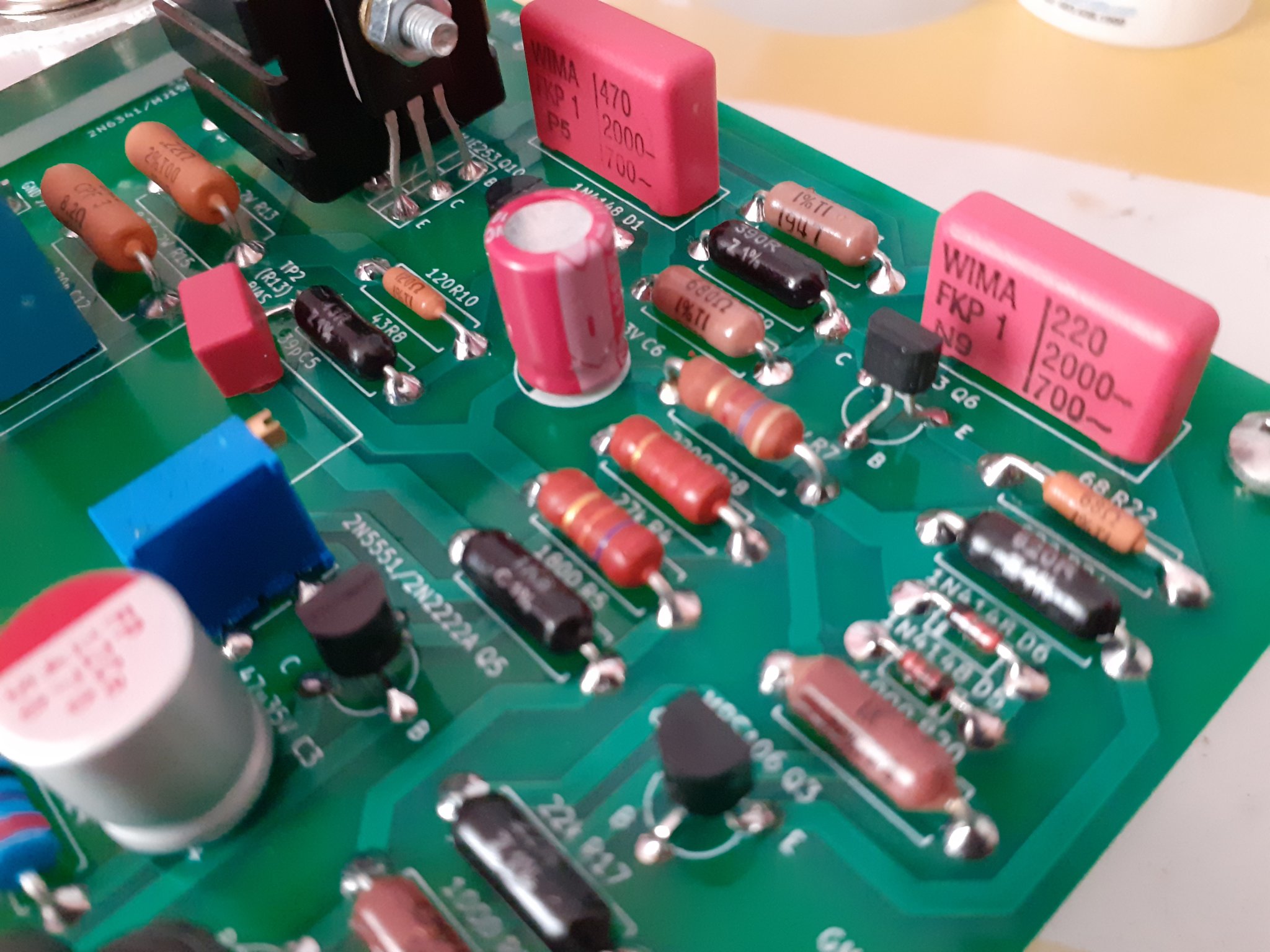

For the components I chose the original MPSA06/56 from diotec and not those from central component as for my old creations, indeed central component makes copies and not originals, something that I did not know.
For capacitors I chose for the amplification card very high voltage WIMA and also for the miller. (on my old version I took 39pf in Mica, there I took 33pF and 47pF)
i take organic polymer low esr for the AMP BOARD
For the NAPS Board please note output capacitors 10Uf must have a esr >1,7 ohms for stability of the supply.

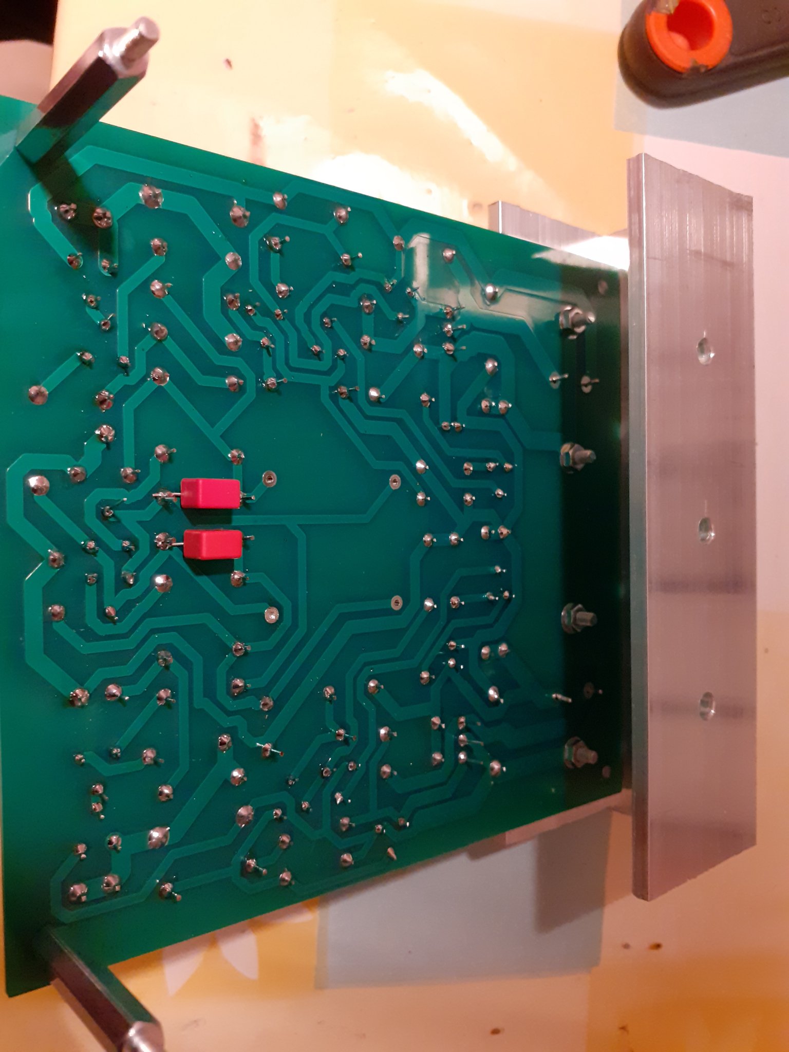

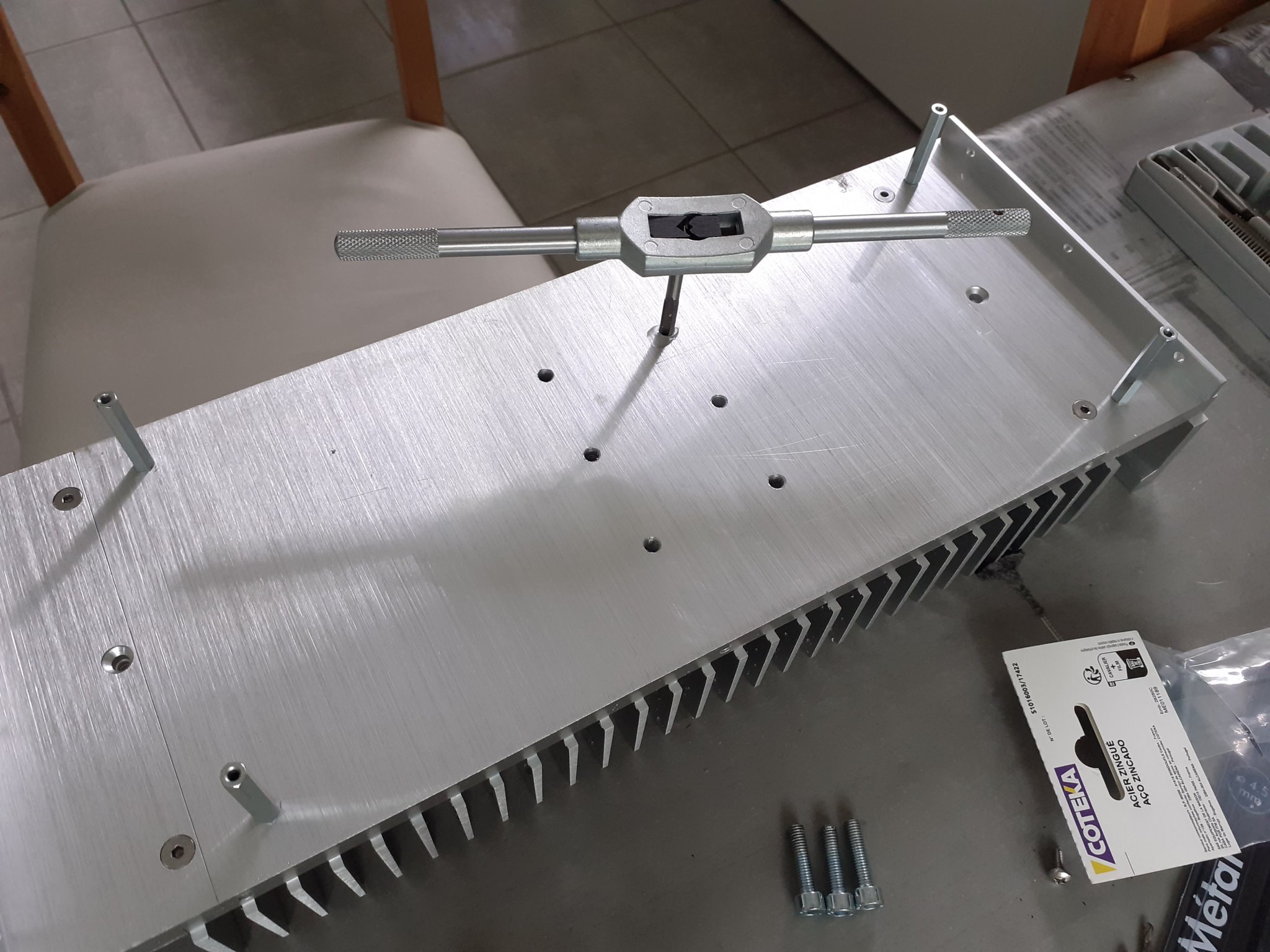

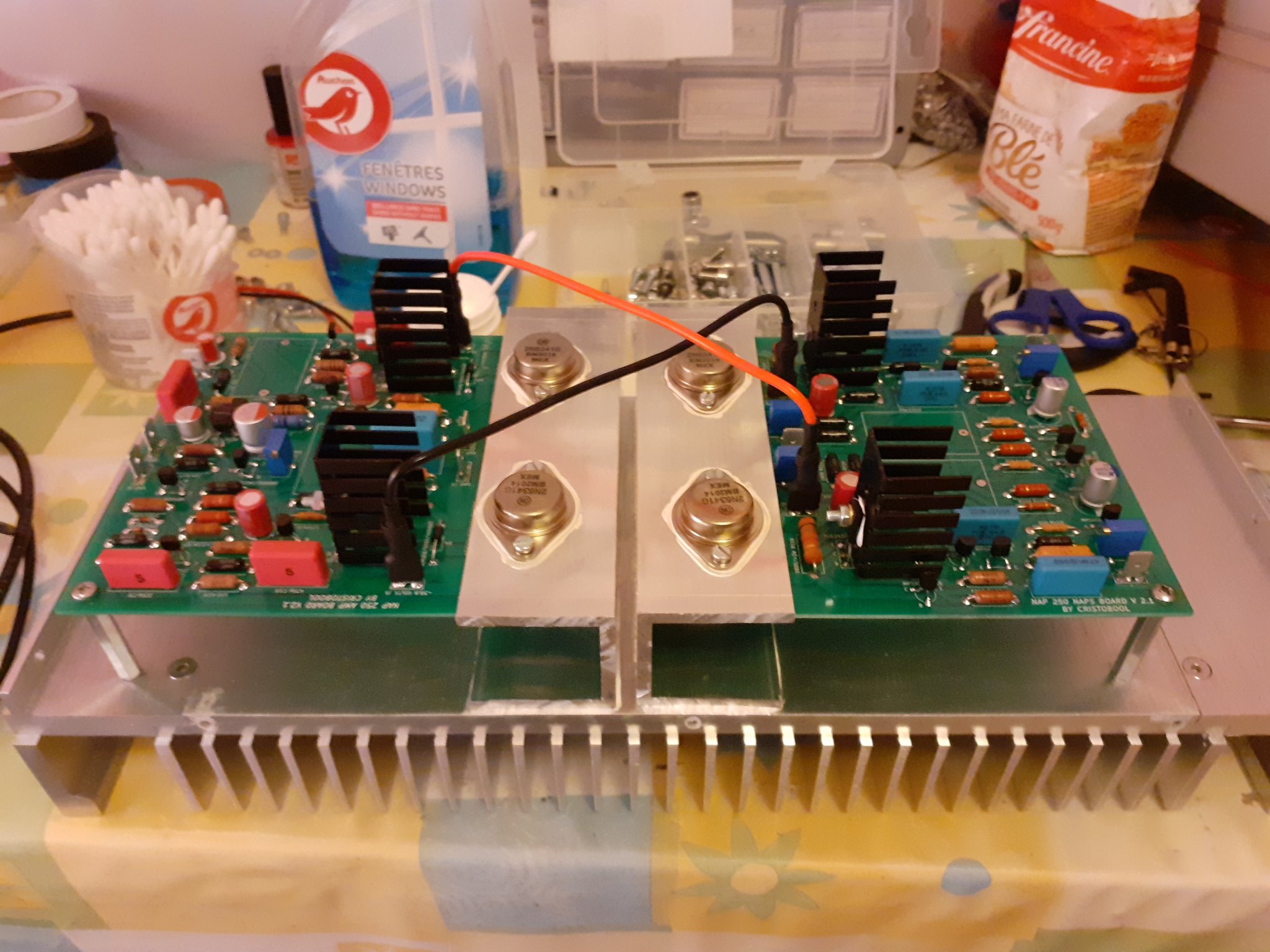

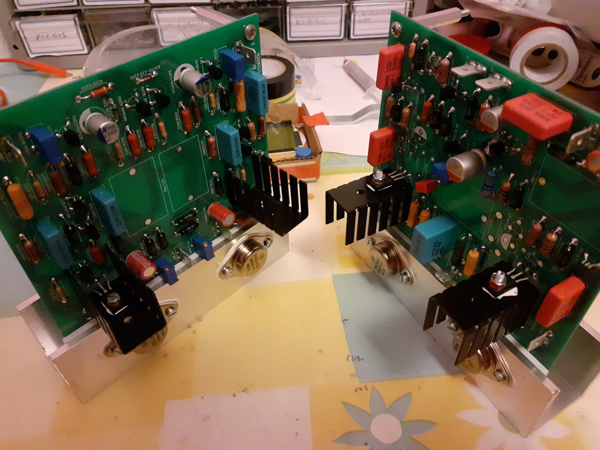

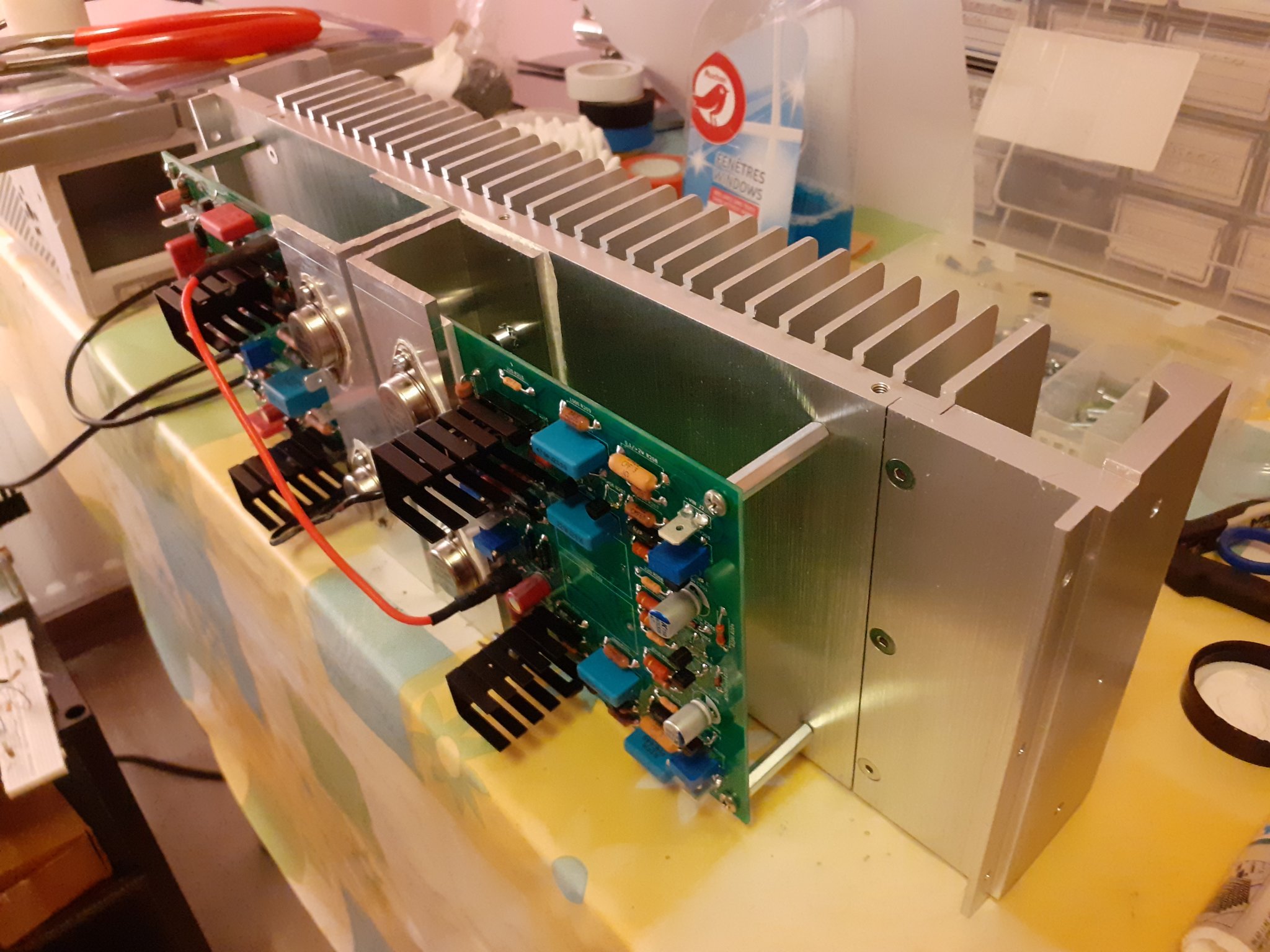

The 4 cards are mounted, I still have the last heatsink to manufacture, I am waiting for my aluminum case and the last parts in order to start the final assembly, I expect to receive the case in less than 15 days.
to note unfortunately on my PCBs I made a footprint error on the 39pF capacitors which were far too big, I was deceived by a bug in the Mouser search system which was giving me 4uF capacitors instead of 40pF.. .
I have since corrected the error in a new version of my PCBs in Kicad but my PCBs being already ordered I use those with this footprint error.

Here a caracteristics of a transistors i use two différent resistor for the base 100K and a 3300ohms for testing different currents
Here you can see phase compensation problem

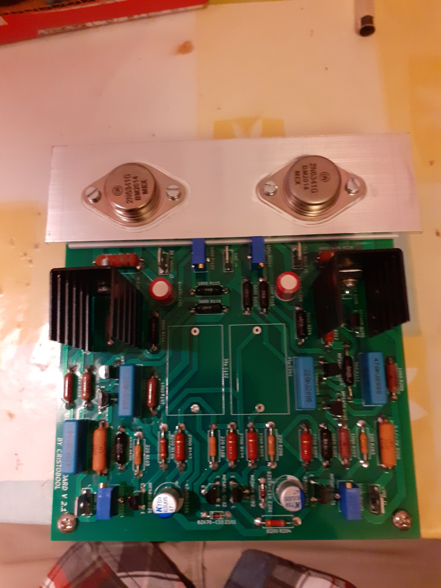

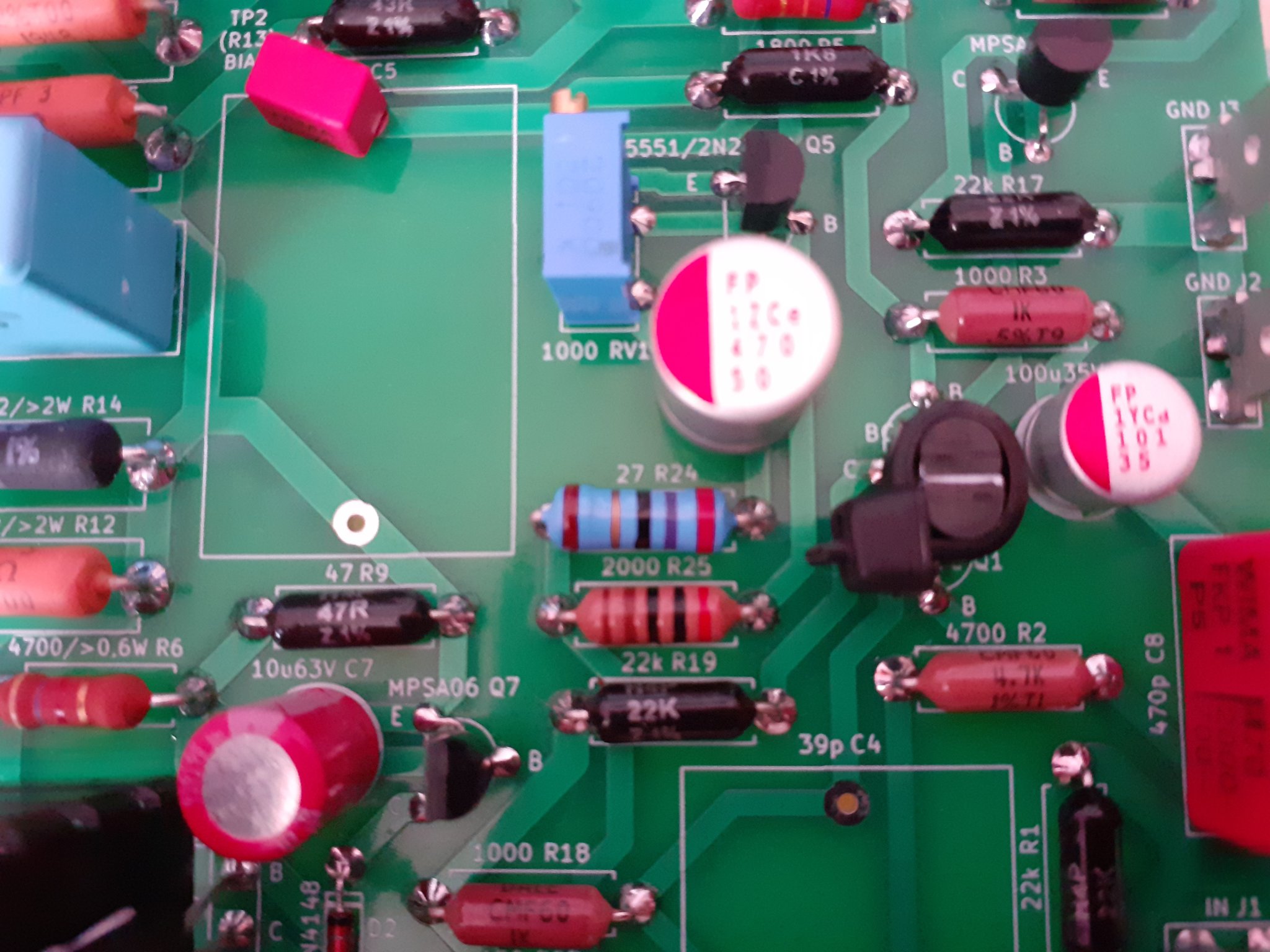

First regulator board, note larges Capacitors are organic polymers low esr and not electrolytics. C105/205 later changed by united chemicon electrolytic with 1,8 ohms ESR

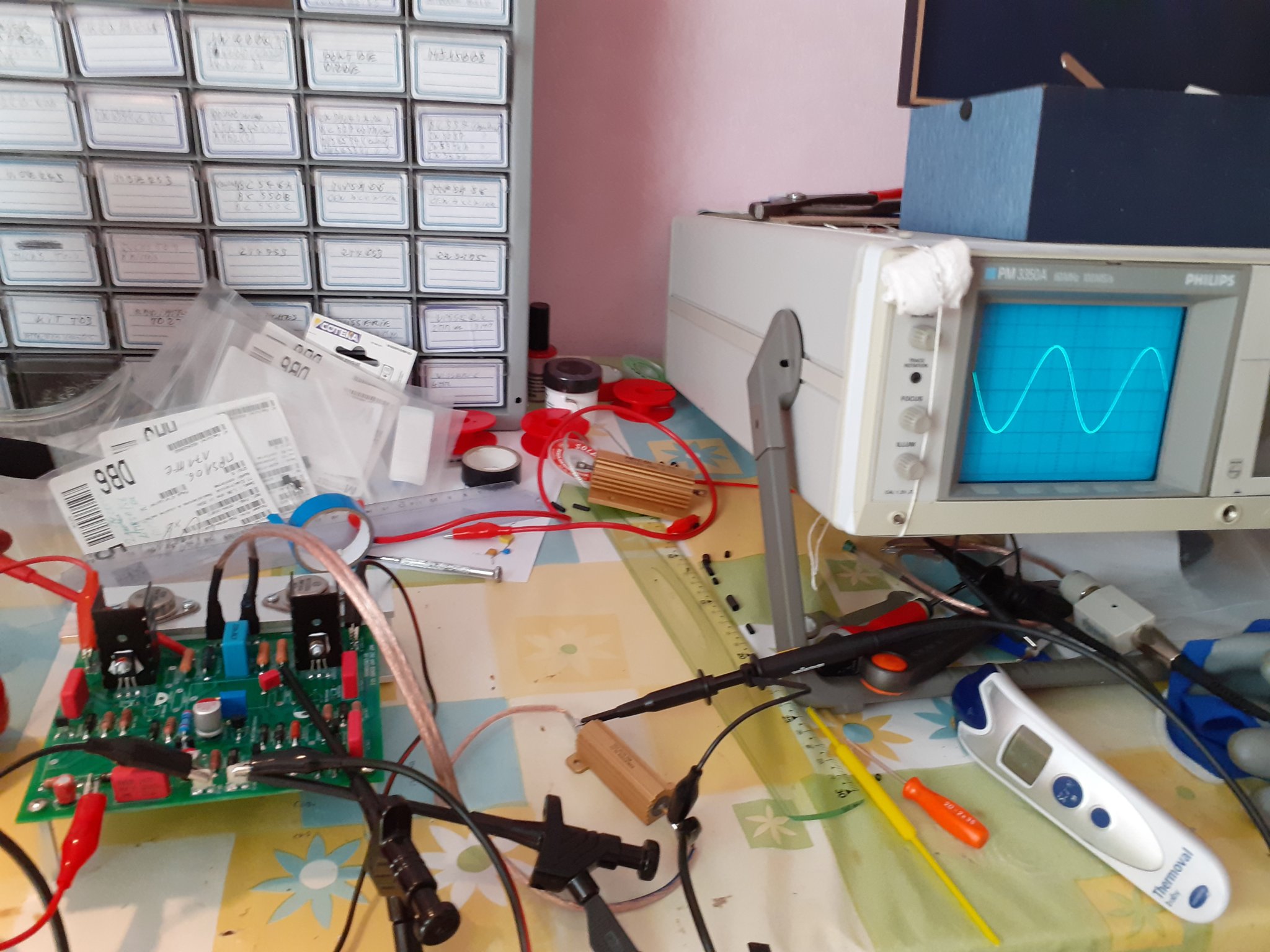

On the first amp board there are not the circuit protection i want to test with ears with and without the circuit protection when the amplifier will be finish.
here on a 2Ohms resistor
here the test of stability on the regulator down it's a power rail of the regulator board it's about 100-150 mv variation on a square wave 1000Hz 100mV in the amp
47pF are on the other side...

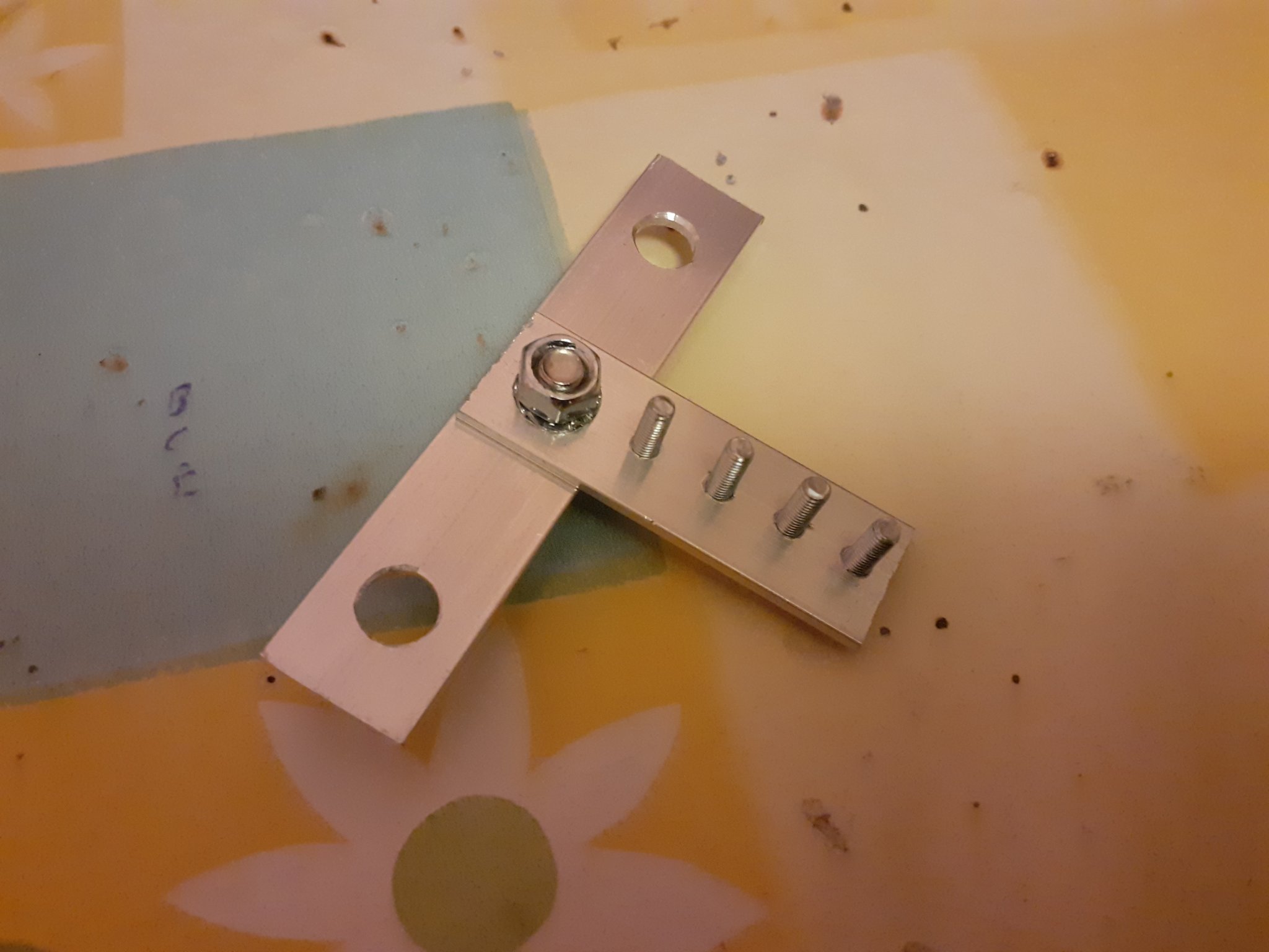

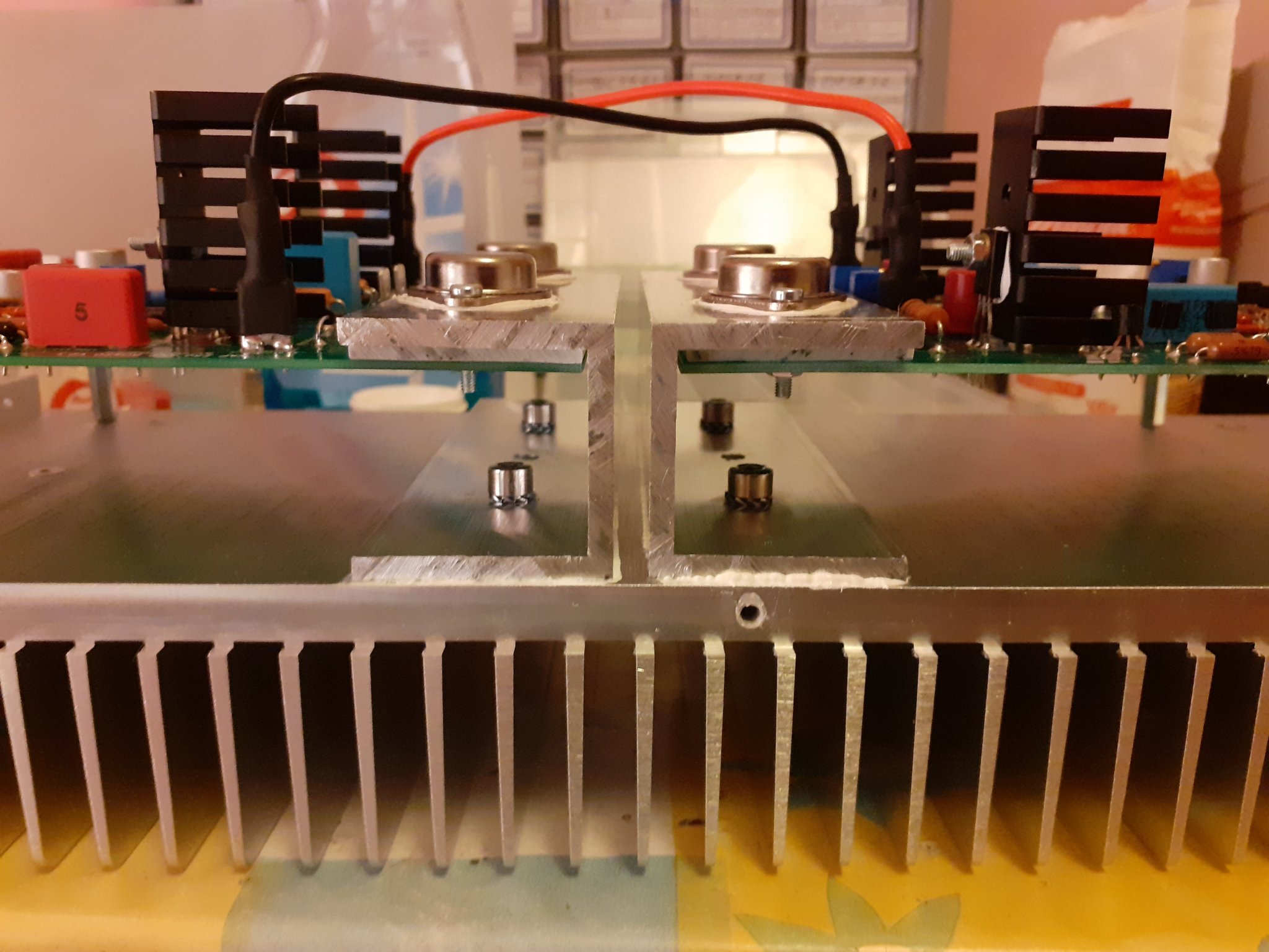

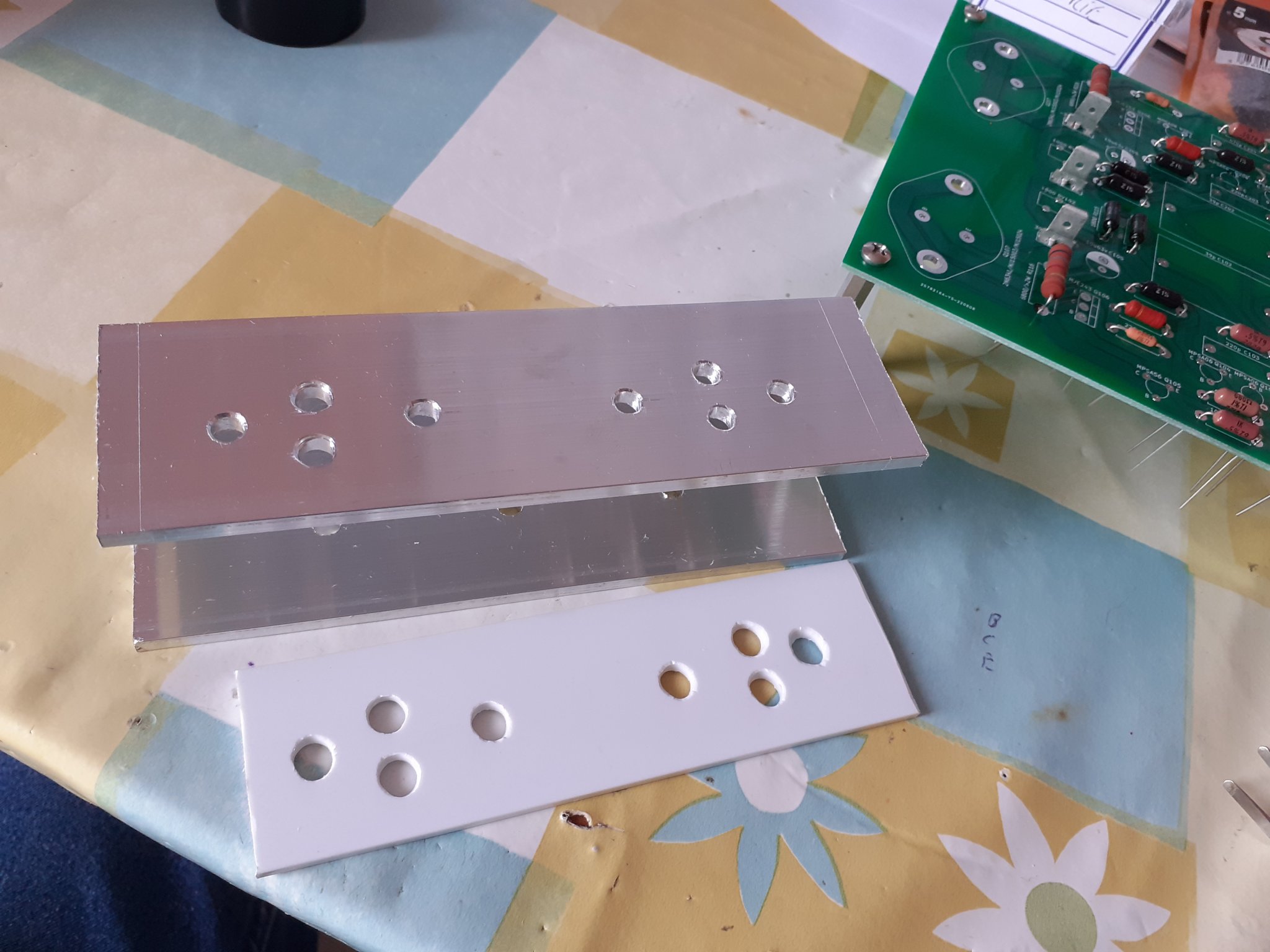

a heatsink with his isolate board to isolate from the PCB
Here V2.1 correct values for phase compensation are:
R26 1800 ohms
R27 1800 ohms
R29 2000 ohms
R30 2200 ohms
(note for the drilling of the heatsinks that the two output transistors are not perfectly aligned either on the AMP BOARD or the NAPS BOARD)

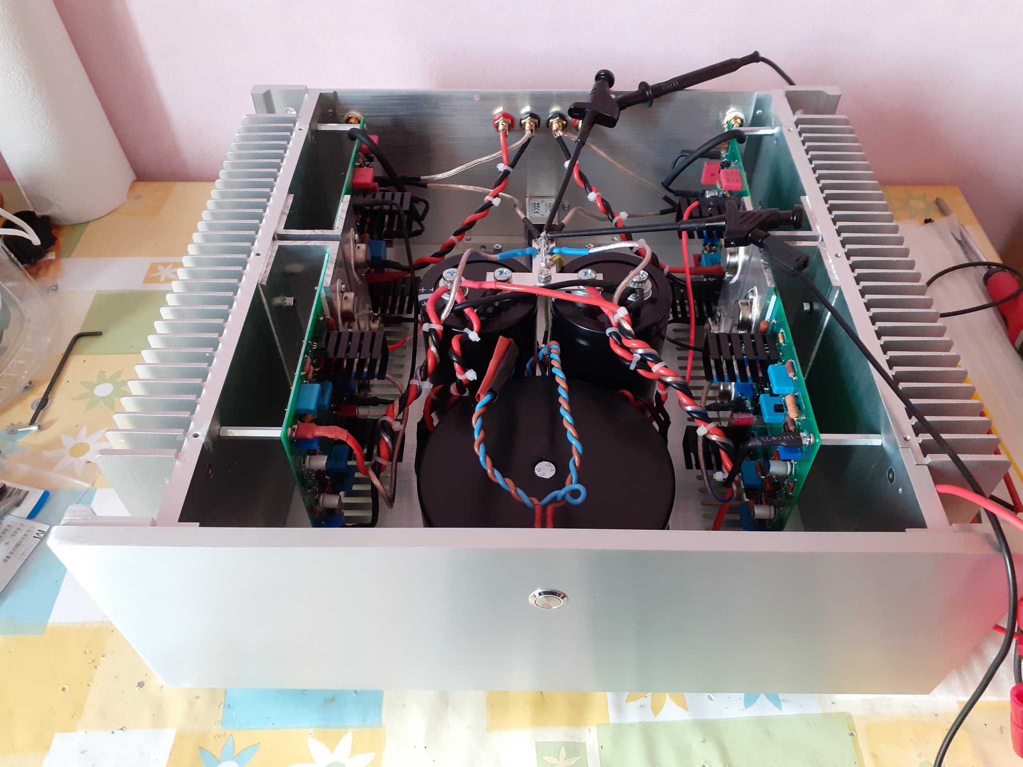

Hello here is progress of the project. unfortunately I'm not moving fast, I must say that I'm very busy with my work these days.
I finished and tested the second regulation board
then i cleaned the solder flux from all four boards.

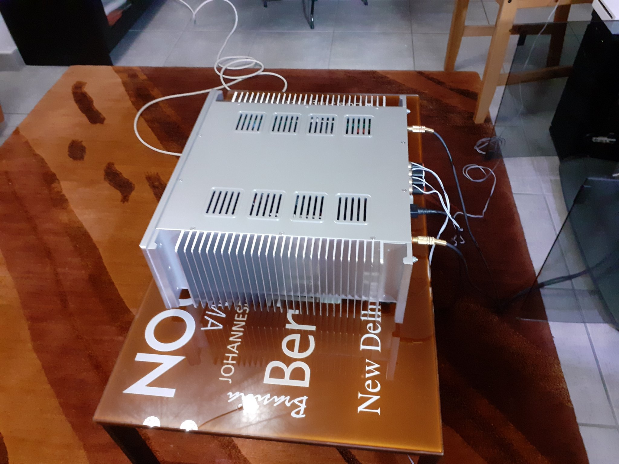

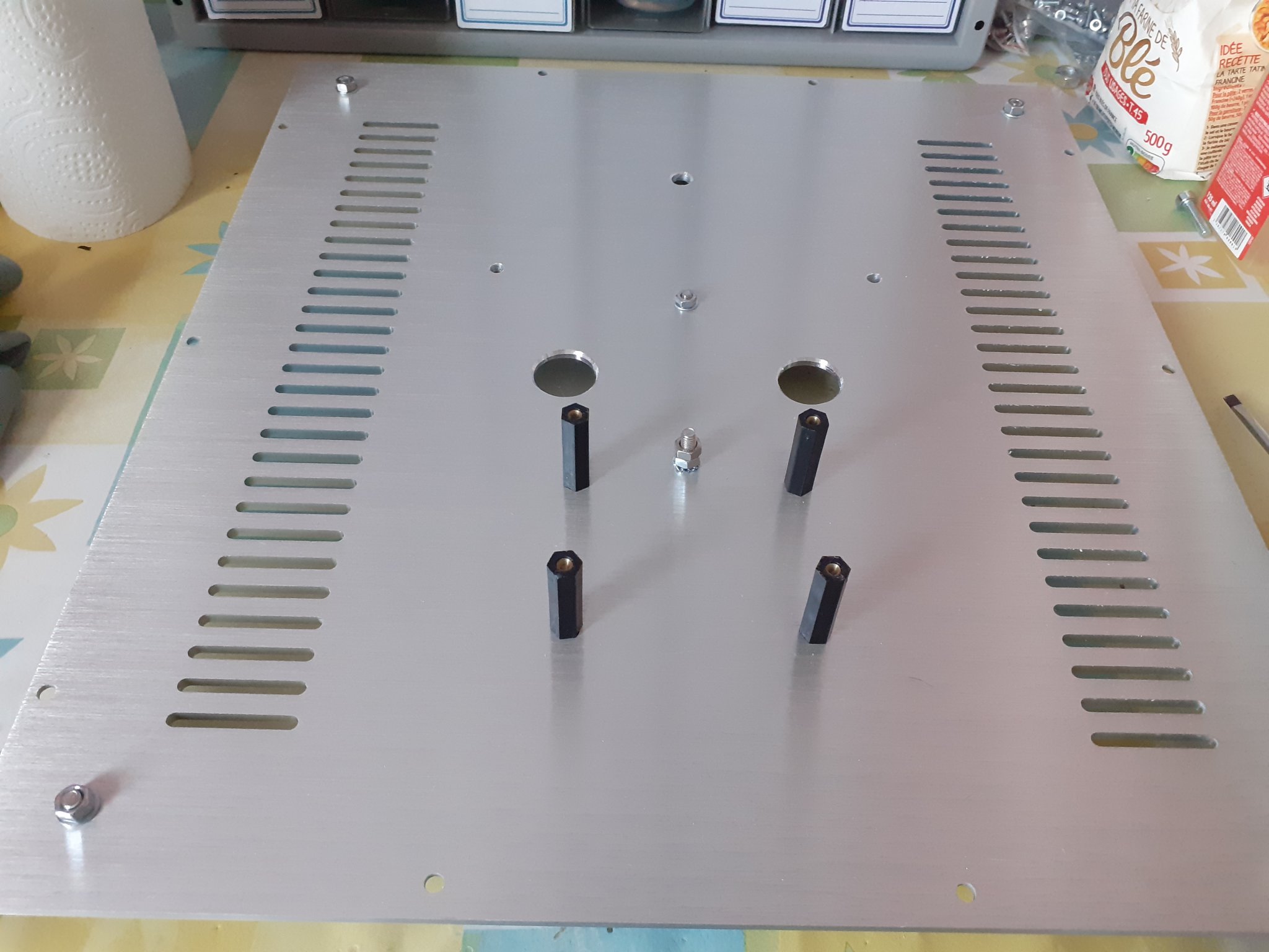

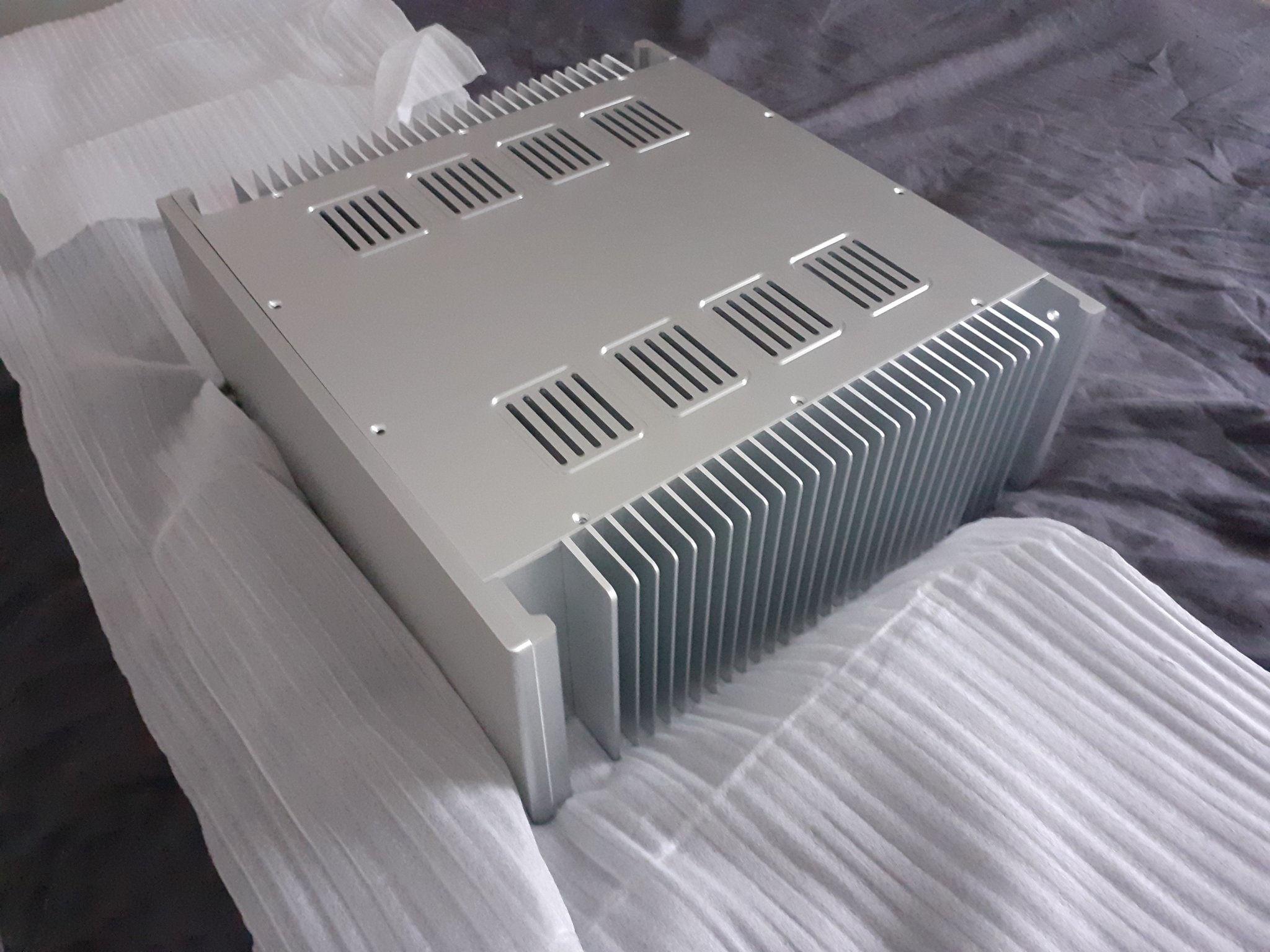

I received the final box

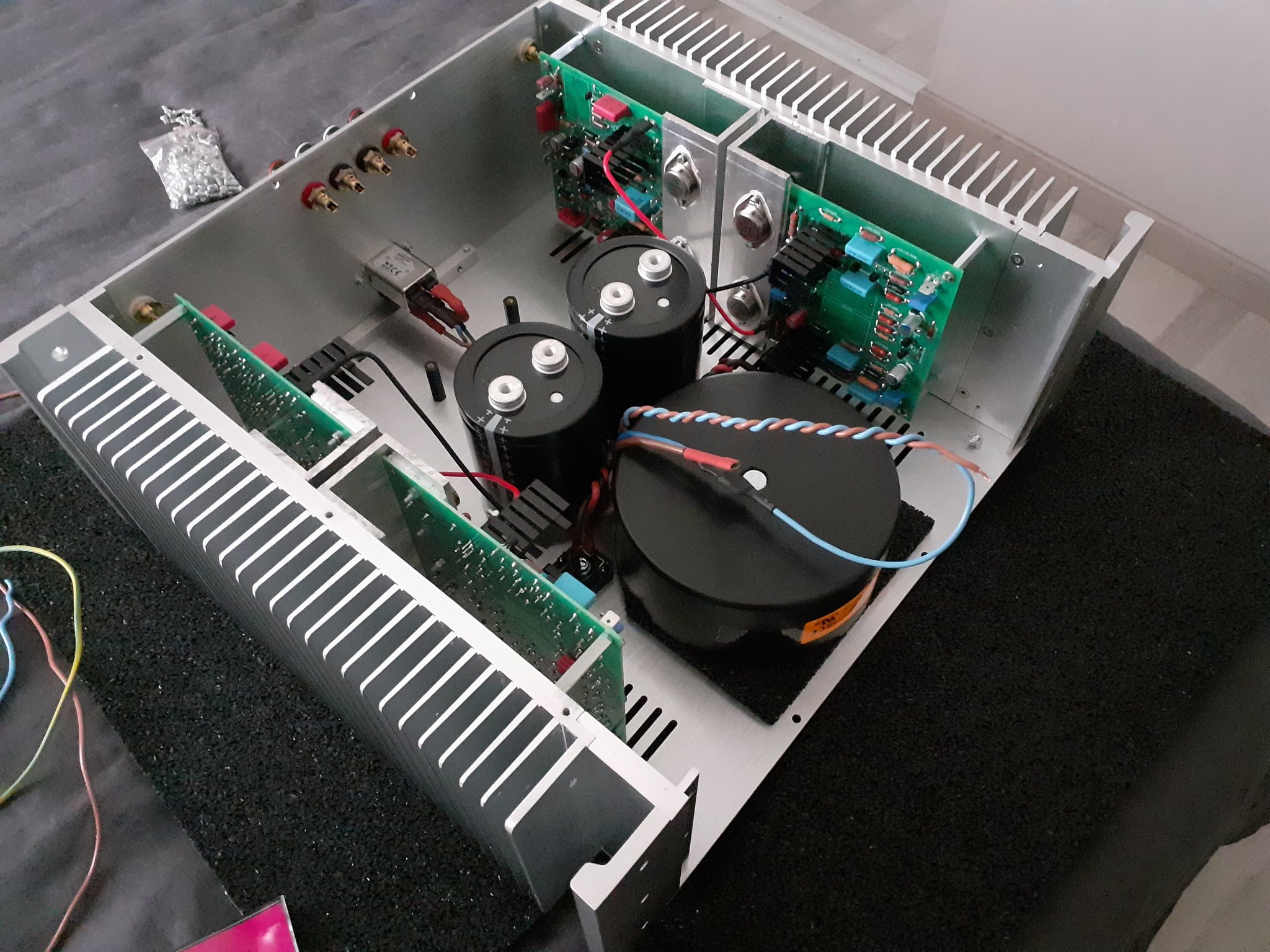

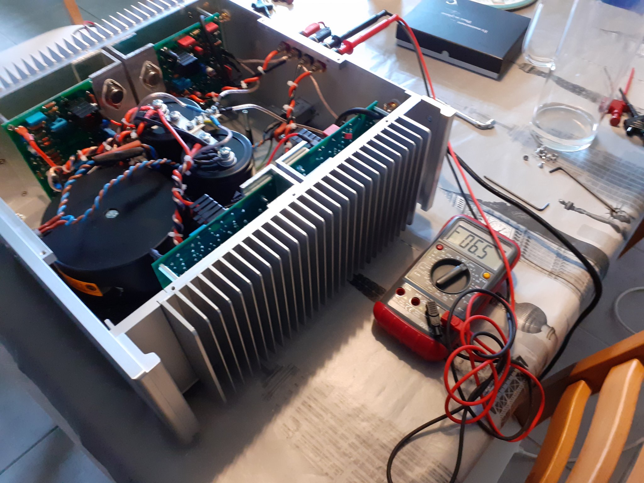

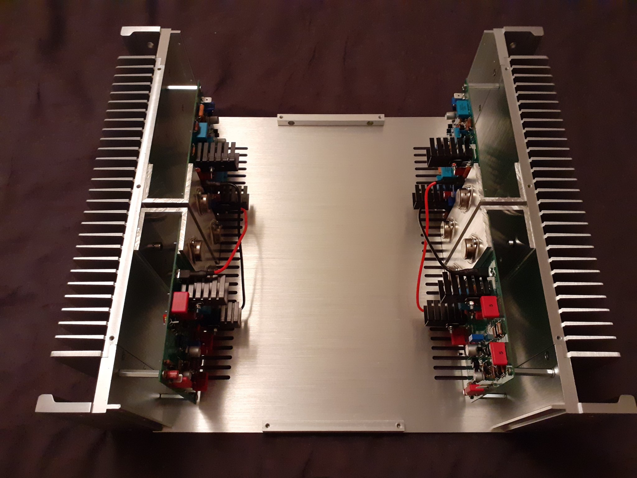

and I mounted the cards on the two heatsinks of the box and it was not without difficulties but finally we got there.

Wow, that's a great box that would suit even a medium size class A amp. You will never need that amount of heatsinking for any NAP model though. Like other early models, the original 250 types just used the aluminium case with sliding tray (if fitted) as a heatsink and that proved fine, even in warm climates. It may not be a problem or matter much to you, but having excess heatsinking means a bias that never stabilizes and the bias level is often important for consistent, best sound quality.
Yes the heatsinks are oversized, but who can do more can do less. It is true that by heating very little the bias will remain lower, maybe I should just raise the bias a little at rest.
I bought this box on audiophonics. It's made in China in fact, you can find it on ebay. i chose it because it was suitable for the size for the assembly and for the aesthetics too.
I'm really confused about the thermal regulation of the amp.
Even by sticking the temperature detection transistor directly on the heatsink, the latency time may be too long, moreover, whether it is mounted on or under the pcb, it will find itself in the middle of a draft. cause of the opening in the case.
this amp is only really reliable in a closed box or possibly open on the top with louvers, otherwise it may be unstable.
On real NAIM amps the VBE is not mounted on the heatsink and this is not a problem, I have tested this amplifier at good power there is no thermal runaway problem (out of 2 Ohms the amplifier drawing 4 amps continuously). After, as on the original NAIM amps, it should not be pushed like a PA amp. in HI-Fi use there is no problem.
The fact that the box is ventilated can easily be resolved by plugging the vents. once finished I would do some tests anyway, I would see if there is a problem but honestly that's not what worries me.
I still have some wiring to do, the essential is done. I expect my last order not before December 16 for the switch that I put on the front and a protection relay for the loudspeakers.

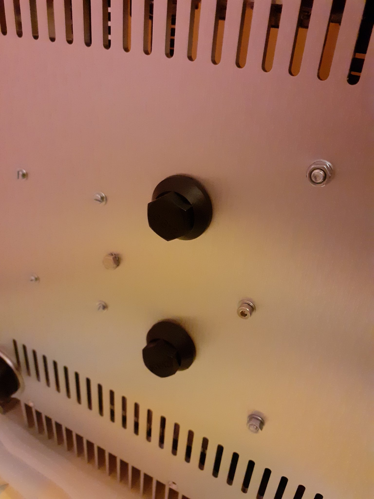

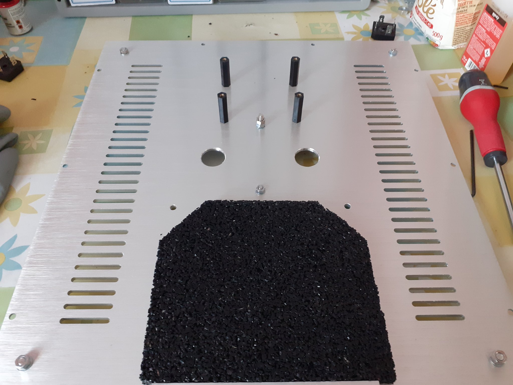

The filter capacitors are isolated from the chassis by parts specially sold by EPCOS for these models. This requires making large holes
They are 22,000uf 100V, 35A, ESR 6 milliohms.
A thick rubber plate under the transformer for vibrations and the passage of cables which is done from below on this model of transformer.

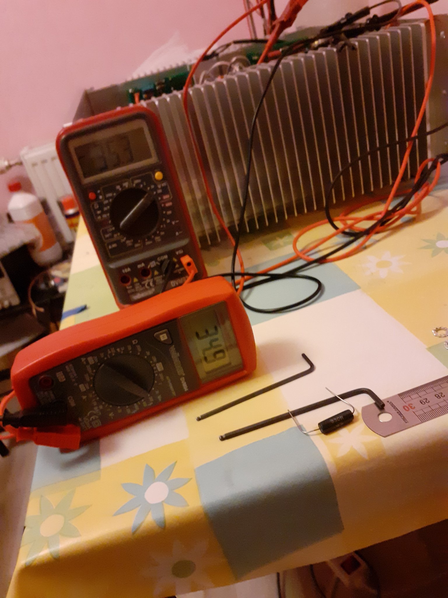

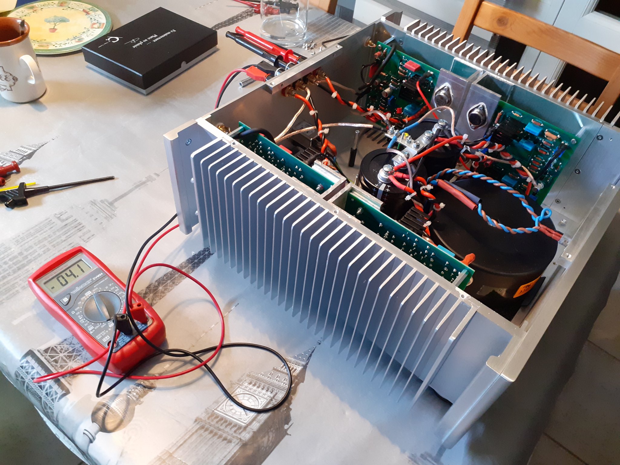

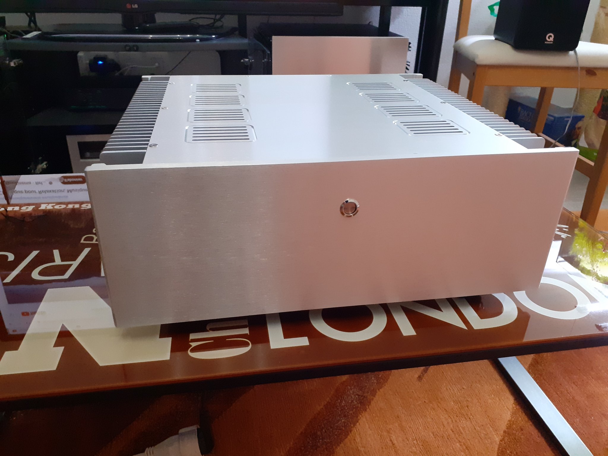

I finished. I haven't had a mass buzz issue so I'm happy. I had a problem adjusting the supply voltage because I had made an assembly error. I had taken 15 volt zener diodes instead of 10 volts result I could not lower the power supply below 45 volts. Once changed the zener the problem was solved. As for the protection relay for the loudspeakers, the one I was planning to put in is not suitable I thought it had a built-in transformer but in reality it is a switching power supply so there is no question of putting that with all the high frequency noise that it will generate. I might see to making myself a protection relay later...
Precisely about the offset voltage at the output I had left one of the two amp cards without the protection circuit of the output stage to do comparative tests between the two channels in order to know if it really improves the audio quality to remove it (I hadn't heard a difference during my tests on the laboratory power supply)
Well, the residual offset voltage when the amplifier is turned off takes much longer to drop if the protection circuit is not present, it persists at more than 100 mv for more than a minute. Once the protection is mounted, the two channels react the same. So i don't think it's necessarily reasonable to remove this protection if you don't have a loudspeaker protection relay.

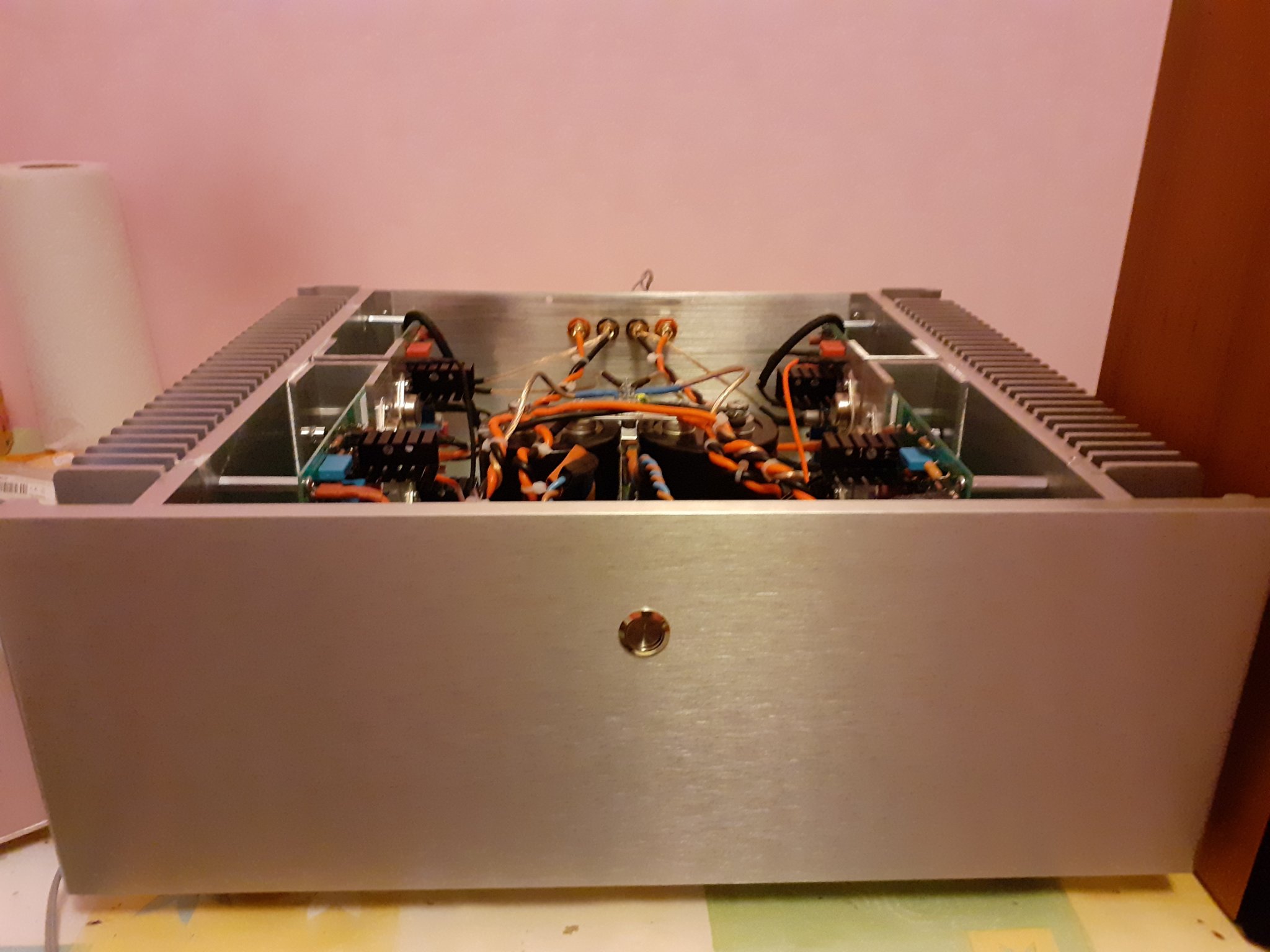

here last pics ! and a little video, i will finalise Kicad files, schematics, gerber files and components list later and i will share it.

supply voltage adjustment (39.2V/-39.8V)
Special screw to insulate filter can.
Dc offset -6,5mV
Dc offset -4,1mV
Reactions: 1 user
So my Amp works fine since few days i share my Work here for those who want made NAP Clone, i will share the components list later i have to do it correctly.
