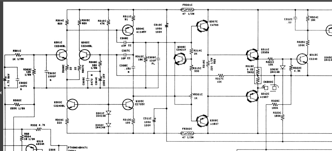

There is a manual on HiFi Engine:
Nakamichi AV-10 Audio Video Receiver Manual | HiFi Engine
It is one complex piece of kit although the five power amps look conventional.
The signal processing and switching is hugely complex with LSI chips dotted around. You would need an oscilloscope to trace a signal from input socket through the various stages.
