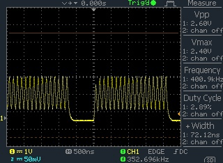

So, going on the path from the rear jacks backwards I traced along the following symptoms while playing the silence CD-R:
Easier done than said, I go ahead and try to look at the eye diagram on the RF input of the main board (while realizing the afterglow mode on my scope doesn't clear itself up over time), and this is what I see on a pressed CD:
- Output filter OpAmp: just repeats the noise that the DAC sends into it, once the DAC shuts up there's no noise, so it's ruled out
- DAC: sends out the abomination on the second picture above on the L and R outs, and the input data line gets some blips of '1' bits at times, while I assume silence should be all '0'? Sure enough, shorting the data in to ground makes it shut up. The output waveform is somewhat like this:
- Digital filter / Resampler: Gets 1-2 of '1' bits every now and then on the data in line. Shorting the data in line to ground makes the whole downwards chain shut up, so I assume the Resampler is getting garbage data on the inputs.
- Sony DSP chip: the CRC incorrect flag line raises 1-2 times at a similar timing to those 1-2 '1' bits. (I don't have a second probe on the scope to compare)
- All the other frequencies seem to be spot on, aside from the PLL — it's constantly 0.2MHz too high, but locks on to the specced 4.2ish MHz just fine once the CD is spinning.

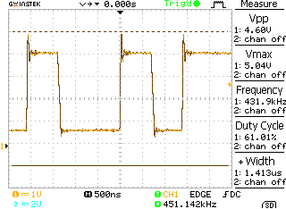

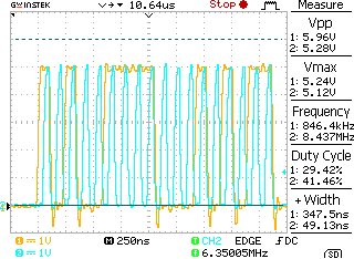

More hilarity ensues... My wife's been a champ at reverting all the damage I do, and this time is no exception — after she had a few hours to tweak the optical knobs and things the CD drive now even reads the cheapest CD-Rs it wouldn't want to before. The sound, however, is still trashed.
Looking at the input bit clock of the SM5840CP, the resampler, it looks kinda funny? But overall stable:
The input data line also has some weird things from time to time:
Not sure if as a result of that, or due to the resampler itself being faulty, it's output clock to the DAC doesn't make any sense at all

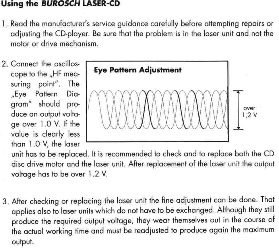

It's been decades since I have owned a Nakamichi 3 CDP. What I do remember about it that I hated the sound and sold it soon after I got it.
Depending on the chipset, the optimal RF eye pattern value is 1.2 to 1.5Vpp, + and - 0.3V.
I have that Burosch CD, which I used for the adjustments and fault-find the broken CD players.
I see from the service manual, that this particular CD player requires adjustments of focus, sled, spindle, tracking... trim pots.... so it appears that someone before you had a go at turning the trim pots without proper measuring gear and service manual...

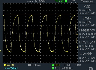

@Extreme_Boky
Yeah it does, but we've went through all those adjustments already.
The eye diagram had different amplitudes depending on which CD I used, some plants better some worse, and CD-R the lowest.
The subcode is being read perfectly (nearly no CRC error signal aside from when moving tracks, time code and TOC display on the first spin after loading the disc).
Moreover, the weird clocks I posted above were due to me using the scope at the 1x probe setting. Changing it to 10x showed me fairly decent discontinuous clock that's the norm for those upsampling converter players.
And the weird noisy data bits edges are aligning with the clock edges. So something is making the DSP send high pulses to the DAC for no reason. Given the DSP has RAM in it and a bunch of other things, I suspect whatever part of it that extracts the audio data from the bitstream just went out of whack?

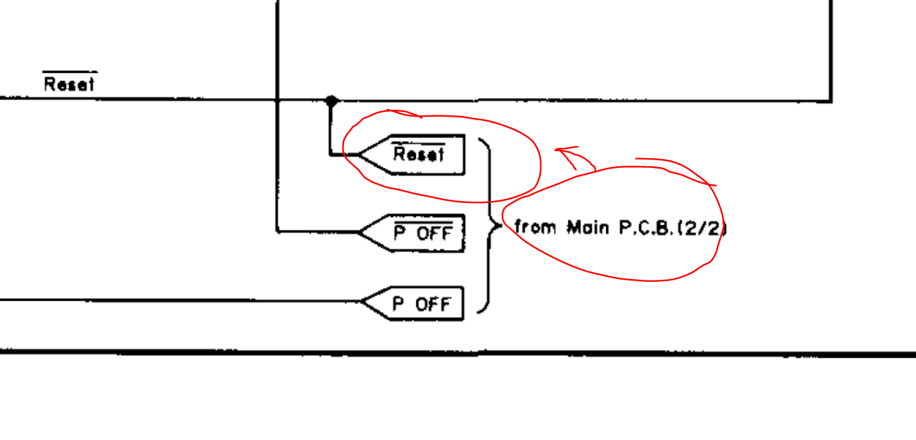

You mentioned before that you did some re-flow, which stabilised the Clock X801. Make sure it is still stable.
The Clock should become active as soon as you turn the CD player ON, and it should stay stable. Check what happens with the RESET signal at that time....

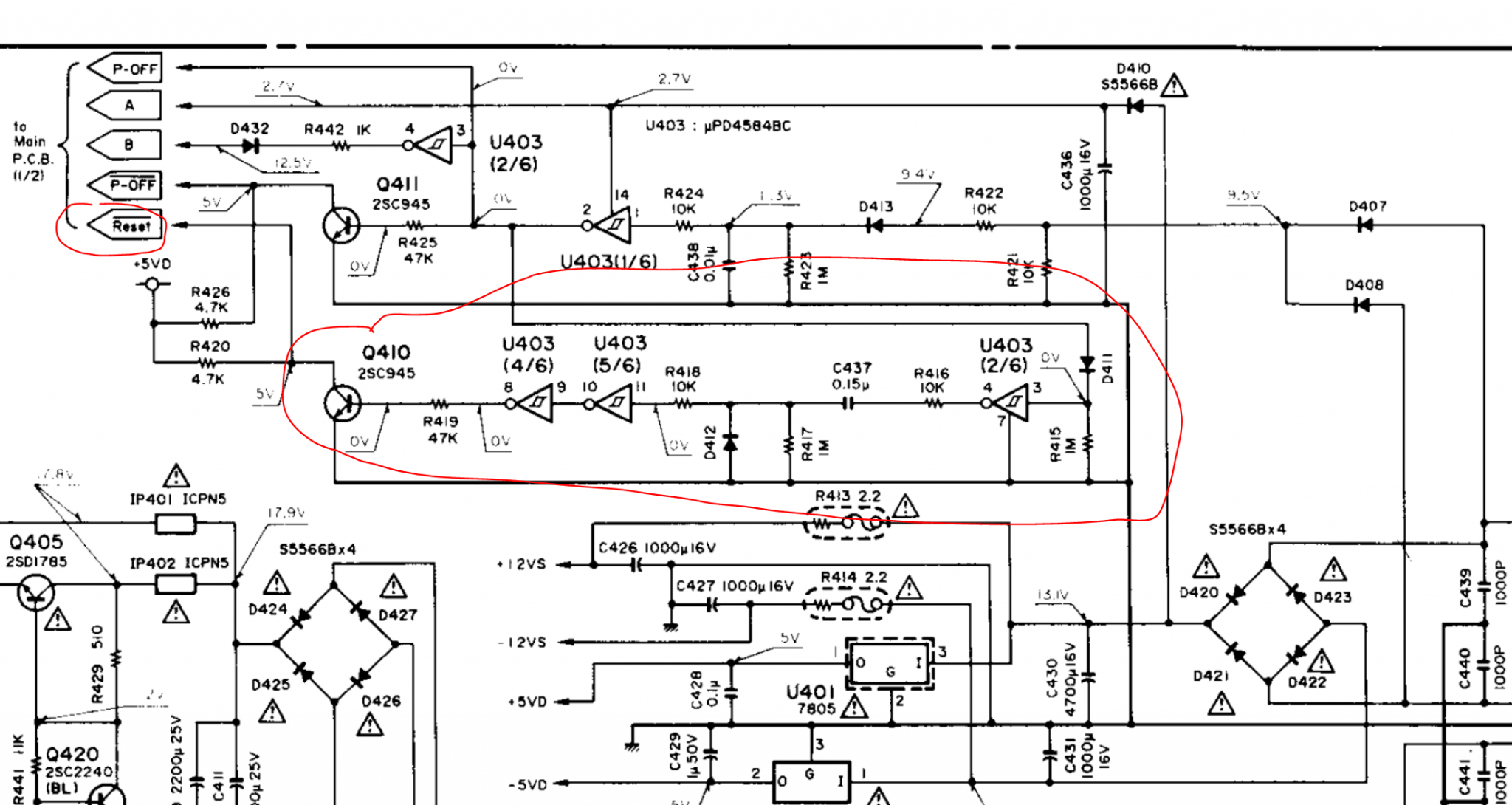

I can not find this main PCB (2/2)...?
Found it... make sure that U403 is working correctly... check R420... check Q410. By the way, how the heck is this the Main PCB..??
I'll have a look at it, thanks.

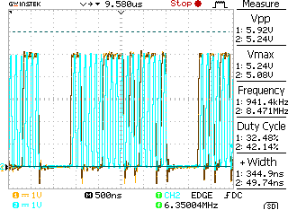

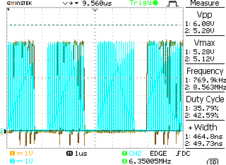

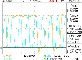

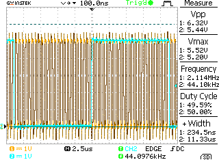

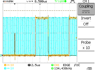

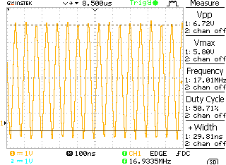

Alrighty, now that I've sorted out my scope issues (and gave it a firmware update), time to dump all the waveforms in the chain I've mentioned previously and try to source the replacement chip, as well as point out any obvious weirdness. How they say — It's the Final Rundown!

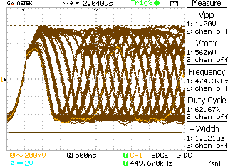

1. RF output after the amp, measured on the RF testpoint (CN-105:3) while playing a pressed CD
2. EFM output from the amp as seen from the U102, taken at R170, with a pressed CD

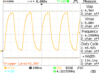

3. The PLL clock, CN-109:2 (~PLCK signal), must be 4.2MHz as per the manual

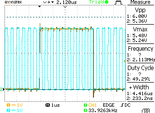

4. Bit clock IN U801:17 (2.?68MHz in the manual) and Word clock IN U801:16 (44.1kHz in the manual): 24 bits per word, isn't it too much for 16 bit CD? or am I reading it wrong?
5. Bit clock IN and Data In (U801:18) while playing a silence track on a CD-R, to hopefully highlight the problem. We can clearly see 10 clock cycles are in a logical 1, whereas silence should be 0? Or is it some weird different format?
6. Bit clock IN and Data In while playing a music track on a pressed CD
7. Oscillator out (U801:4) to the DSP, 6.9244MHz in the manual

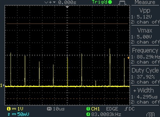

8. Data Left (U802:12) and Data Clock (U802:13) on the DAC while playing a silence track on a CD-R. This is data for the DAC so it clearly should be zeros (see datasheet) and yet!
9. Data Right (U802:16) and Data Clock (U802:13) on the DAC while playing a silence track on a CD-R
I was about to take some power voltages and the DAC outs as well but while I was at it the -5VD rail went, and the fuse seems intact so I'm puzzled. Either way without it the DAC is completely silent. Duh, will look into it later.
I have a feeling that otherwise these waveforms either makes it clear that either the U102 is toast or I'm totally lost 😛
P.S. It might be worthy to note that during the pauses between tracks there is (was) no noise from the DAC

The -5VD is back, I was looking at the wrong fuse — likely shorted something while measuring, the probes from GW Instek aren't the most convenient in the world.
Since I don't feel comfortable bridging yet another fuse I've ordered a 10-pack from a local vendor, and a U102 from some guy on ebay (albeit mine and the docs say it must be a 1167QZ while I couldn't find it anywhere online and thus ordered 1167Q, they seem to be the same package and chip in general).
Will post back once those are swapped.
So, today I received the 1167Q, and fitted it into the U102 spot.
What has changed:
I'll probe around more later this week, but it's weird... I don't think I could've killed the laser diode by putting the whole mech assembly into a plastic bag to keep it from dust while waiting for the chip?
It's as if some command or something isn't coming through.
What has changed:
- The 5MHz clock is on PCLK pins, so the insides of the chip are at least somewhat true to the label
- Otherwise the player won't even try to spin the disc... The laser seems to come on but no focusing takes place, no spindle action either.
- Then the player just gives up on reading the disc and ejects it
