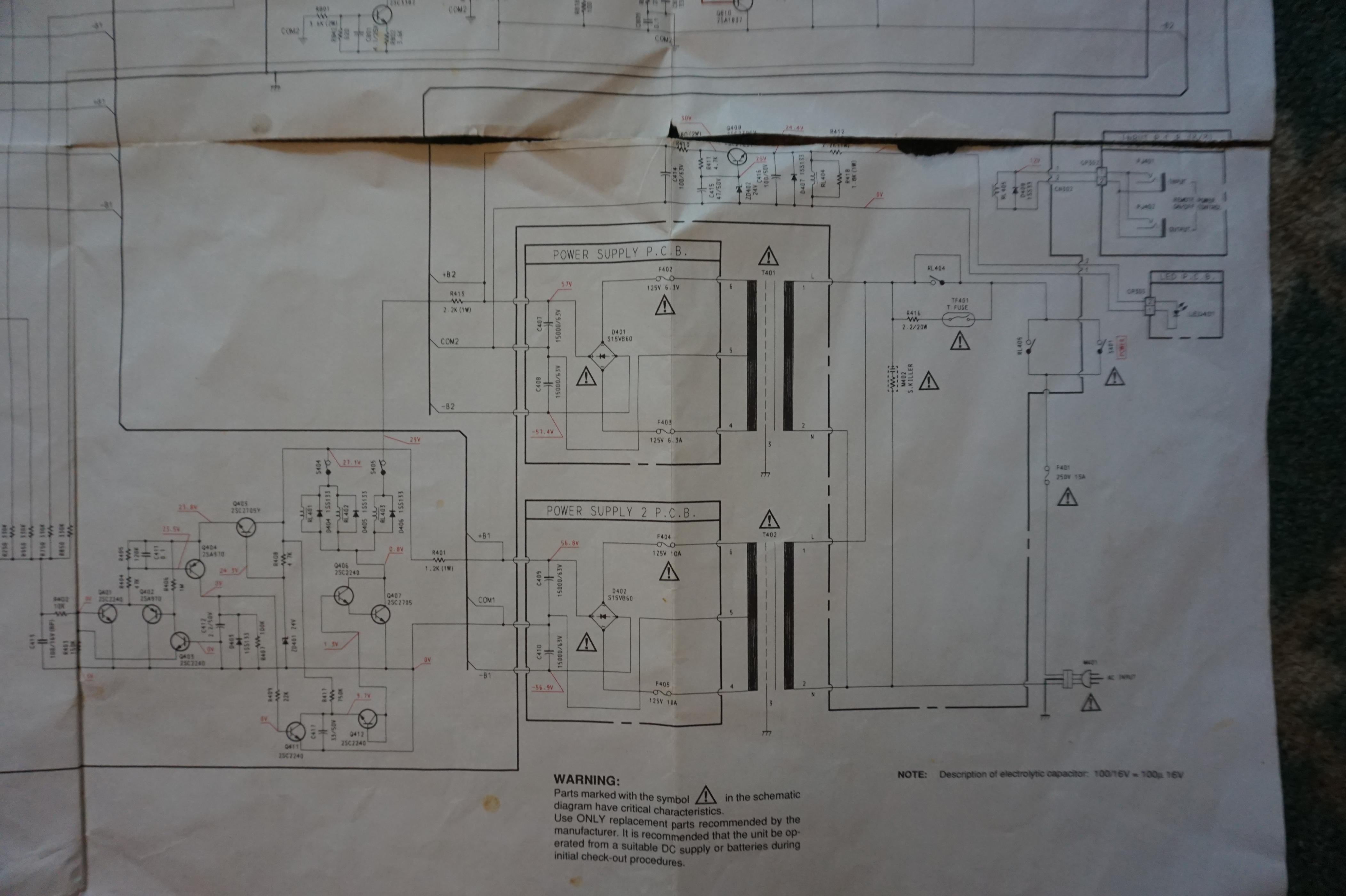

I ended up having to buy it in paper form. Schematics are huge fold out type. Way too big to scan. I could take pics of portions of it if you know what section problem is in.

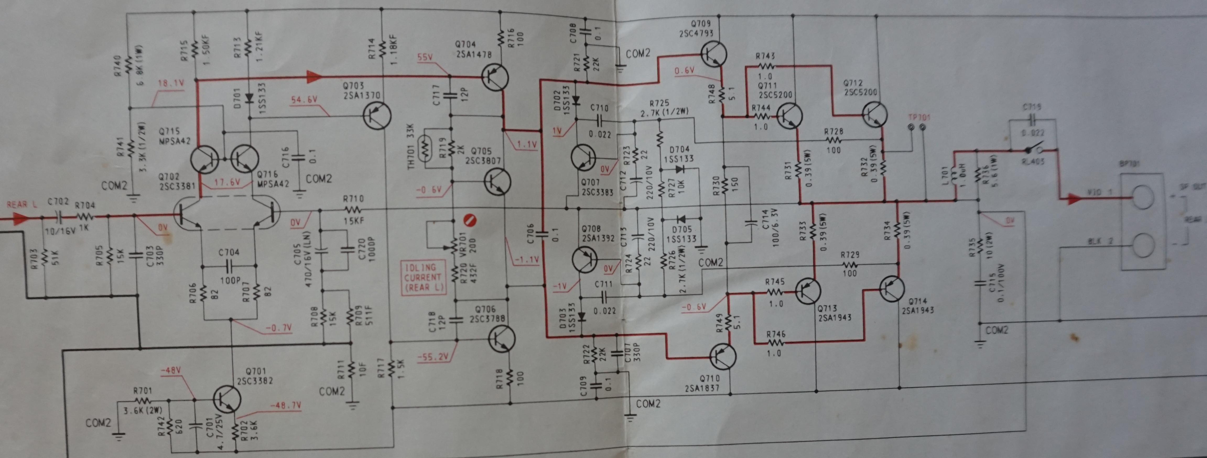

If you look at that schematic from post #4 there's a capacitor across the protection relay, which explains it - the protection or relay is not activating and only the capacitor is carrying the signal through. Doesn't explain why the protection is operating though.
Yes. I dont have a schematic. There is no power to the relays and the sine wave is passing through the cap.

GTO 127, Can you please post the relay circuit section, There is no power to the relays.

I just got a large scanner so thought Id upload parts of the schematic in pdf format so everyone would have the whole thing. I don't know how to stitch together so it will be in 4 pages,. Sorry about quality. This schematic is coming apart. I didnt realize it when making but you have to rotate each pages 3 times to get correct perspective. I had thought they were saved after I had previously rotated.-I'm not very good with this stuff.
- Nakamichi PA-1 Schematics
