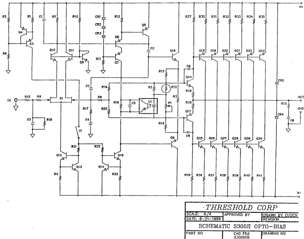

Guys, I need your help to modify / upgrade my amps.
I have two Nakamichi PA-1's, 5x100w channel power amps, primarily ment for HT duty. These are like 20 years old and based on Nak's "Harmonic Time Alignment technology" which is probably some derivative of STASIS as it was manufactured after their license term with Threshold.

Few options I have considered:
1 - Re-cap, may be swap some components with premiums. Live with the units until they are beyond repair..
2 - Since I also own a Nak TA-3 (75Wpc, STASIS) and it is the best amp i have ever heard, I thought why not use either Nak TA-4 / PA-5 / PA-7 design to make my own clones. Use the PSU +/- 60Vdc rails of the unit as is, use the schematics from service manuals to design my own PCBs and I will be good to go.
Well, I went through the schematics of all the Nak units, seems like they are too old and many components are not available. Trying to source components that are already obsolete or going into the complexity of figuring out replacements seems too much hassle.
Is it still possible to make 100W STASIS?
3 - Secondly, I went through the Peeter's "X100 back engineered" thread. It seems like a good replacement for papa's STASIS and biased slightly into Class-A like Nak PA-7, it should surpass PA-7.
Basically I want something primarily Class AB with some high-current capability with slight Class-A bias (if possible in the chassis space) primarily meant for HT multi-channel duty.
All DIY Pass designs I have come across focus on Class A. Perhaps because most people into DIY want something really clean sounding for stereo duty.
What do you guys recommend?
PS. Since Mr. Pass is very lenient with DIYers using his designs for personal, non-commercial use, I am hoping I can use one of his old Class AB designs..

I only parted with my TA-3A because I got a PA-5, amazing sound but they themselves are just threshold clones. I believe you could just clone a threshold 400a, s300 or ? I think zen mod has a thread about all the published pass circuits.

Start with the power supply. X100 need dual 25 - 30V supply's and will dissipate around 100W per channel. When I look at the foto in your thread I doubt if this amp can dissipate 500W ore more.
True, for X.100, either I will have to rewind the transformer secondaries or replace them with appropriate rating for 25-30Vdc rails. However, despite my best efforts, I have not been able to get my hands on properly working design so no point in going after the PSU mod yet.
Though I am a qualified engineer but no where near smart enough to design my own X.
Perhaps I should buy an X.150/250, dismantle it completely & reverse engineer? (I can use it for my mains and the X.100 clones for the remaining 10 channels)
