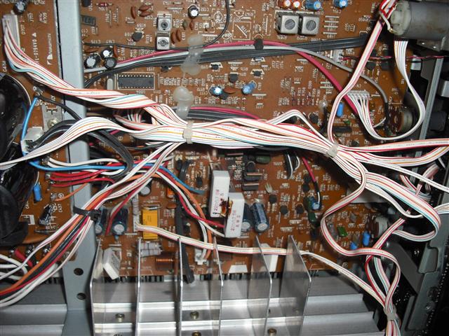

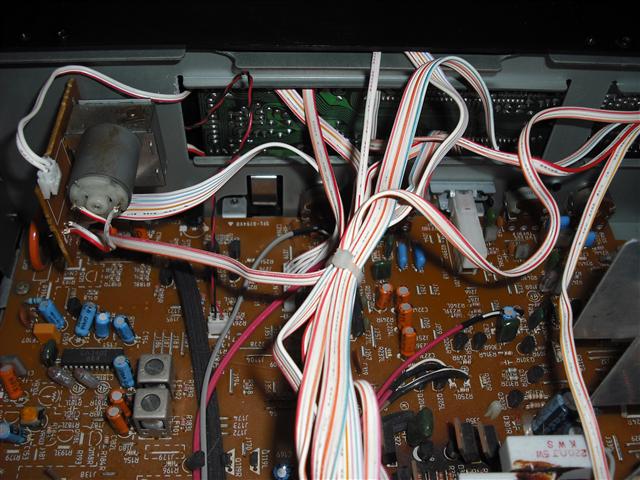

Opened the Nak to get a look-see. The sensor is a nightmare to get to, what with a ton of wires restricting access to the inside of the front panel. Would have to unplug them all to remove the front panel.
I could test voltages going from the PCB to the remote PCB but I do not have a schematic.
I was able to find online a Nak Receiver 2 Service Manual, not one for the Nak Receiver 1.
Does anyone have one?
Thanks in advance for any assistance!
