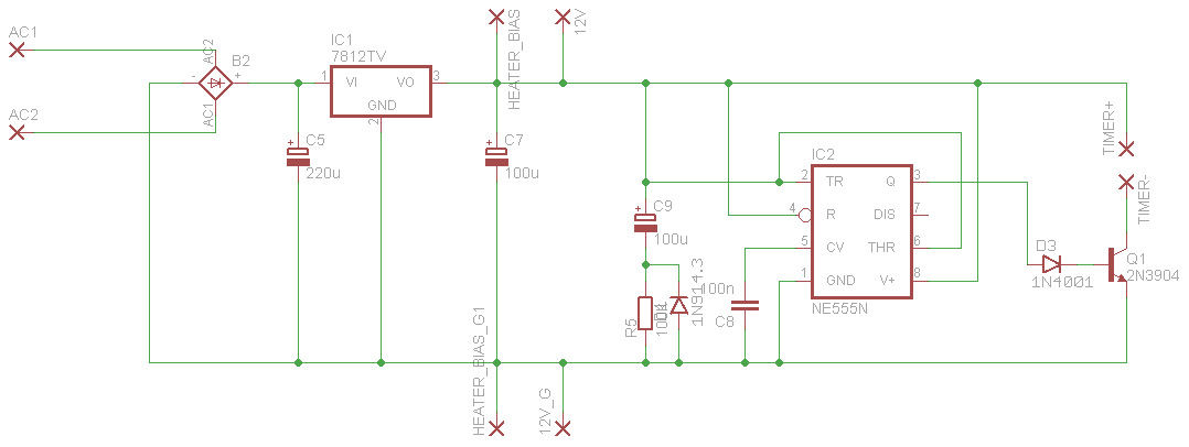

I have built a timed turn on for B+ on my EL84 SE amplifier. The regulator puts out voltage to the timer, but the timer refuses to switch the relay.😕
Could anybody confirm, that the below schematic should function at least in theory?
The relay, as well as the diode parallel to the coil is not shown on the schematic.

Your design contains a mistake. Your timer IC's pins 2 and 6 are connected to the positive supply; that is not correct.
You may not be aware that the free circuit simulator program LTSPICE includes a circuit model of the NE555. So you can simulate your 555 circuit in software and observe its behavior. An entire "cycle of learning" (re-design, re-simulate, re-analyze) can be performed in less than an hour.
If you want a delay longer than approx 1 second, I recommend using the CMOS version of the 555. Part number LMC-555 and its equivalents, has got much lower input leakage / input bias current, so it will not disrupt the very high impedances found in long-timeconstant circuits.
If you are comfortable with digital circuitry, you may want to investigate the CD4541 http://www.ti.com/lit/ds/symlink/cd4541b.pdf , also sold as the MC14541 http://www.onsemi.com/pub_link/Collateral/MC14541B-D.PDF . It will let you set the delay to seconds, minutes, or hours, without requiring high value, low leakage capacitors. Digital counters are simply excellent at providing accurate delays using inexpensive parts.

Thank you all! I will go back to simulation and the breadboard before making a new pcb.
I'll also check the digital solution, thanks!
