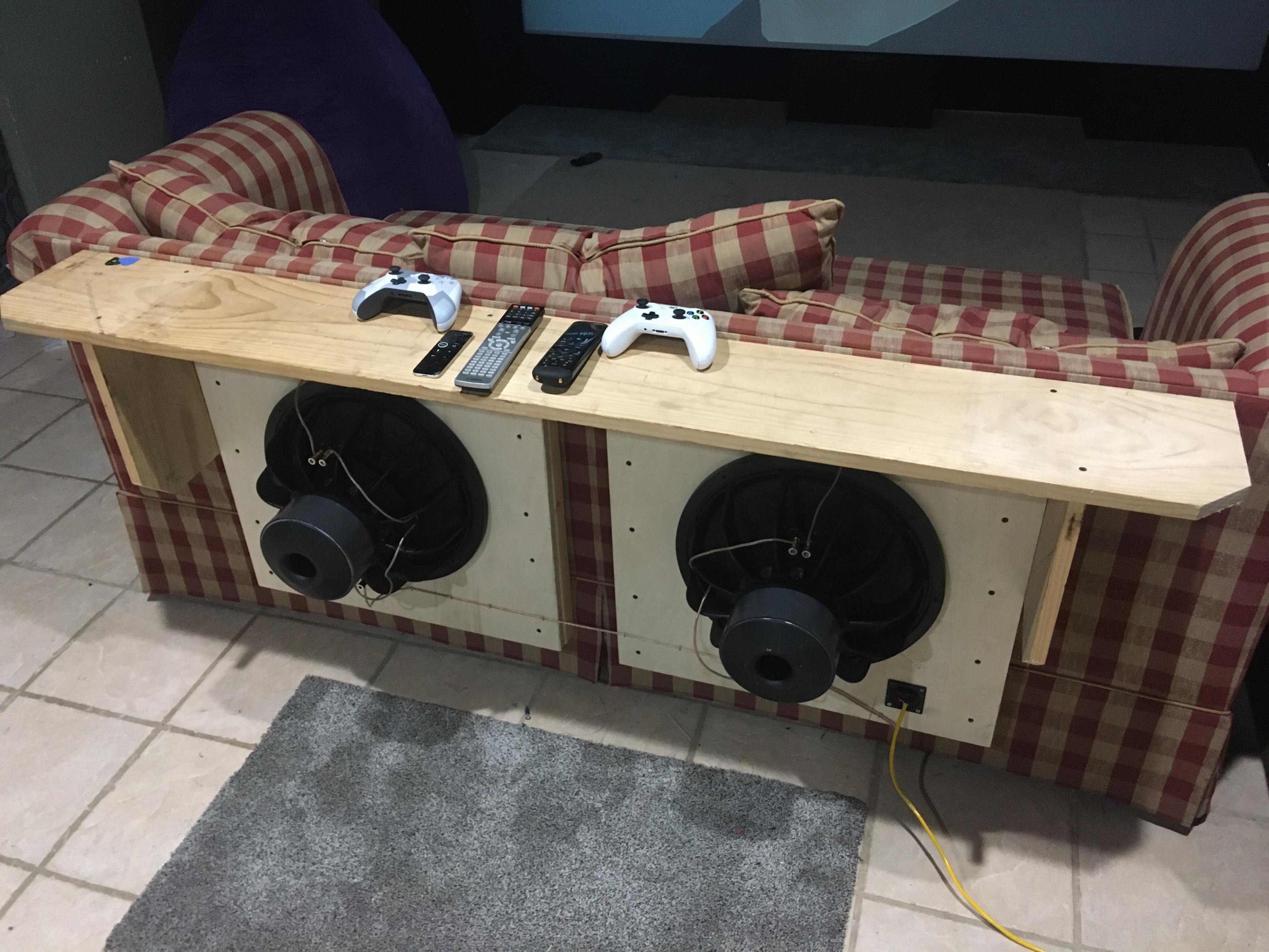

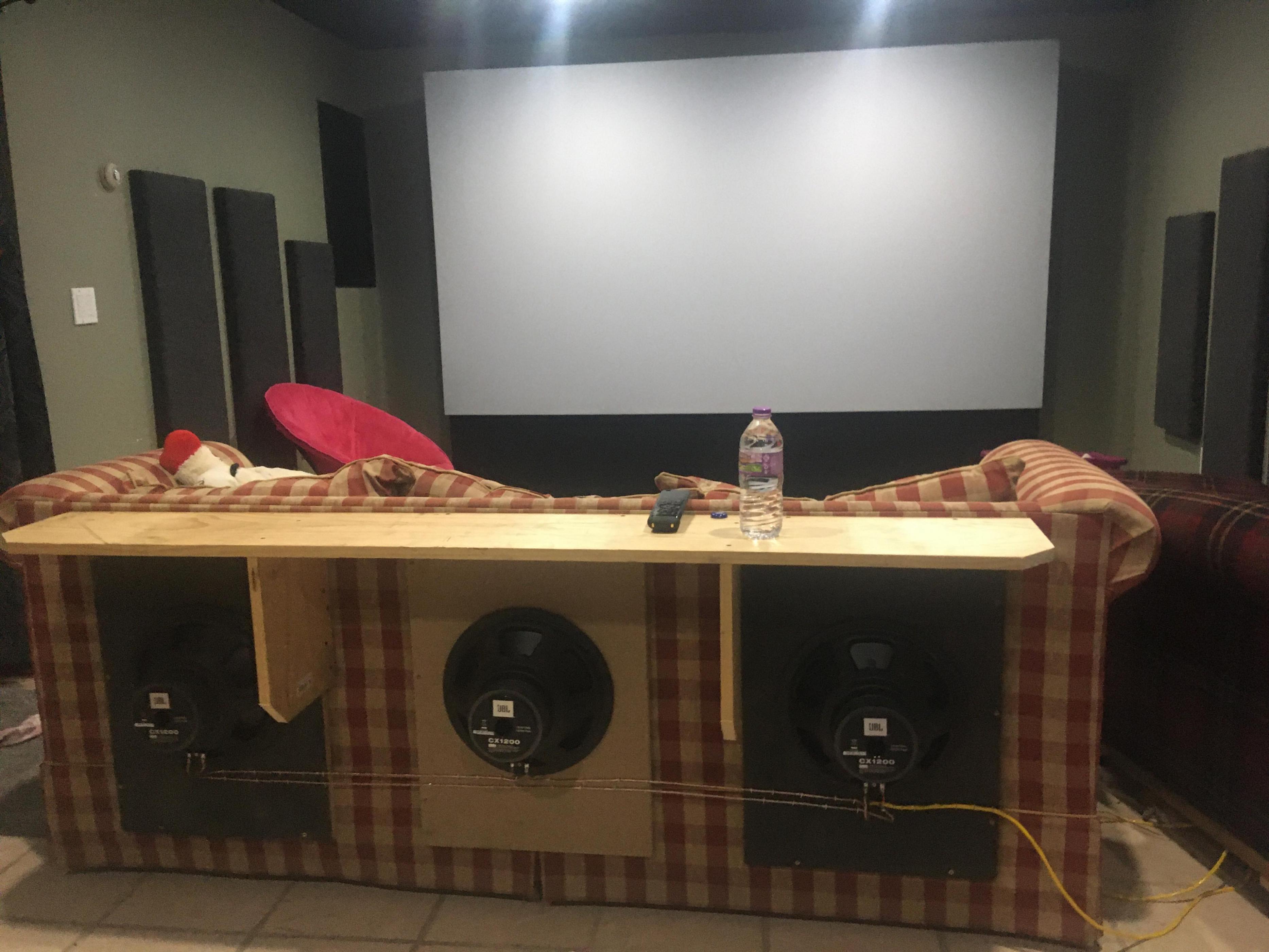

The point of open baffle is more feel rather than spl. Because I was curious I ran downstairs and put some EDM bass music on at -5db MV which is about 111db at my MLP and then turned my mains and subs off, I set my mic up and let it play a couple of songs and ran around the house doing stuff while my kids were getting ready for bed.
91db is all hey could get to... that’s a 20db reduction and nobody in my house even noticed. There was some bleed off on some notes but mostly because of the shaking, not necessarily the spl.
I said high excursion because of my need to hit the lower notes <20hz and it does it way better than the JBLs I had in there once before. If normal <80hz the jbls were fine but adding the high excursion drivers really took the 5-10hz stuff to the next level while still doing up to 80hz.

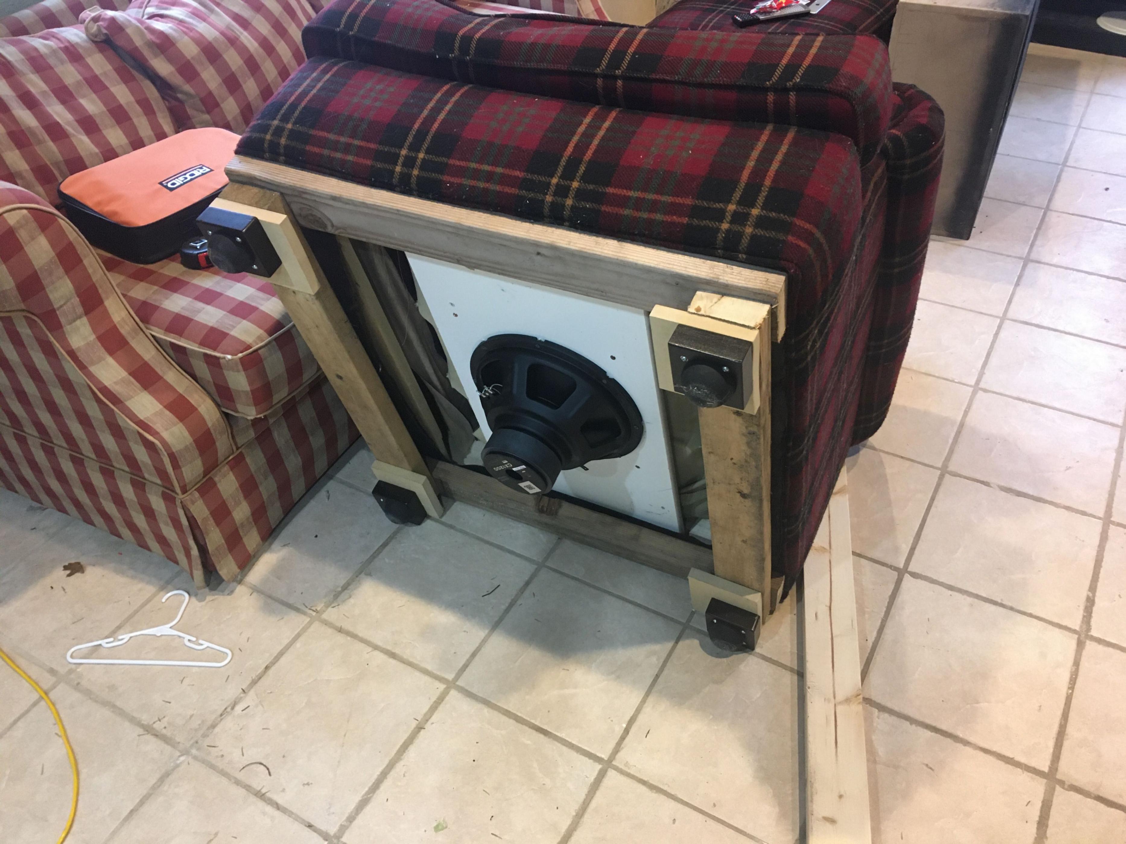

Putting them at head level is pointless imho, you need to feel not hear which means move what you sit on or it will just be wasted.
Yes, I’m on concrete and yes there is a lot of movement so isolators under the couch will help relieve the neighbors of bass being transmitted to the floor / walls.
If I had an apartment I would try this route before the BOSS platform while still having isolators under the couch feet. I think the forward / back motion would create less problems than the up / down UNLESS I was on the bottom floor concrete floor.
Here is version 1 of my couch and a single chair. FYI - I hated the driver firing straight into my butt.

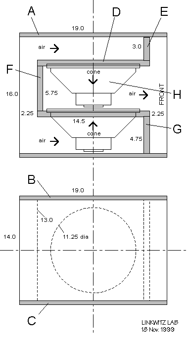

Neighbor friendly dipole sub
Opposed woofers cancel cabinet vibrations, so structural vibrations are not transferred to the floor.

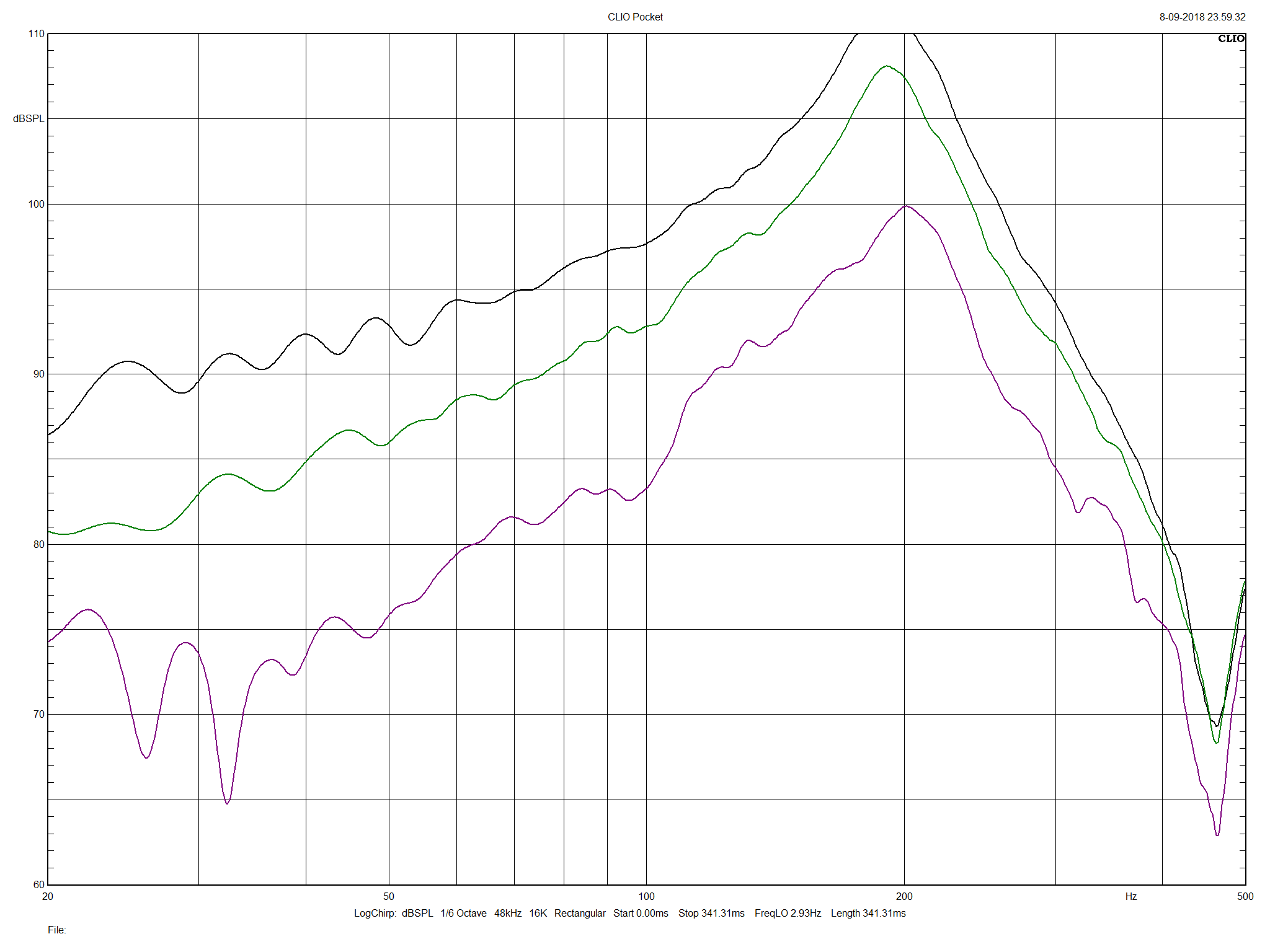

My experiments date back several years. I never measured the difference in leakage between a sealed box and a dipole at the same level. With hindsight I should have, but the difference was so dramatic I felt it was unnecessary. I was doing the experiments for my own interest and the conclusion I came to was nearfield OB bass was a no brainer for anyone who wants to control bass leakage in a medium or high density residential situation. My wife and I will be moving into a townhouse next year with an adjoining party wall to neighbours on both sides. The sound system I will build for that space will use near field bass allowing higher playback levels before annoying the neighbours. The dipole radiation pattern of these subwoofers allows a null to be pointed in the direction of the neighbours too for further reduction in leakage.
The dipole bass enclosure I used was a classic W style using a pair of Scan Speak 32W/4878T00 per box. It was similar in design and proportion to the classic Linkwitz design but adjusted for the larger drivers I used:
I have some outdoor measurements of this box that shows the advantage of the near field placement. The response flattens significantly as the listening position is reduced. This plot is 0.5M, 1M and 3M from the front of the box, outdoors, no eq:
At 0.5M there is only about 5dB of correction required in its 25-80Hz passband. My testing showed the location of the near field sub could be heard with a 100Hz crossover (24dB/Oct). No intermediate crossover points were tested.
