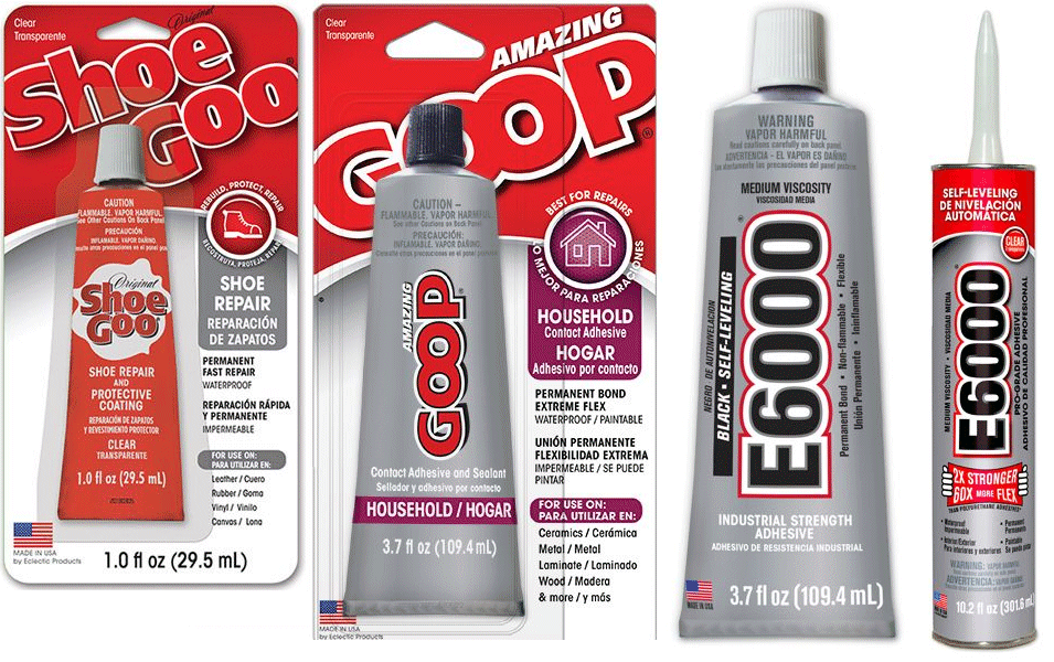

Pretty sure you are thinking of Goo, not Goop...
It's confusing! "Goop" is a natural health company.
Shoe Goo is a tame version of sneaker-factory glue.
Amazing Goop is real darn similar to Shoe Goo.
E6000 is another real-similar product from the same company.
They sell Goop targeted to plumbing, trim, crafts, automotive, and all-purpose. There is a Goop II Max and E6000 Plus. The 'Plus' claims low-odor, which means it is different from the classical Goops. There is Unicorn Spit in 14 colors (seems to be a water-based gel).
Eclectic Products | In The Home & On The Job Products
