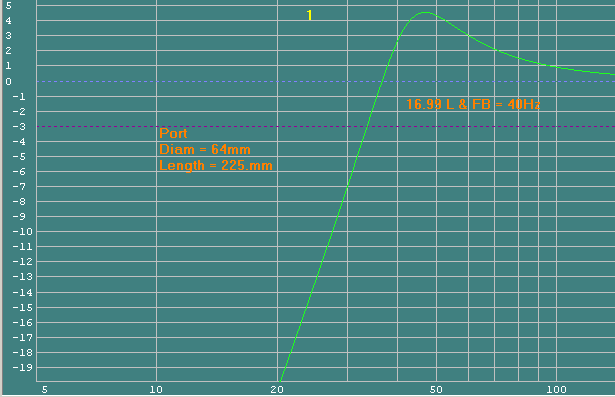

Hi, that box design isn't very good IMO ! See why in screenie 1. Unless of course you would be happy with that ?

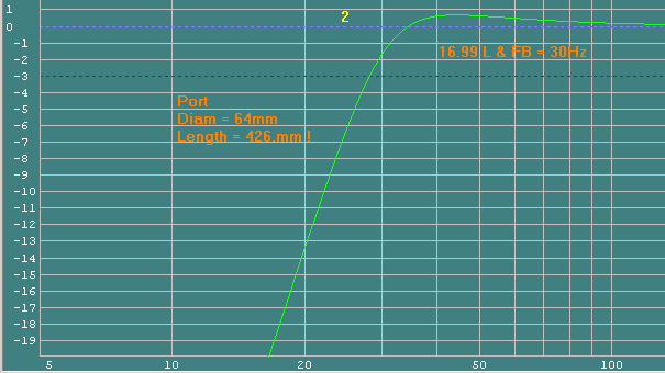

The same box tuned to 30Hz is in screenie 2. A lot more linear, BUT the port is too long to fit in the box as a straight tube ! You could though, make a rectangular port down one dimension & have a 90 degree bend which then goes along another & exits. You would need to calculate the extra room taken up by the increased port size, & add this to the internal box dimensions.
All the above is for ONE internal 16.99 L sized box. If you could allow a larger sized box, but still no higher than 9", then there are more options.
Those designs i made using WinISD & you might find this thread i did useful http://www.diyaudio.com/forums/subwoofers/148729-how-correctly-use-winisd.html Here's the link for the latest version http://www.linearteam.org/download/winisd-07x.exe

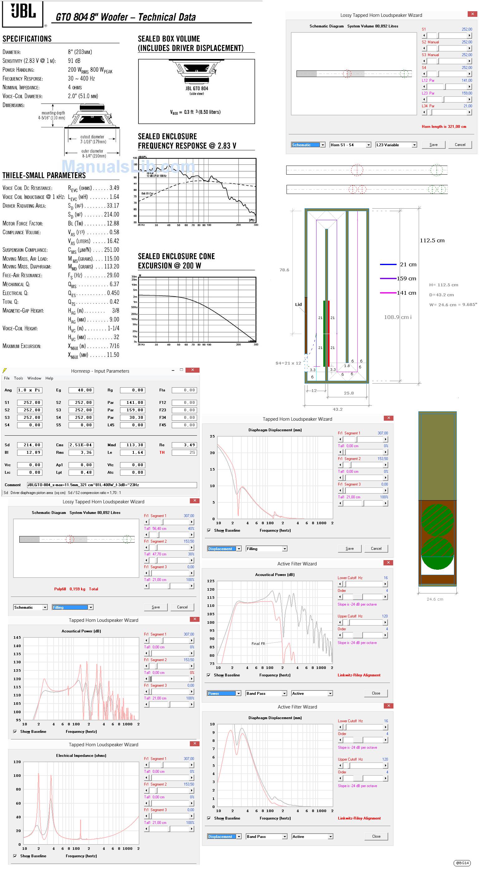

futuredj;3960768..I've picked out a sub I like said:Hi Tom,
Here is a Sub suggestion that should fit beneath your bed using 2 JBL_GTO-804 if you can raise the bed ~an inch:
