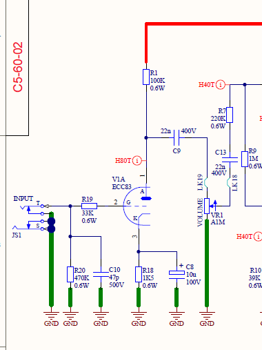

EDIT: please ignore the schematic below, apparently it "stayed" from an answer in a different thread.
Can´t erase it.
