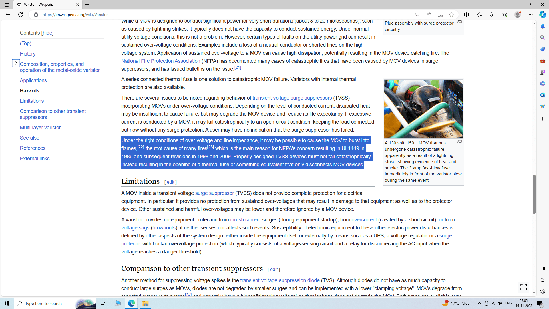

I guess below is the reason why the Varistor caught fire.
The only Relay on the right side of the power conditioner is for time delay.
Correction on the Varistor, its resistance decreases with increase in voltage.

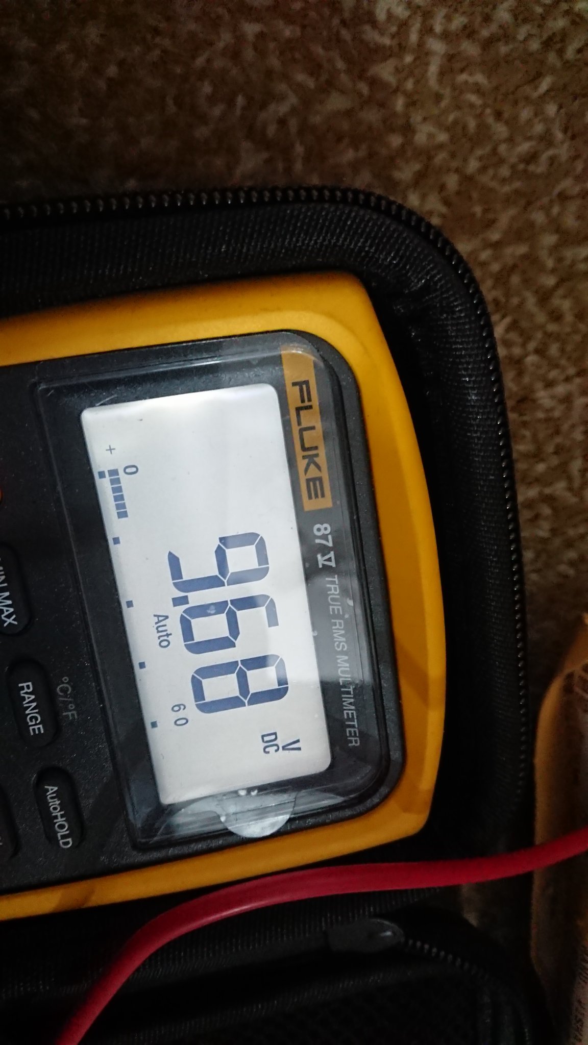

So got the parts and replaced everything, the relay which I replaced is not getting energized from the input received from controller board. I have measured the dc voltage around 9.5. Also I have tested relay using external 9v source and relay triggers around 9v with 22mA dc current.
Any idea why relay wouldn't energized at 9.68 v dc from controller board.
Replacing part "875B-1AH-F-C 12V DC (17A 250VAC, 20A 125VAC)" with below part
https://www.mouser.in/ProductDetail/523-AWHSH112DM00G
